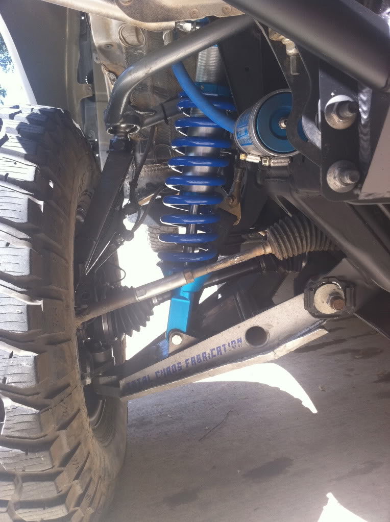

    It seems that almost everytime I go offroading my alignment gets thrown out.:mad:
    Is it simply because I am driving to fast over stuff or can something actually need replacing so that my alignment will be harder to tweak?
    Does anyone else have this happen to them?

    Well last night I went 25 to 30 mph over some small rocks and so tiny little jumps that just make me do a front wheelie or a rear wheelie type of thing. I know that it isn't front the little wheelies I think it is from the small rocks and stuff.

    well I just got suspension and UCA so I was out testing it:D
    But I dont have A/T tires yet, those get put on this coming weak, would the tires maybe help with keeping it aligned?

    thanks man. the tab gussets help a lot, i have them on my truck... but installing them is a pain

    even with the gusset tabs you'll still be able to throw out your alignment when you hit the dirt. it's pretty much unavoidable if your doing the fast stuff
    and don't get too crazy either... otherwise you'll have much bigger problems to worry about than alignment. bent frame, motor mounts, steering rack, bent spindles

    I have the gussets they strengthen the tabs so they do not fold over, but they dont make the cams freeze and not change alignment. You could tack weld the tabs but if your springs sag or you bend something or adjust preload your alignment will be off and you will have to grind the cam free.
