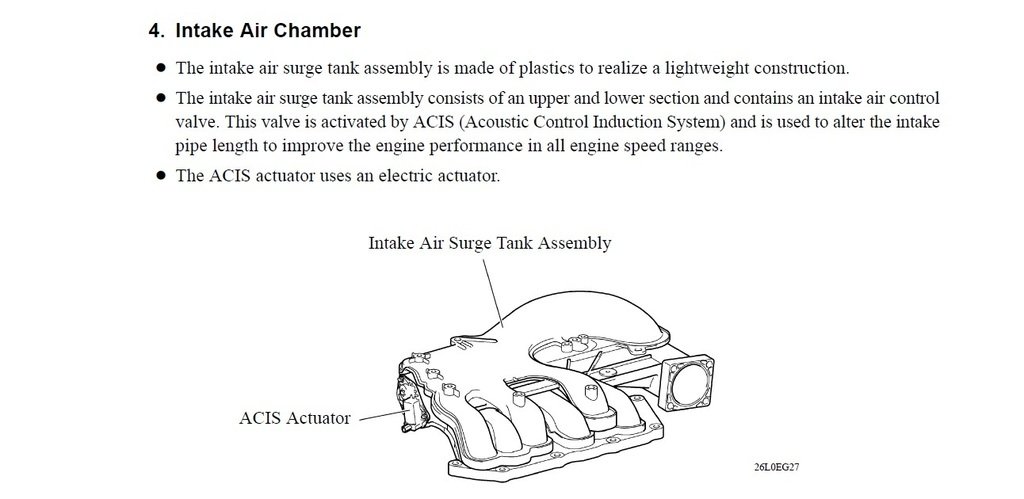

    2016 TRD OFFROAD DCSB MGM
    ACIS kicking in?

    7,858
    NW Arkansas
