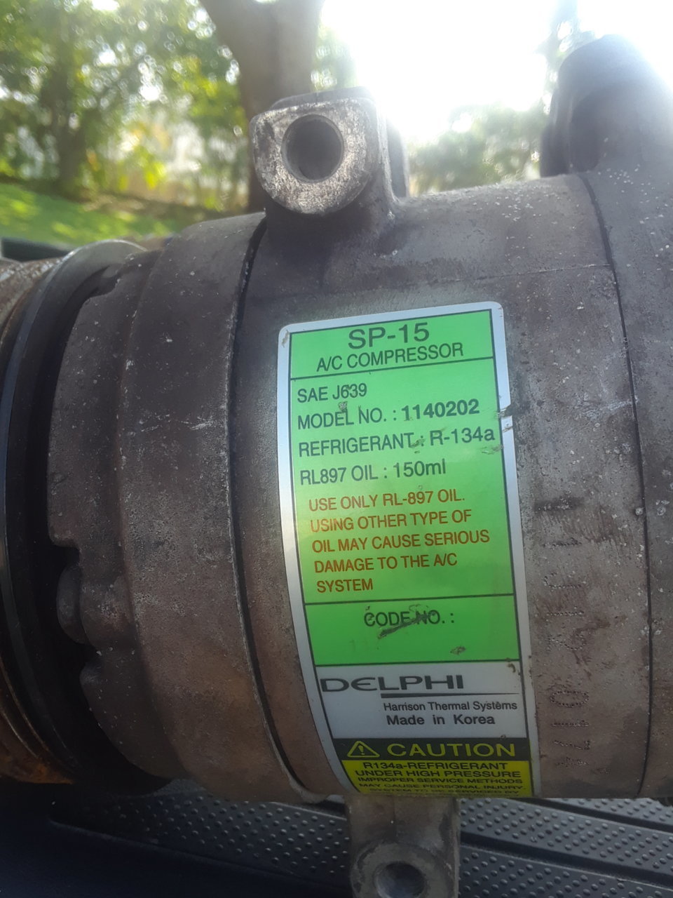

    2012 Blue Tacoma PreRunner Access Cab 4 cylinder

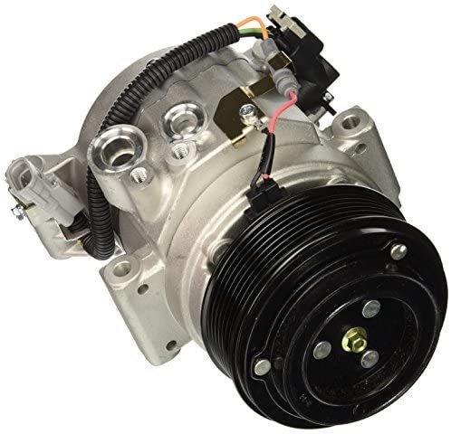

    replaced by
    Denso # 471-9196

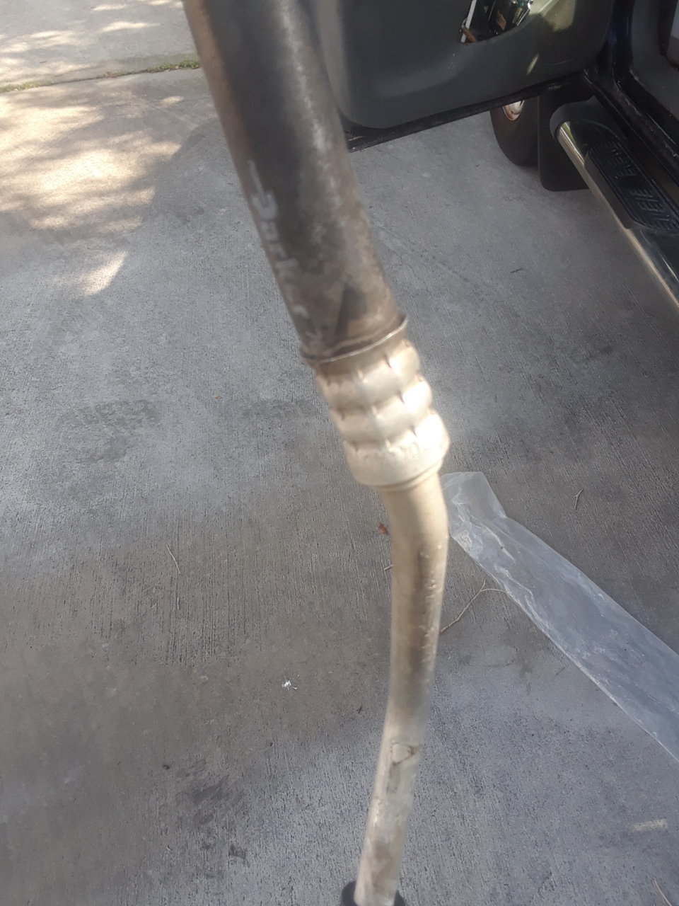

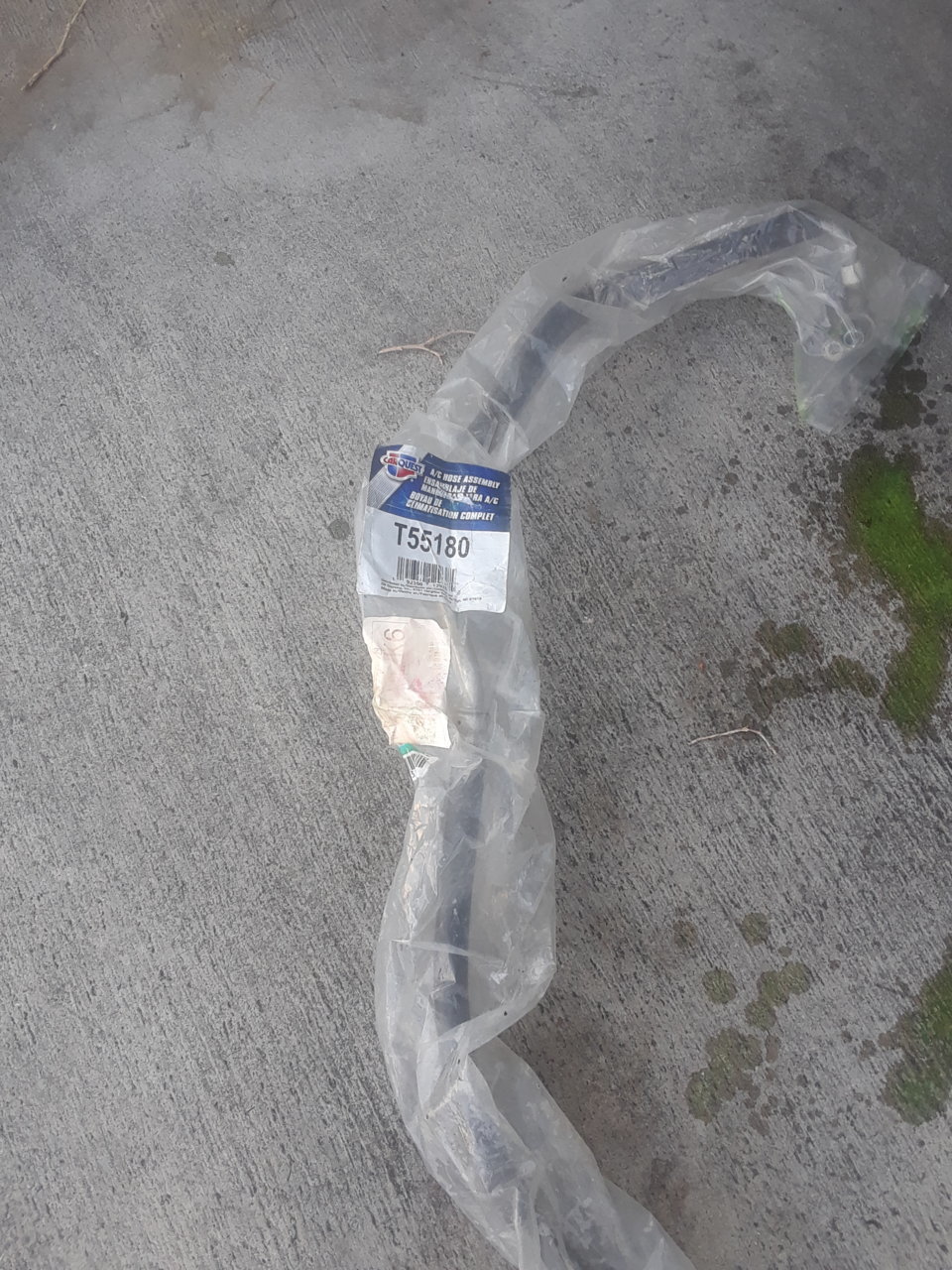

    replaced by
    Hilights:
    Presence of ML-897 oil in compressor: None -Rotor turns smoothly.
    Meager measurable amount found in hose.

    The replacements perform and operate exactly like OEM. No better. No worse.
    A/C is very cold and has been perfectly stable over the course of 10 days.

    ML-897 oil compatibility with what is installed in the new compressor PAG 46, was strangely confirmed on a Chevy website. I cannot afford to worry needlessly anymore. My days are numbered and Bree and her truck are cool.
