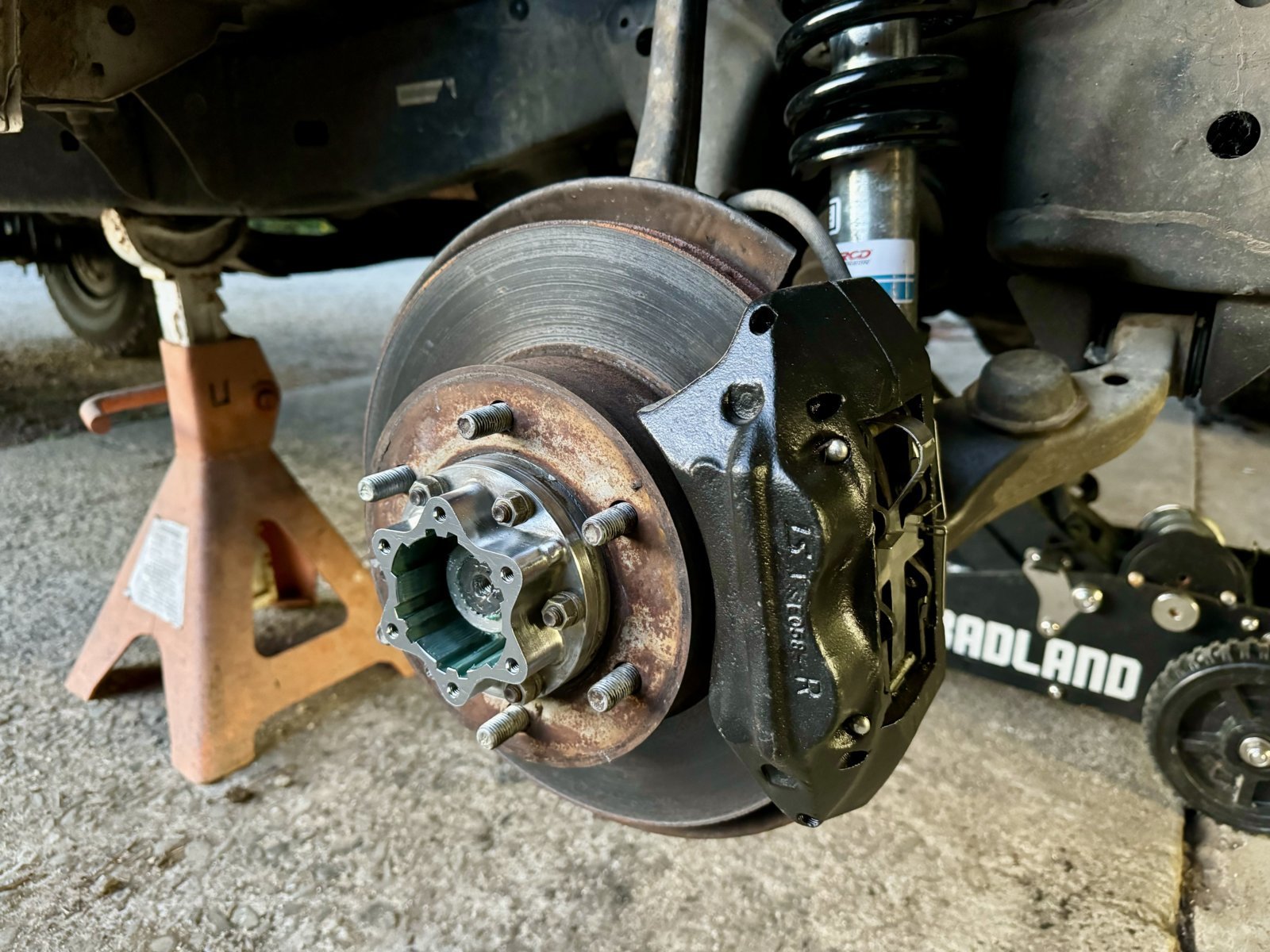

    This was happening to me, turned out my front calipers were heavily dragging. Seems to be a common issue with older 1st gens.
    I had no squeaks, smells nothing. I only found it when I went to rotate the tires, I could barely spin the wheels the brakes were so tight.
    OEM calipers were a little too expensive, so I slapped on some premium NAPA calipers.

    I vote dragging brakes. Front, rear or parking.

    if it is dragging front brakes in particular are there any other symptoms that would be noticeable, prevalent, out of the ordinary?
    perhaps noticeable uneven pad wear on one side vs the other side?
