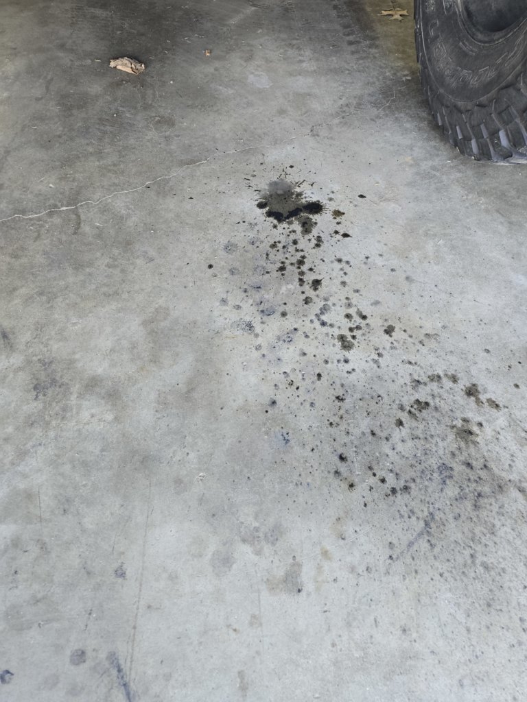

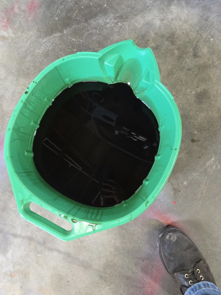

    Got the flush done. I put a 1/4 can in each cylinder and let sit for 8 hrs. Then put a 1/4 can in each and let sit for 2 days. Also cleaned the throttle body while I was in there. Pics of junk that came out of the exhaust, and the oil that came out. The oil had maybe 200 miles on it, so obviously the Berrymans cleaned something out. The oil reeked of Berrymans. I'll check back in with results after I put some miles on it.

  3. Mar 21, 2025 at 11:38 AM
    #23
    Barsoom
    Barsoom Well-Known Member
    Jun 17, 2021
    #368854
    1,918
    NW GA OTP
    MMO gives you nice minty scent.
    That's some nasty oil. I would be tempted to change the oil again after a couple hundred miles.

  5. Mar 21, 2025 at 12:06 PM
    #25
    ridefreak
    ridefreak Well-Known Member
    Oct 27, 2018
    #270747
    1,248
    NM
    2006 DCSB TRD
    minor tweaks
    If that's only 200mi oil the flush pulled allot of crap out with it :thumbsup:
    Let us now if you feel a power improvement around 1600~2200 rpm. When I flushed mine it also came out looking like ink @ 300mi. There was a definite performance improvement in the rpm range I mentioned, all I can attribute it to is that the VVT works better (as it once did) now. My theory is the degradation was slow and over many miles so it wasn't really noticeable, truck just felt a little tired until I did the flush. I didn't have an oil consumption problem though

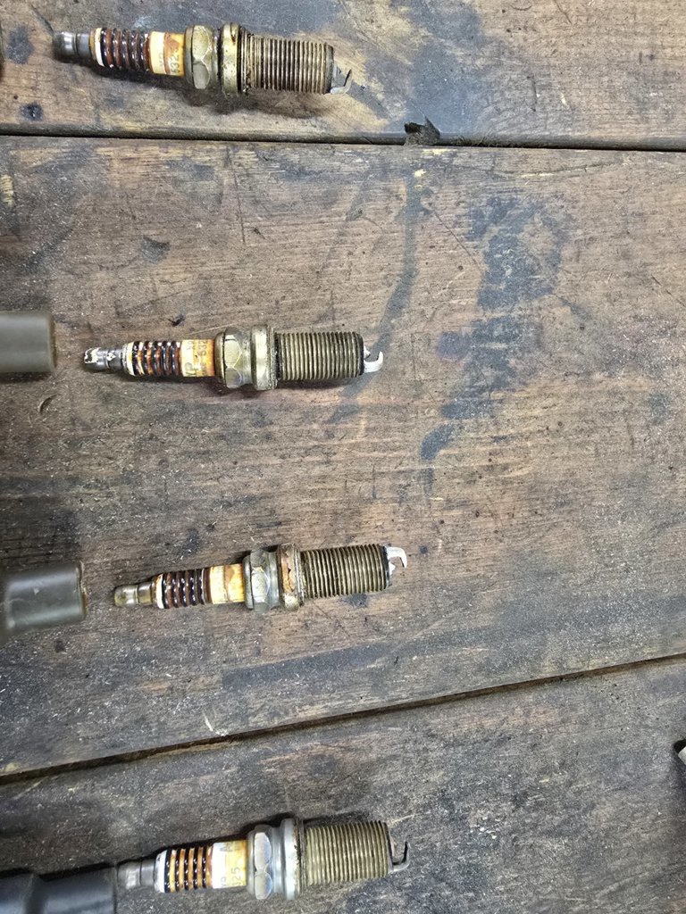

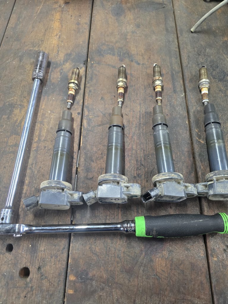

  13. Mar 26, 2025 at 8:09 AM
    #33
    TartanEagle
    TartanEagle Well-Known Member
    Feb 1, 2017
    #209287
    1,471
    '17 ACLB 4x4 MT
    Plugs #2 & #3 do not look normal. (I thought TOO HOT, but the chart below doesn't back me up.)
    Let us know how the new plugs look after a fair trial period.

  18. Mar 26, 2025 at 4:12 PM
    #38
    gtrotter07
    gtrotter07 [OP] Well-Known Member
    Jul 19, 2019
    #299768
    407
    2007 Tacoma reg cab 4x4 on 37's; 2021 TRD Offroad, 6 speed
    37's,lockers, bumpers, bobbed etc.
    I suspect #2 and #3 were the cylinders burning oil. I'll eventually pull them to check again, but that will awhile due to work and lack of driving it a ton anymore.
