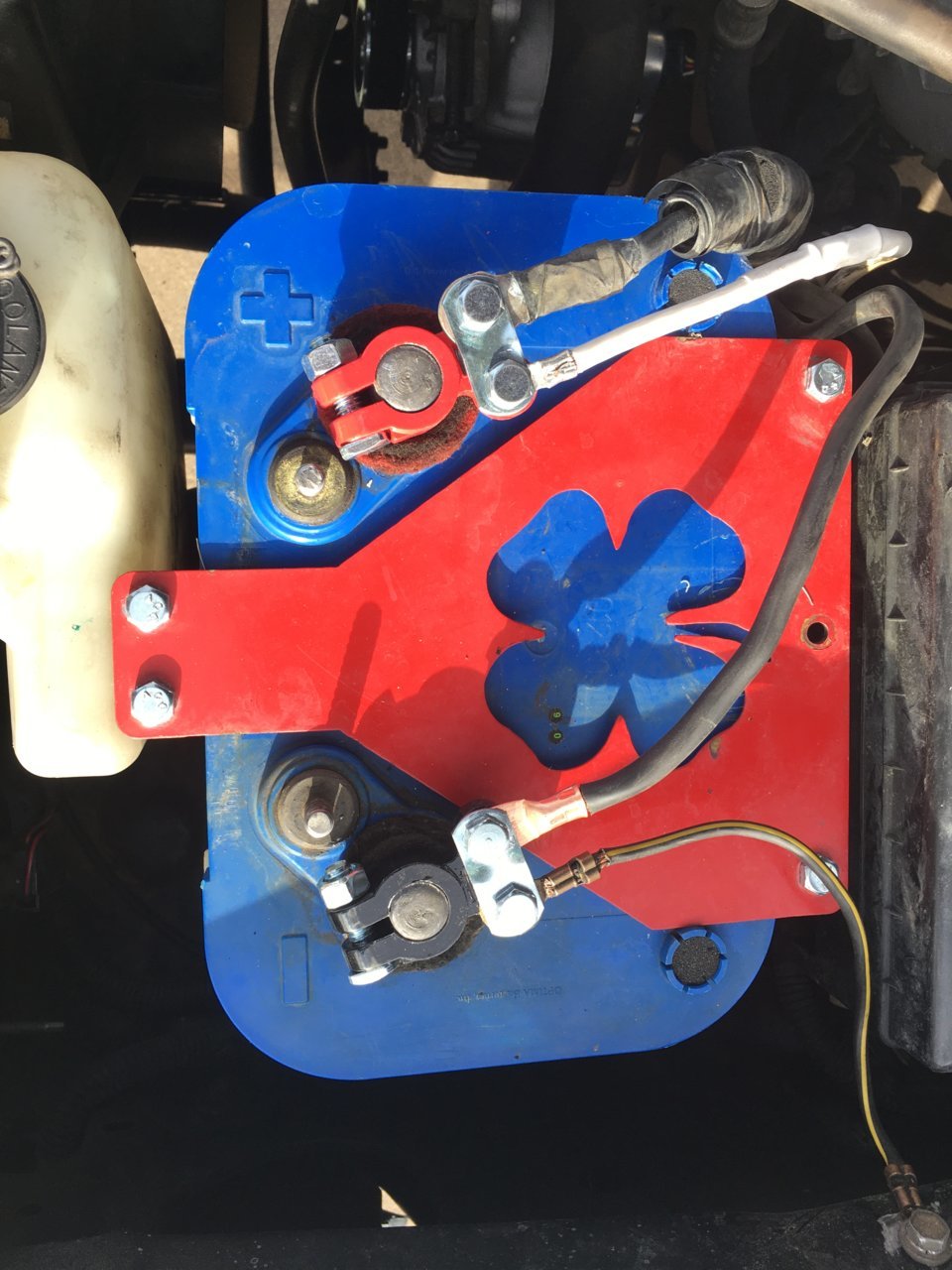

    Many Lexus interior parts, LED dash lights, a flatbed Is coming soon.
    I recently redid my battery terminal connections as well die to the dame exact problem you described. Now my volt meter is showing 14.3 charging and 12.7 with everything off.
