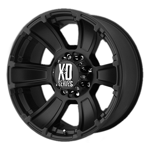

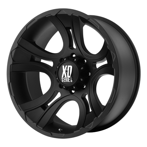

    Sorry to bring up an older thread, but this seems to be the topic I'm looking for. I have seen a million topics on here about Backspace and offset. Seen illustrations, on how it works and read some opinions. From what I can gather, 4.5bs and -12os seems to be the common "Ideal" setting. (I still don't completely understand this stuff, no matter how much I read about it)
    I'm having my 5100s @.85, and Eibach front coils put on in the near future, so I will hopefully have the lift necessary for the 285/70/17 Duratrack's I want to run. After seeing most all of the Rims in person, I finally have my choices down to the two below. (Also, I will not be doing any off roading, this is mainly a street truck)
    I already accept I will have to trim the plastic inside the wheel well, maybe the inner fender and hit or miss on removing the mud-flaps. I really don't want to start chopping cab mounts, or rub on my stock UCAs.
    As you can see, the Crank's have a 5bs and 0os. I assume this will stick out more then the Revolvers with the 4.5bs, -12os. Or I'm backwards, and it will stick out less.. Regardless, will these work? Am I going to rub on my UCAs and need to chop the $hit out of cab mounts, ect? The Revolvers have the "Ideal" setting according to what I can understand, but I really do like the style of the Crank's.
    When talking to the "Expert" at the wheel shop today, the only good advice he could give me was one set would stick out farther then the other... Needless to say, I wasn't impressed by his knowledge or help.
    Crank's:
    Size - 17" x 9"
    Bolt Pattern - 6X5.5
    Offset in mm - 0
    Backspacing in inches - 5.00

    Revolver's:
    Size - 17" x 9"
    Offset in mm - -12
    Backspacing in inches - 4.53
    Centerbore in mm - 106.25

    The 4.5" backspacing is the key number. Don't pay attention to offset, because for rims with a given backspacing, the offset will change depending on the rim width.
    4.5" backspacing will stick out MORE than 5.0" backspacing. I've seen folks fit 33's on 5.0" backspacing, it just requires more trimming and cutting than with 4.5" backspacing.
