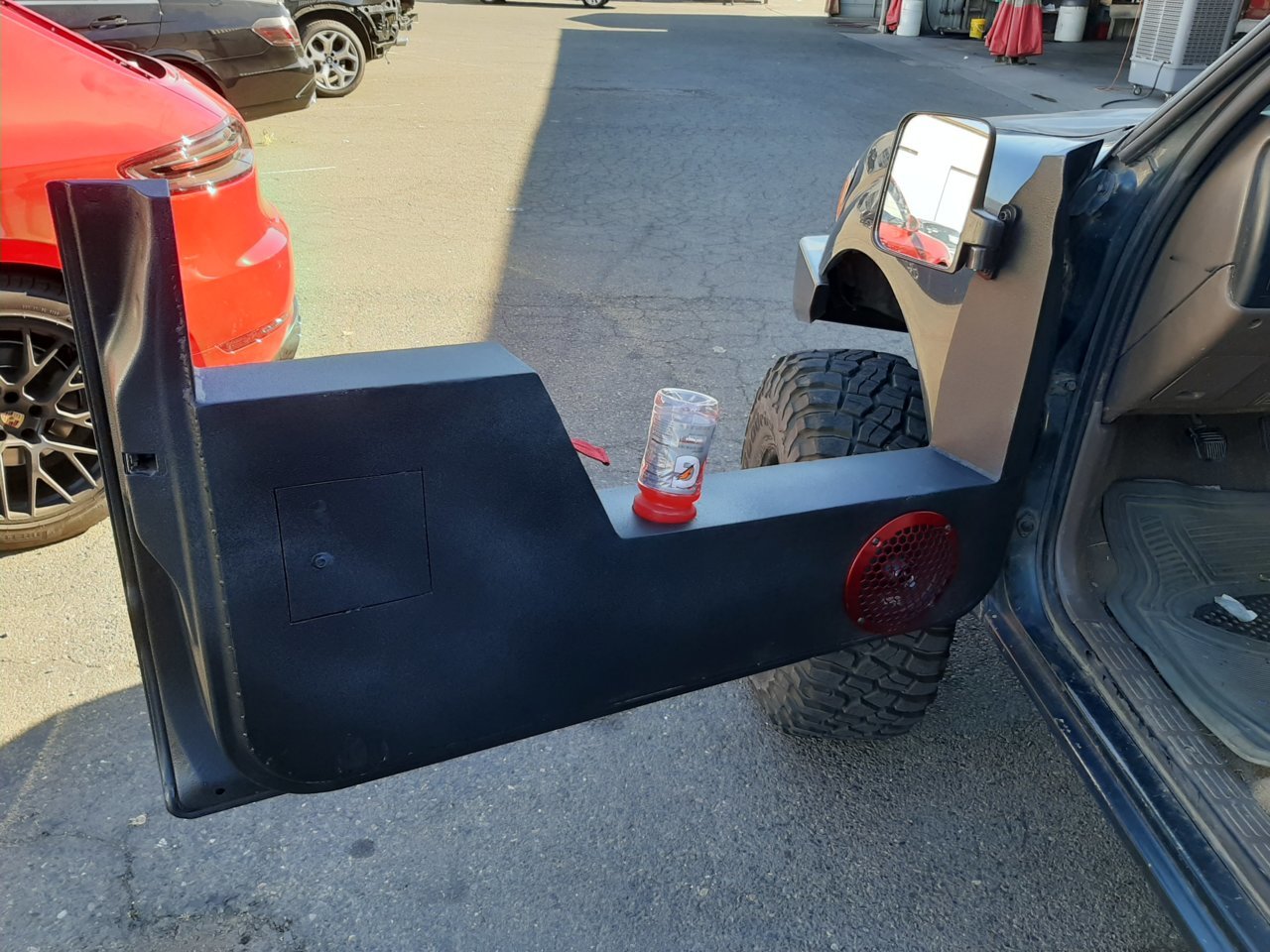

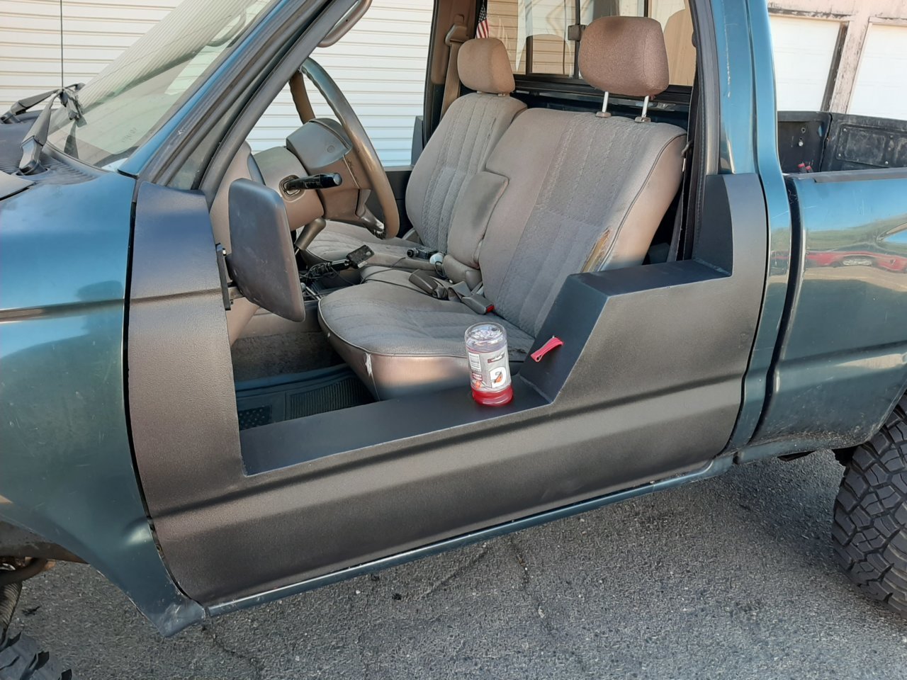

    I just installed a set of DS18 pro zt6. I crossed them at 120hz, and I'm feeding them a ton of power. They are super loud. This definitely isnt an SQ build, so dont expect them to be smooth like a silk dome component.
    The amp you use is just as important as the speaker if you want to be loud. I'm using an old school RF punch 500.2 for the doors.

    howcome crossed soo high? mines at 80

    They are seeing alot of power and I cant smell if they start to stink. There is alot of wind in my truck, I got them a little stinky crossed at 80, but luckily it was while stopped. If it was in a regular door I'd probably cross them at 80 or 100.

    almost looks stock :D

    Thanks, that's what I was going for. I was going to paint them body color but I ran out of time. Raptor liner was super fast.

    That's so bad ass :headbang:
    Don't let that Musk guy steal anymore designs for his webtruck

    :eek::eek::eek::eek::eek::eek::eek::eek: dayum! That is amazing! Crazy, creative... Very nice.:thumbsup:
