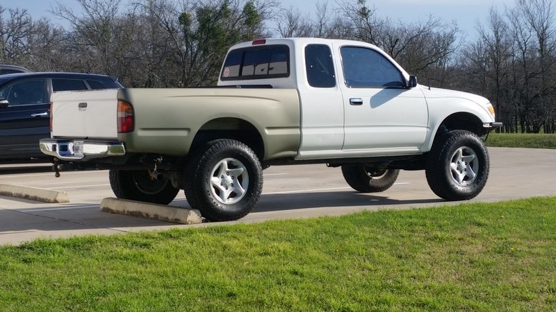

    I just started my project with Avery Dennison midnight sand matte metallic. I highly recommend it for exterior stuff, its very forgiving. The 3m Di-noc is thicker and difficult to place around bends and angles I tried some small interior pieces with it and they will need to be redone because they loom so shitty. The heat gun is your friend with the Di-noc. The Avery stuff for the exterior was 538$ shipped with a bunch of tools and sealers and such. It is tedious and time consuming, but worthwhile.tmp_11786-20170217_091359101526331.jpg
