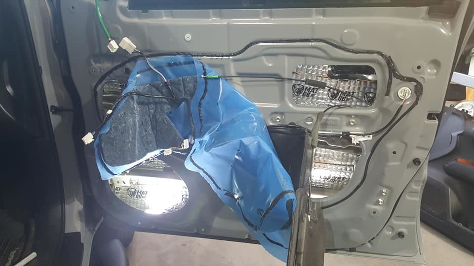

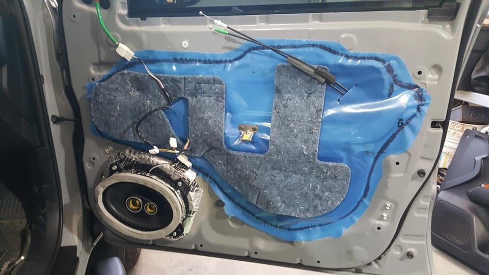

    176791471_3887555914633039_1904248432718_00265a56739ff311abb4f3efadd9d1df69b132e0.jpg 177575990_3887556081299689_3066617623739_db9ccbfa8a1bc039913af29f50456249ced19c47.jpg Hello all, Kicker Subaru Tweeters with Kicker CSC693 & CSC67 speakers. Mat 66 deadening all four doors. Definitely was worth $400, my "13 hours" installing everything. I did remove the Negative Battery Cable to play it safe as others have instructed as 1st step in this upgrade for tweeters. Carefully removing everything, reinstalling without any scratching-breaking loosing-damaging parts. Watching 10 or more DIY YouTube videos showing what's needed was key!
    I used the Mat 66 between door & speaker mount, the speaker mount & speaker, then weather stripping around speaker. Pro installer tips to direct sound, reduce any rattles. Rear speaker brackets must be trimmed for 6 3/4" round speaker's to properly fit, easily completed using pliers.
    We are grateful to everyone here on Tacoma World Forum for helping with this upgrade, and Crutchfield for providing great customer service and 2 day free shipping and all support needed. My advisor was Dwayne, he assisted me with purchase and guaranteed me full refund if not satisfied. CSC 693 $98.96, CSC67 $71.96, plug n play wiring & speaker mounts included at no additional charge. Tweeters ordered from Ebay, $98 + Tax. Mat 66 & roller $80 from Craigslist. Dos Equis $20.
    If anyone has questions or has comments I'm willing to assist anyway I can. That's what is great about this group of members! I am no way suggesting what I accomplished is safe or best practice, it worked for me given the guidance I received by this fine group of members and YouTube video's. Proceed at your own risk as these vehicle are expensive and many things can go wrong if not completed correctly. I just happen to enjoy the satisfaction of DIY projects, allowing me to do it 5X if needed and learning valuable lessons along the way. Nothing can hide if you do it yourself, if problems arise then you can easily make repairs and learn from mistakes.
