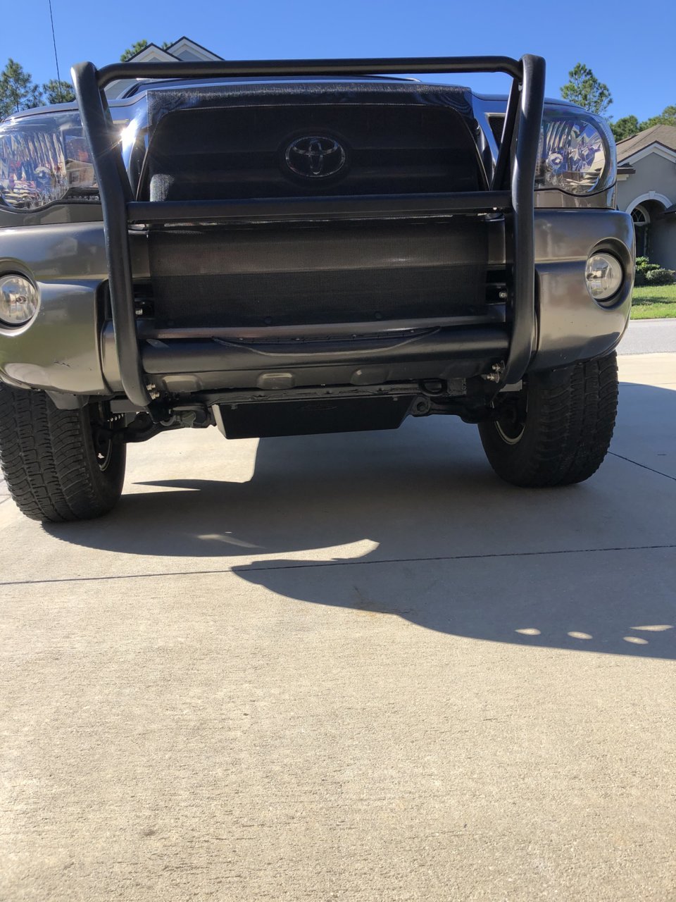

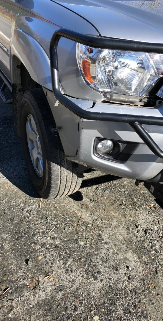

    I have a ranch hand grille gaurd that I’ve been pleased with but the only time it’s hit a deer it didn’t really help much since the deer hit the bumper 329A38DD-39F3-4290-A8DD-32D89BB2716D.jpg

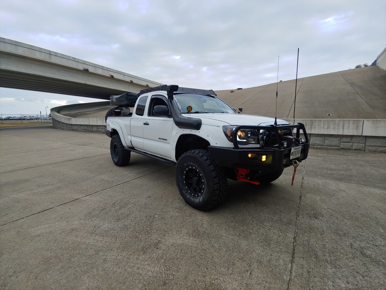

    Old Man Emu 886 coil springs, about 660 lb. rating. In combination with their Nitrocharger series shocks, it gives between 2.5-3 inches of lift and is designed to support the weight of the ARB deluxe front bumper and a Warn winch.
    My truck:

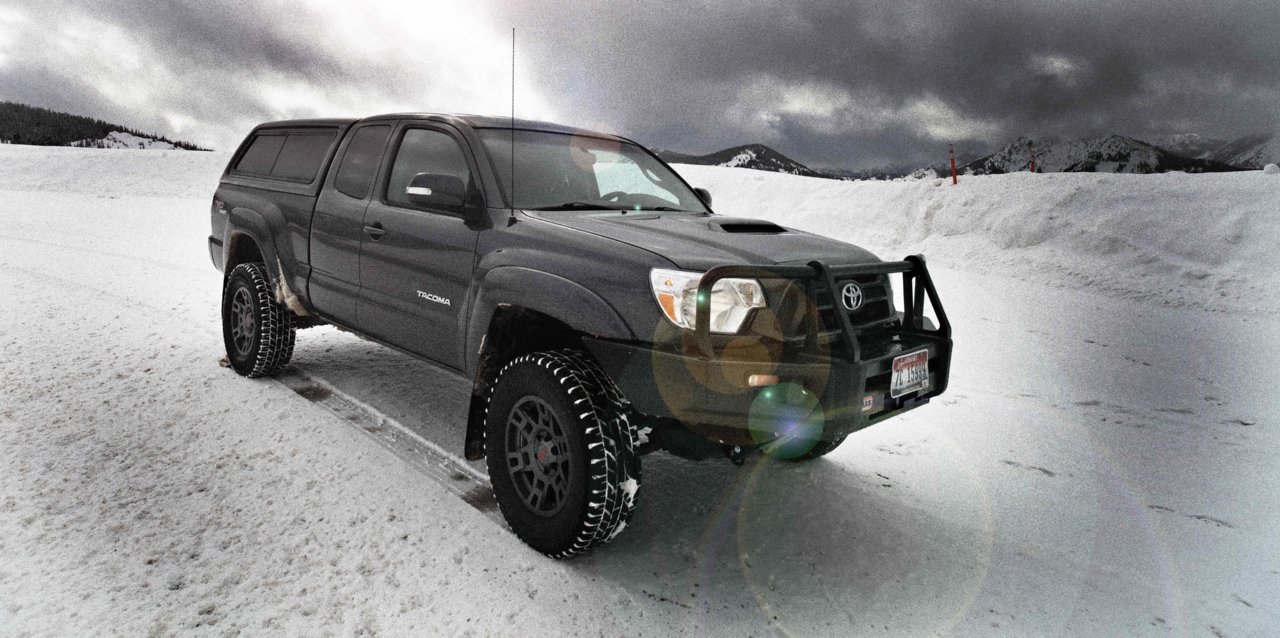

    Had new kit installed yesterday: ARB bumper, OME 886 coils, ARB Dakar rear leafs, Bilsteins 5100 front & rear. I asked the guys at garage to set the front Bilsteins at lowest setting, with the rear of the truck higher or level with the front.
    Net lift after the install is easily 2". Perfect & it drives great. Damped, not harsh. Thanks all here for your input and suggestions. Also - new rims. :) Galena Pass, Rt 75 bet Smiley Creek & Stanley Idaho.

    ^Looks great! I hope to be getting one of those bumpers from a friend, just need find time to make the drive 600mi to pick it up. And, I suppose I'll be needing to adjust my suspension for the added weight as well.
    What size tires are those? They look really good and not super wide like you normally see.

    Hey, they are Yokohama Geolander A/T 265 70 R 17 - OEM size.
    My local dealer in Challis ID said the are his favorite & they are really, really good.
    Not too loud on highway, stiff 10 ply, good off road, great wear. Very good in snow. WAY better (stiffer + better road feel) than the tires on this truck originally.

    The weight of the ARB really gives a good solid feel to the front. Nothing odd, just steady. I can't give an opinion vs 700 lb coils, but I found the 886 /ARB combo to be pretty awesome. course this is on a 100 mi. HWY drive.
    fwiw.
