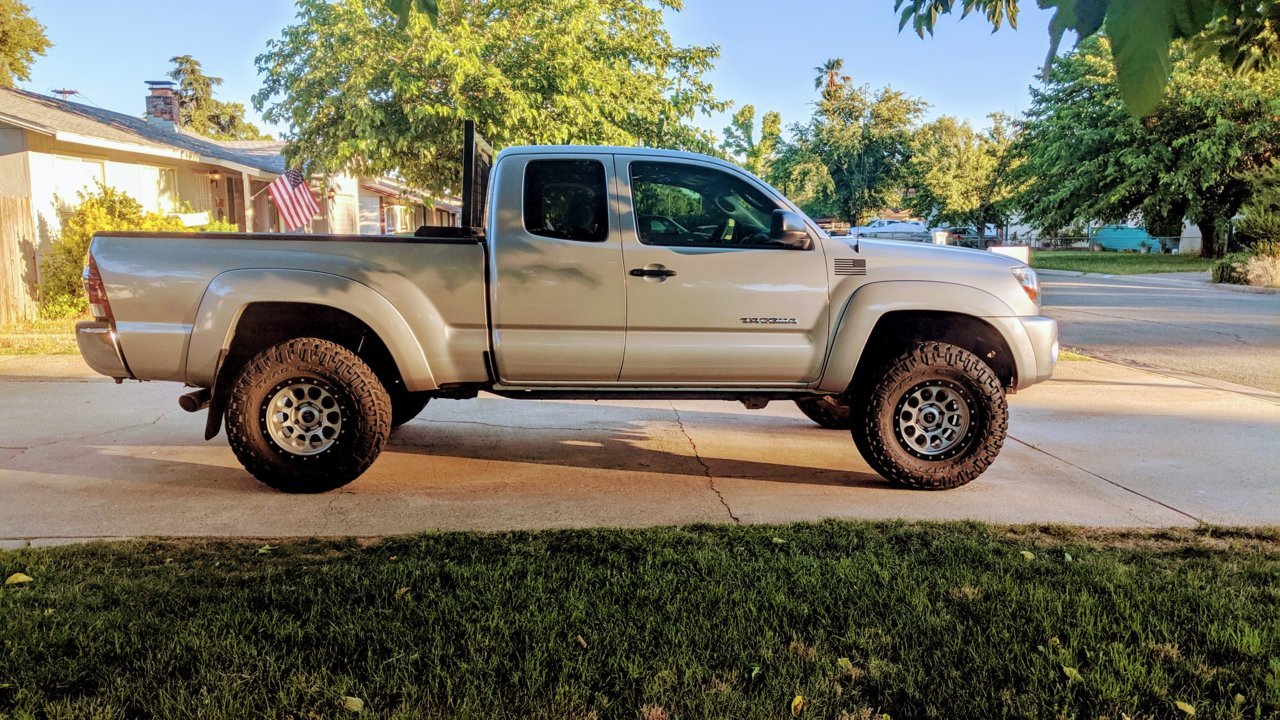

    Bilstein 5100s with your stock springs at the top setting in front, 5100s with a rear 1" block or an add-a-leaf in the rear should keep you under $600. Here's mine when I had the front set at the top setting with a 1 inch rear block on 32" tires. Installed myself to save money.IMG_20190607_193427.jpg

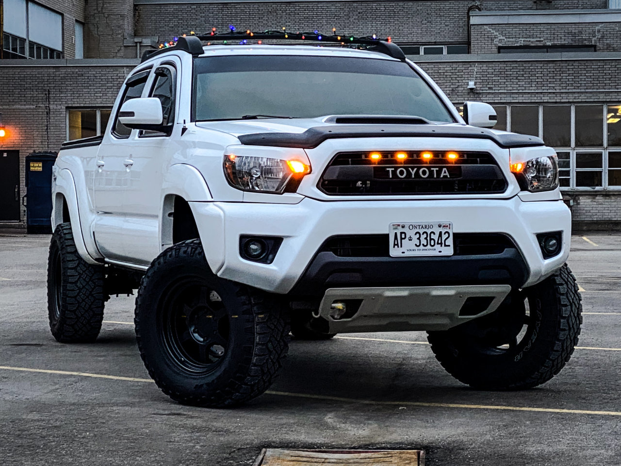

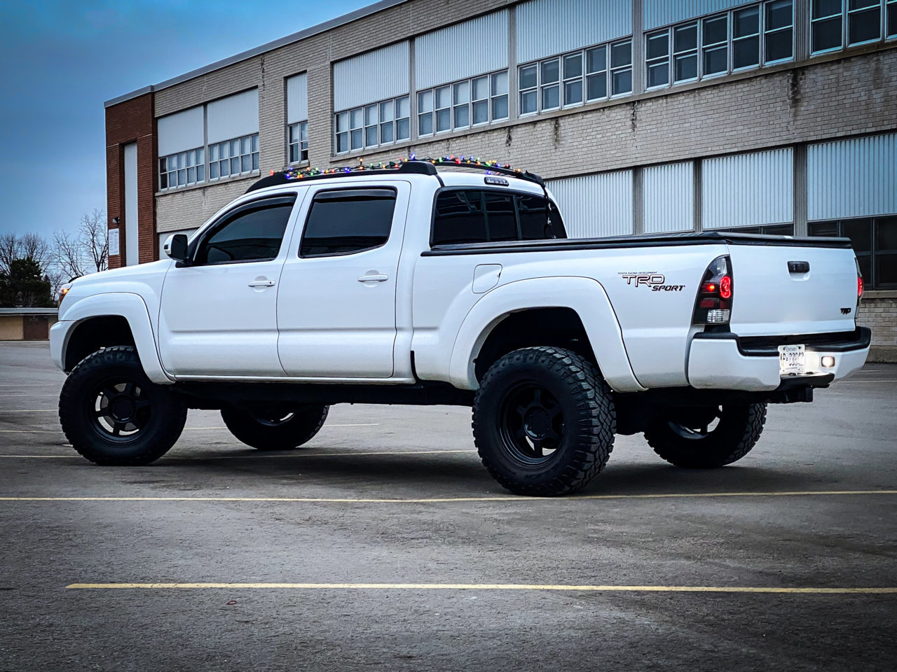

    - BILSTEIN front/rear, front set at 2.5”
    - 1/4” TOYTEC spacer on driver side
    - 1.5” TOYTEC AAL on TSB springs along with a 1” lift block
    - 1” TOYTEC body lift
    5B80CF45-F870-43C4-8910-0D758E3CDB10.jpg F345257C-3E22-4ABE-9B37-32E4E9791AEB.jpg
