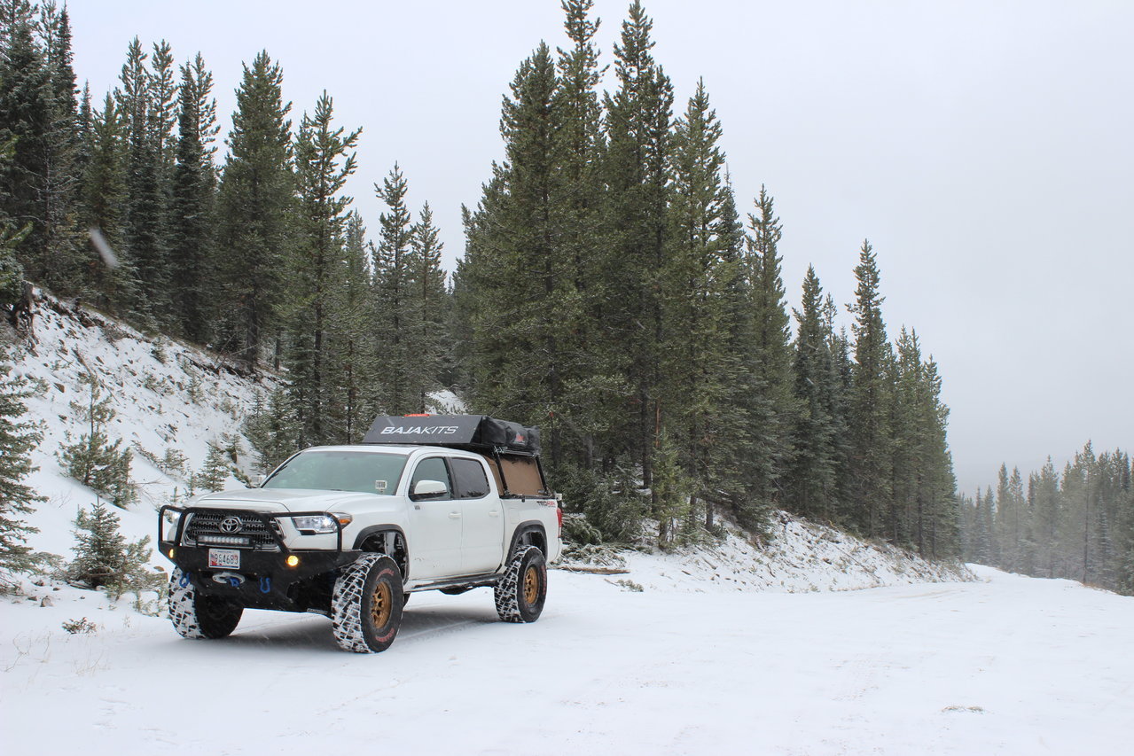

    :wave:
    I can get you taken care of!
    How do you plan on using your Truck? Do you have a budget in mind?
    We have our Chase kit available!
    Our Boxed UCA paired with Front and Rear King shocks and an option to run a Deaver Leaf pack!
