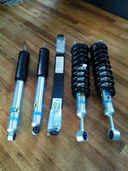

    80
    New Jersey
    2012 Tacoma SR5 ACLB
    falken wilpeaks at3w 265/75r16, Bilstein 5100 with OME 884, Deaver AAL, painted grill surround,
    Suspension parts came in and they are sweet!! Unfortunately, I won't have time to get them in until about 2 weeks from now, but until then maybe I can get your opinion on whether or not to add the 1/4" spacer...does it make a big difference, or can I get by without it affecting much?

    3coma
    3coma my kid says my truck is "Boss"
    Sep 19, 2015
    #164680
    1,067
    rob
    19 dcsb sport cement 4x4
    Add the spacer!!!! You will definitely see the driver side settle 1/4 to 1/2 inches more than the passenger side. Stock coils are made to account for this.

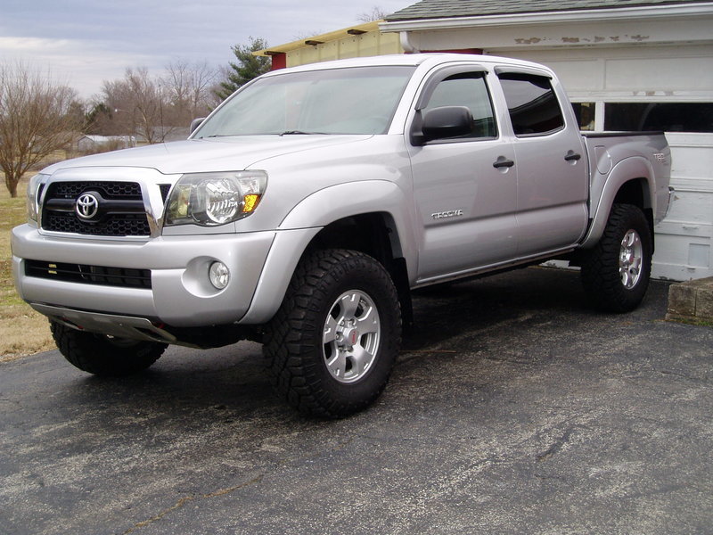

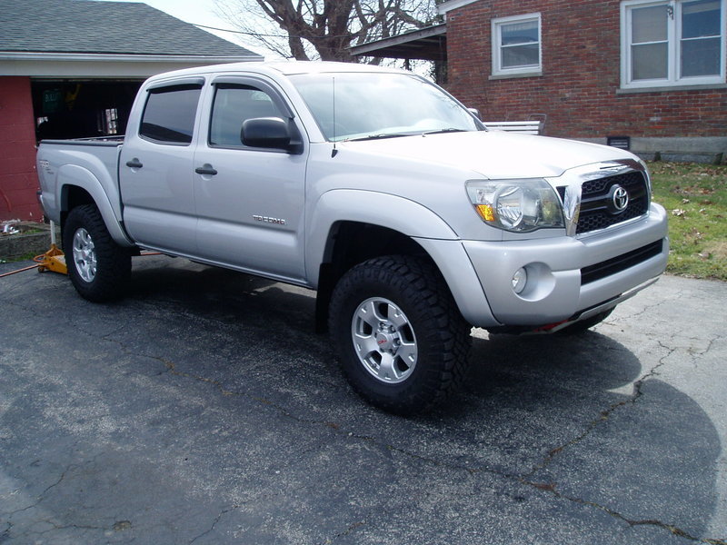

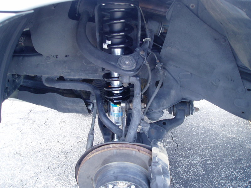

    If you get half way done with the install and have a problem, will someone at Amazon take the phone and guide you through the process? A reputable vendor is more than just an address on a shipping label. Marie (@ Headstrong Offroad) provides the experience of thousands upon thousands of lift kits. You don't get that from Amazon.
    OK...My lift; OME 885X's. Bilstein 5100's (@ 0") 1/2" plate spacers (for total lift of 3-1/16" above what it was stock) Deavers 2" AAL, Headstrong U-Bolt flip kit, struts assembled (by Headstrong) and I had just a tic under $800 in a lift that works extremely well, rides great, performs great, and looks exactly like I wanted. I got extremely lucky with alignment numbers. I was going to try to get "acceptable" numbers with stock UCA's....Turns out I got 2.9 degrees + caster, which is "desirable" rather than just acceptable (with 3" of lift) Under most circumstances, a lift beyond 2-1/2" would require new UCA's. Again, I was lucky. Most don't get that much caster.
    Just a personal opinion, but while installing a lift is an excellent time to do the U-Bolt flip.

    I agree with @3coma. Add the spacer. I have a 1/4" spacer on my driver's side and I still have a noticeable lean.

    Sorry it took me awhile to get back to you. We close at noon on Fridays and usually don't come back in until Monday at 9am and Mondays are always really hectic. The 1/4" top plate spacer helps accommodate for the lean you see when switching from factor to aftermarket coils so it is recommended to install it. I have seen trucks with varying degrees of lean but it is extremely common which is why it has been dubbed the "taco lean." :D
