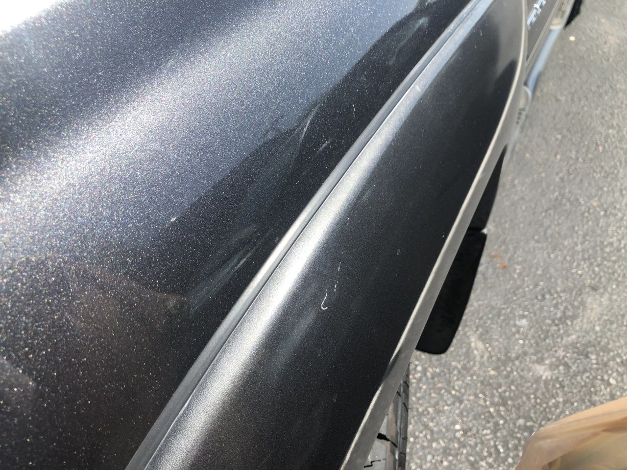

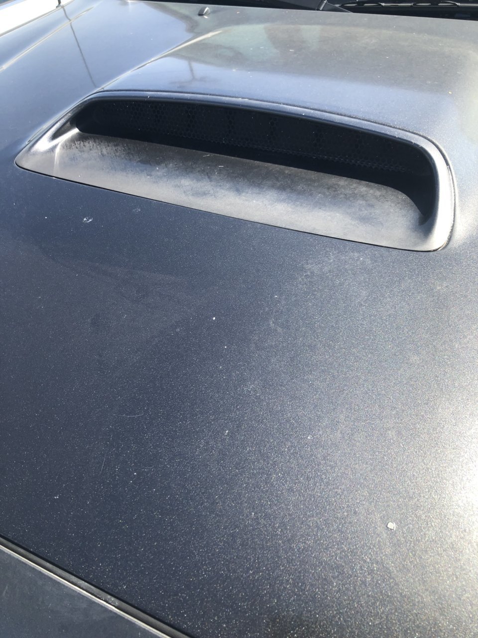

    Well how can I touch up or modify the hood scoop and Side fenders?

    Repaint. That's the clear coat coming off, typical crap Toyota paint job. I just bought another silver '06, and the scoop looks just like that. I'm going to sand, rattle can, and clear coat it.

    You can get the color match touch up paint in spray cans from several sites, just have to enter your paint code. Works decent enough for smaller parts like that scoop and flares. Some youtube videos can help you with paint prep and application. Did a STI spoiler and color matched my taco grill that way.

    Also, OP, it’s worth noting that the failures you’re showing are on painted plastic, not the painted metal. Which is cool & much easier to tackle. Remove plastic pieces & repaint yourself.

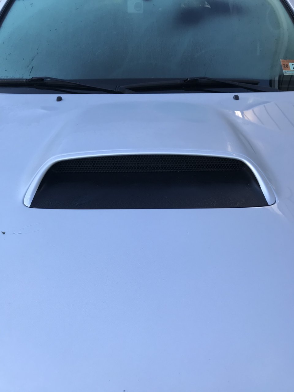

    You could derp the hood scoop like i did . And might try a DA Polisher first on the flares they might come back 356CCA7E-1D91-4329-A1FF-89A42552BFC4.jpg
