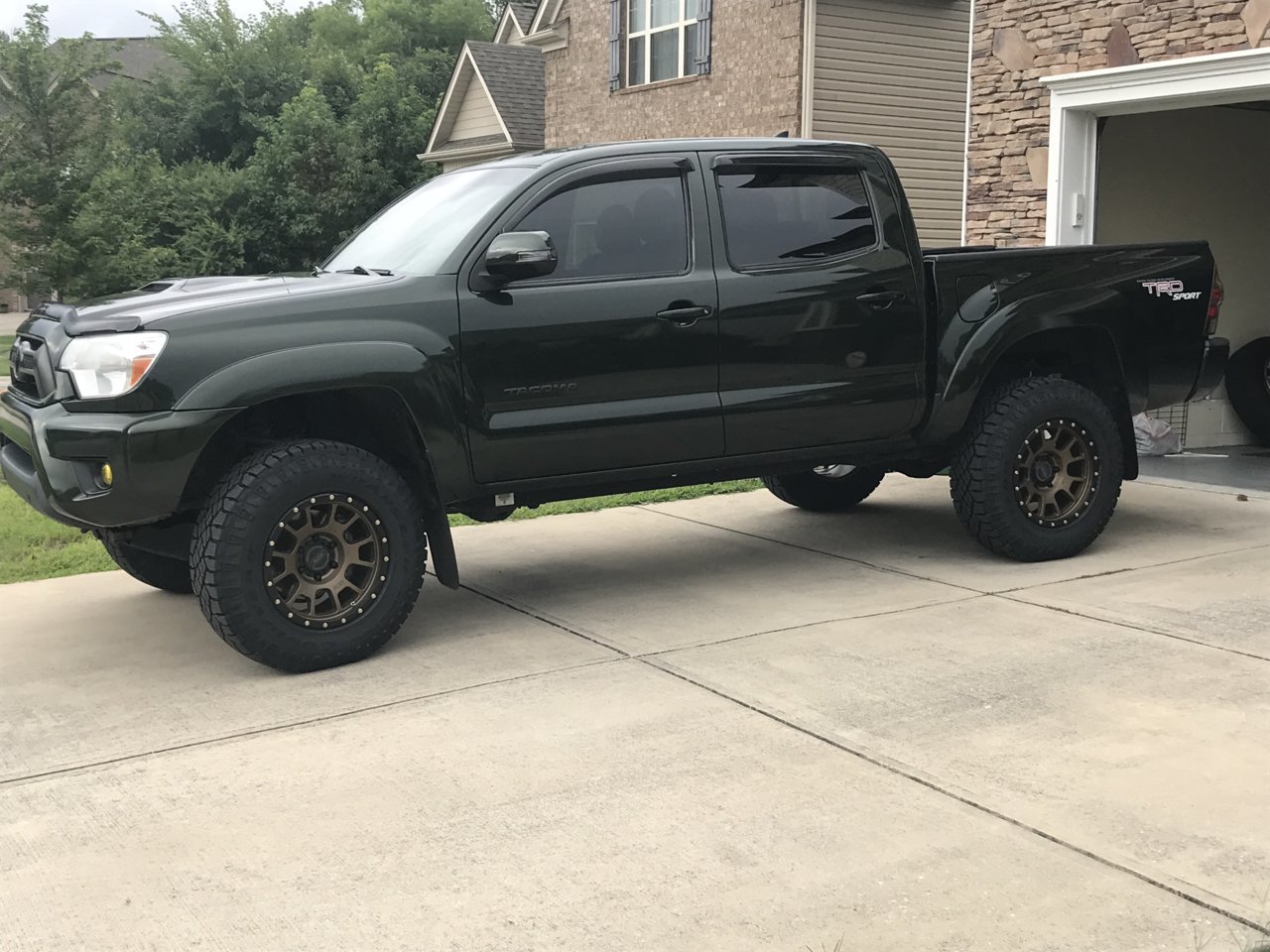

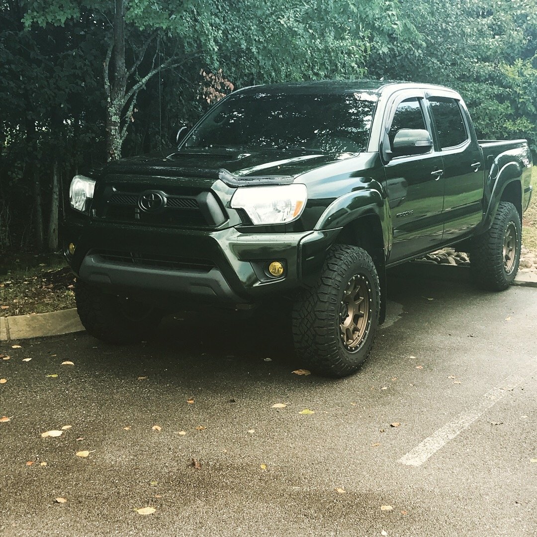

    2012 spruce mica trd sport
    Rrw wheels, trd exhaust, 2.5 inch leveling kit, window tint, tinted fog lights, tinted turn signals, blacked out emblems
    anyone have any suggestions for head and tail light replacements. I can’t decide if I want to keep my factory ones or not. upload_2018-8-7_21-35-46.jpg

    No off the shelf product is going to beat OEM for quality and optical output. While aftermarket headlights may look cool to some, many aftermarket headlights end up leaking/fogging, hazing and have poor beam performance. If looking to change it up, I'd recommend the OEM smoked chrome Pro headlights, plus high powered bulbs and a standalone relayed harness if looking to increase output.
