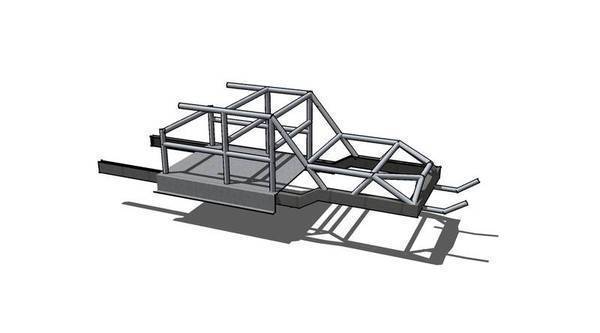

    so i am designing a cage for my truck this is what i got so far... tell me what you guys think... what should i ad or take away.

    Why not do some research ...and look for some guys who've already put cages in their tacomas. They can tell you what works and what doesn't in terms of strength/rigidity.
    Don't forget about mounting system for seats and 5-point harnasses.

    yeah thanks for the help janster.... as soon as i posted this i designed how i would do the harnesses. i am going to post up another pict when im complete with the cage...

    Full-race or keeping it somewhat streetable? Dash or no dash? Keeping the doors? Define the use, and also consider how you're gonna get in and out of the thing. :cool:
    You'll want triangulation where you can get it. Helps keep things strong and intact should the cage come into use. Include supports to prevent the cage from buckling if it rolls sideways.
    I'm really interested to see what you've got planned. Keeps us updated! :thumbsup:

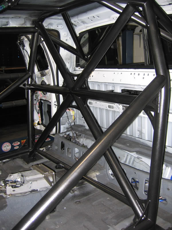

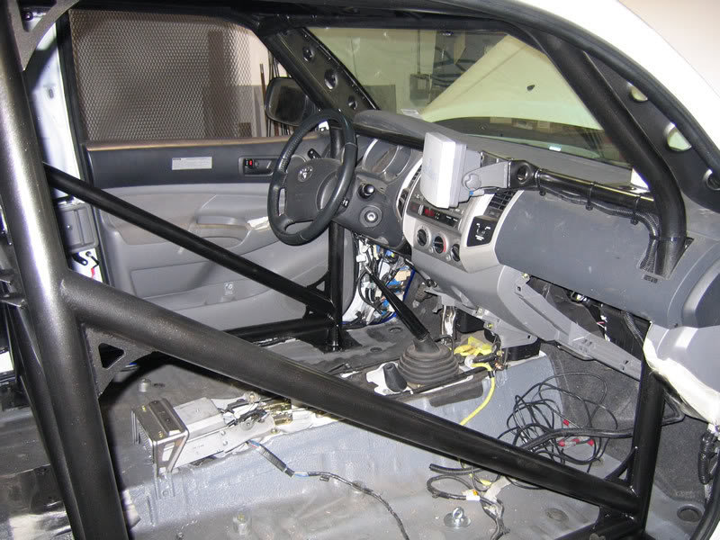

    Thats a nice cage mjp, somewhat similar to my cage on my 00

    Thanks! I just got my SCORE tag in September. If all goes well it should see a decent amount of use in the 2009 season. You still race class 7?

    buttt to try not to heist this thread, Take your designs ideas to a fab/race shop have them give you pointers, I know it helps sometimes to have someone physically there showing you examples, look at past peoples cages

    That brings up an excellent question. kmrofka, are you outsourcing the fabrication or doing it yourself? Any quality fabrication shop will be able to identify weak points immediately. Give them an idea and direction and they'll generally take it from there.
    Are you planning on racing or just building for your own safety? The sanctioning bodies (SCORE, MORE, BitD) all have rules and specs to which the rollcages must be built. Always good to refer to their design guidelines as those are tested and proven designs.
