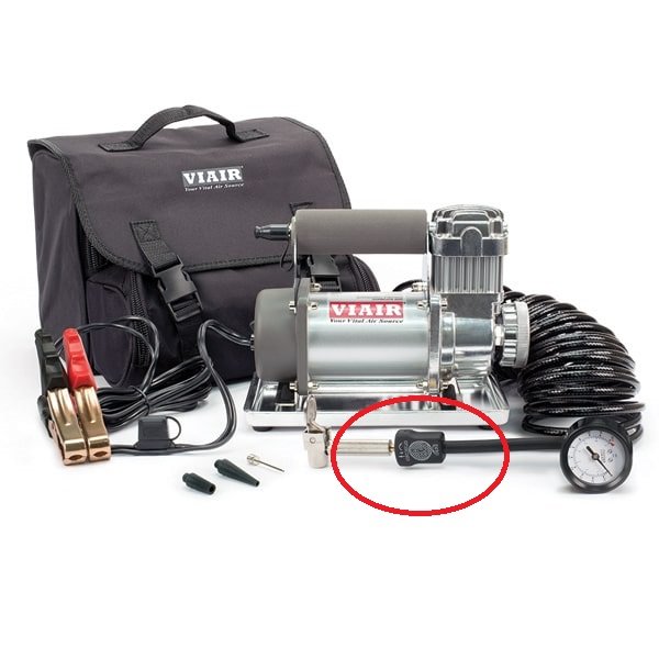

    Tank?
    There's no tank on these compressors. You have to turn the thing off when you get to the correct pressure.
    Are you talking about this piece (circled)?
    If so, that's a pressure release to help you deflate your tires. It does not protect your line from over pressure. Read your user manual.

    So this compressor doesn't have an automatic shut off pressure switch, meaning it will keep running until its shut off. You could add a pressure switch to it that would shut it off, but that would require modifying the wiring of the compressor. You could also put a pressure relief valve on the outlet of the compressor which would bleed pressure to atmosphere when it got too high. Your best but may be to buy the VIAIR hose that came with the compressor. I believe it's this, though it seems pretty expensive. You could also upgrade to another model that does come with an automatic shutoff.
    EDIT: Realized what you may be after is just an open flow air chuck. These will continuously flow air even when not attached to a tire, preventing any overpressure in the hose.
