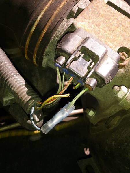

    It read misfire.... #2, swapped out coils and replaced "bad" coil with no improvement. I also had a badly worn wire yellow/green, third from left (of four) that broke completely.... might try to splice. Wish I knew how to post a photo here... I'll try.... any suggestions? Thanks to all!!!

    I spliced the other wire last year.... this one was barely holding on and leaves little room to splice. Anyone familiar with these or if this could be part of the problem? I'm going to replace the spark plugs tomorrow. The truck was tuned up a couple of years ago and they didn't replace a gasket and after I hit a puddle I found a misfire from water intrusion... replace plugs and it ran ok then.

    That looks like the harness for your MAF sensor. That broken wire could be the culprit to your misfire. I would definitely get that fix, reset the computer, and see how it goes.
