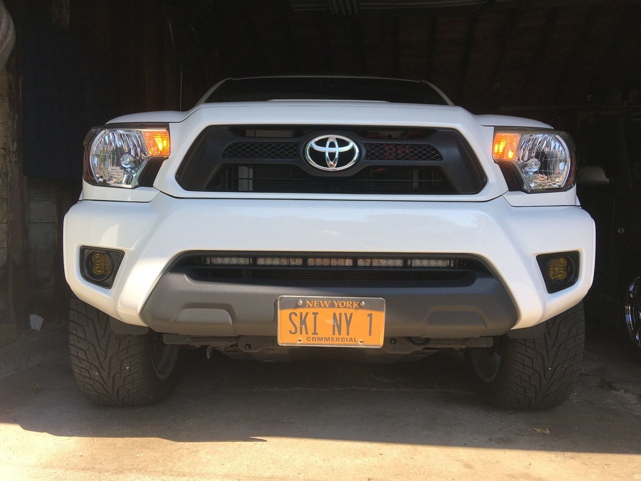

    On my 2014 Tacoma, I started out with CaliRaised brackets and one of their LED bars in an all driving pattern. Not bad, but I was not a fan of the light pattern. It just kind of blew light out all over the place. I switched to a Diode Dynamics 30" Stage LED bar (also an all driving pattern) and was much happier. Much tighter and thus more useful pattern.
