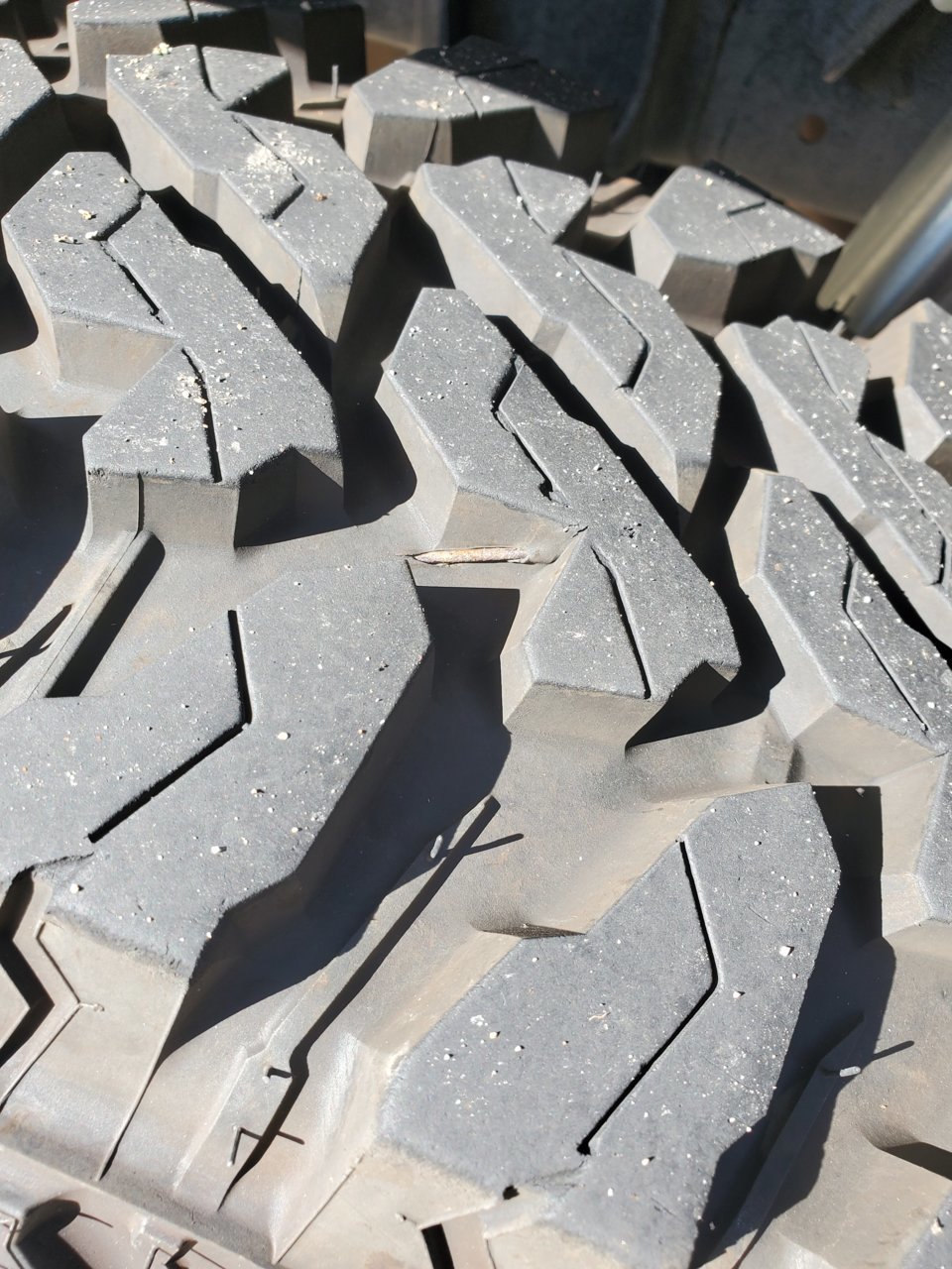

    Hi all hope you're having a great Saturday. Opinions or suggestions regarding a nail in tire? Just noticed it this morning and I am losing no air - and I do have a tire plug kit btw. Thanks!

    Mark the area with chalk or a paint pen, pull the nail and see if it leaks with soapy water. If it does, plug it. If it isn’t leaking now, my guess is that the nail isn’t in too far.

    X2
