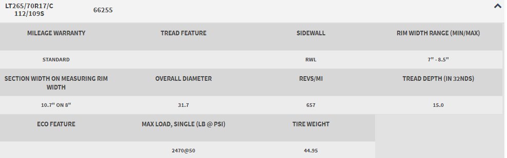

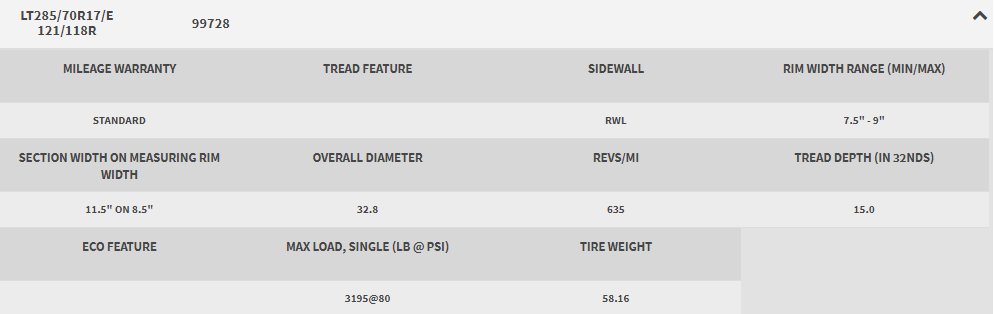

    I know for most truck tires the manufacturer does not recommend it because that will give the tire stretch. It'll fit but it'll look goofy. I think "tyresize" website was designed for cars and there are people who like the stretched out look there.
    Here are the spec's from BFG
    265/70R17
    285/70R17

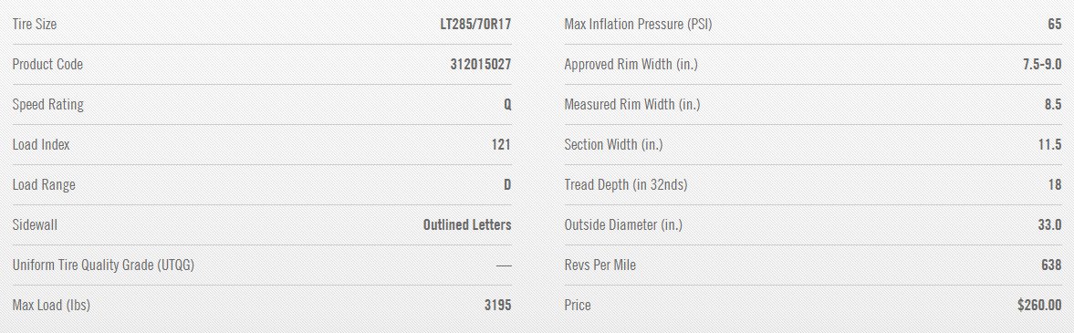

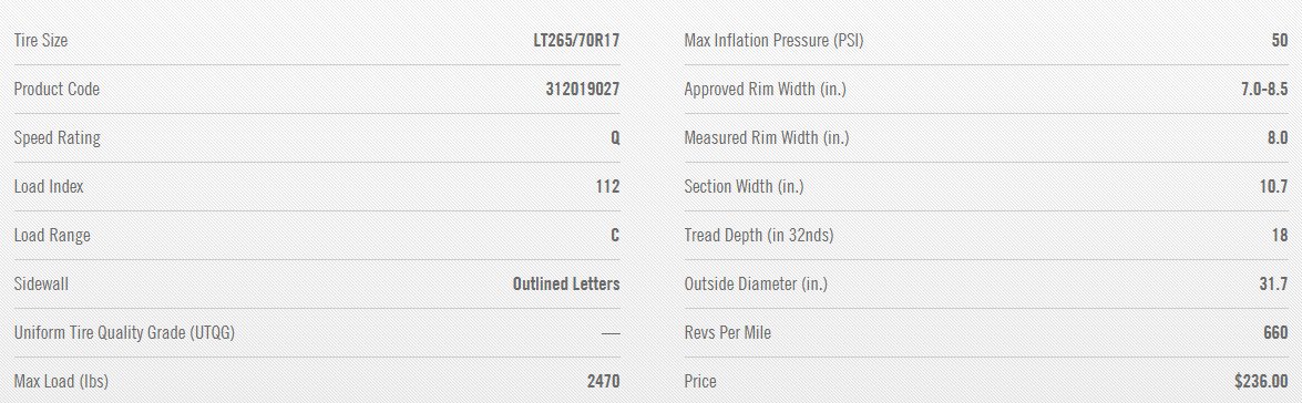

    Then Goodyear
    265/70R17
    285/70R17

    Could be but I did see that the max width they recommended for that size wheel was a 275, which I thought was odd. Probably the safest way would be to contact the manufacturer and just ask them, or maybe someone like Discount Tire. There is too much garbage out there on the Internet. :)
