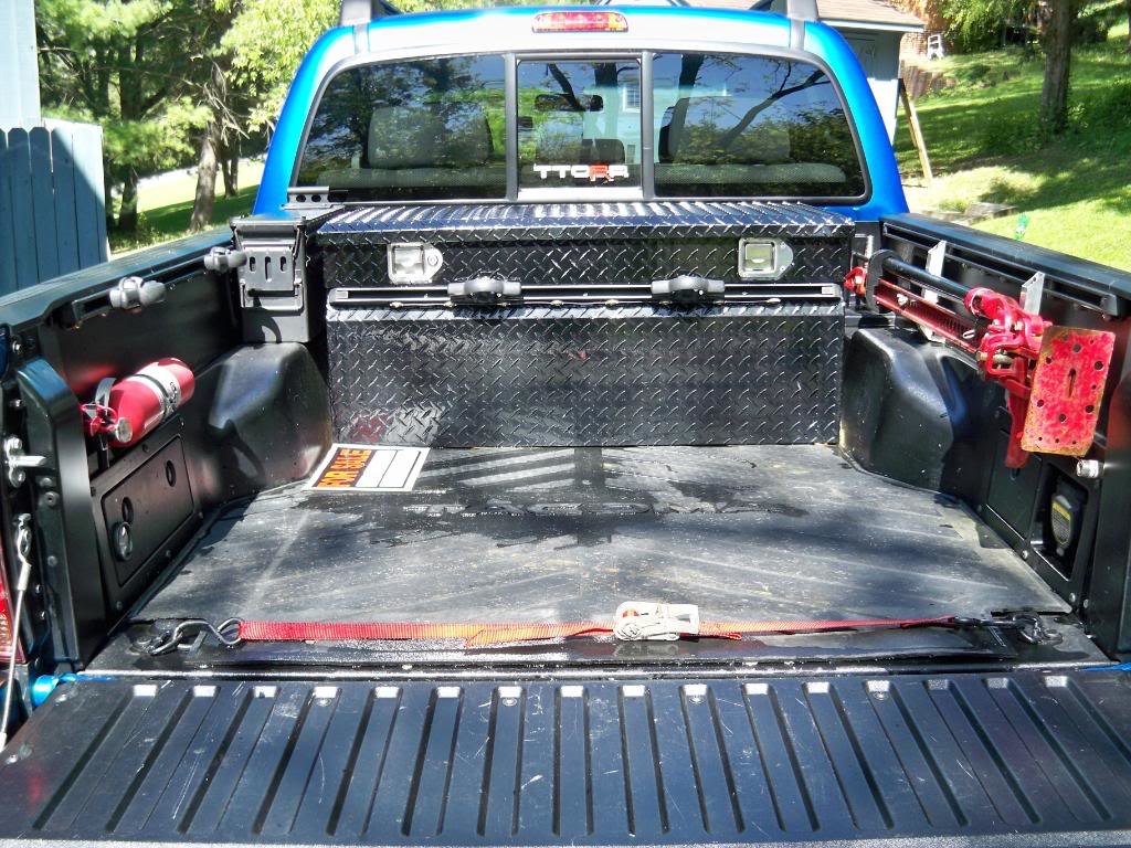

    A little tough to see but mine is bolted through the bed on the drivers side rear. I just used the plastic wall bracket that it came with and it holds it just fine even with all the wheeling I've done.
