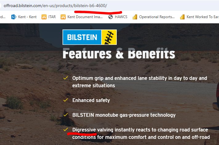

    2011 Silver Tacoma TRD Offroad, 2022 Honda CB500X
    Icon Coil Overs. Deaver U402 Stage 3 Leafs w/ Bilstein 5160s. ARB Deluxe Bull Bar. Fuel Boost wheels w/ Wrangler Duratracs. Brute Force Fab Sliders & HC Rear Bumper w/swingout
    The above snip was for the 5100, here's a snip for the 6112.
  9. Jan 21, 2025 at 2:47 PM

  10. Jan 21, 2025 at 2:48 PM
    YF_Ryan
    YF_Ryan Well-Known Member
    Feb 23, 2017
    #211450
    5,583
    Kent, WA
    And here is the 4600, too.
