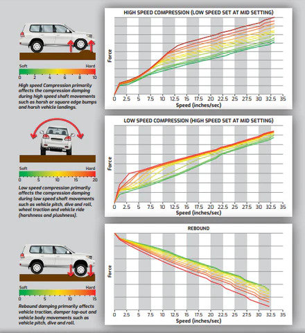

    Sounds like they simply don't provide the data. Would need an outside Dyno test like what was linked above. Talking to my buddy yesterday, he worked on specific car OEM lines. The OEM would give them the characteristics and they'd build/valve to suit. His Mercedes line wasn't a Digressive shock, whereas he said the Chrysler lines were. But they'd make Digressive, Progressive, and Linear with many different curves based on the requested performance.

    Dobinsons actually do publish their data.

    That looks more like an educational diagram than actual data. The specific shock is not mentioned.

    I pulled it from their MRR (MRA) listing for a Toyota Tacoma.
    The different color lines represent different settings on their shocks.
    https://dobinsonusa.com/mrr-3-way-adjustable/

    What is that?

    That is the specific shock that produced those graphs. For a third gen Toyota Tacoma.

    Sorry, maybe I edited the post to include the link after you saw it.
