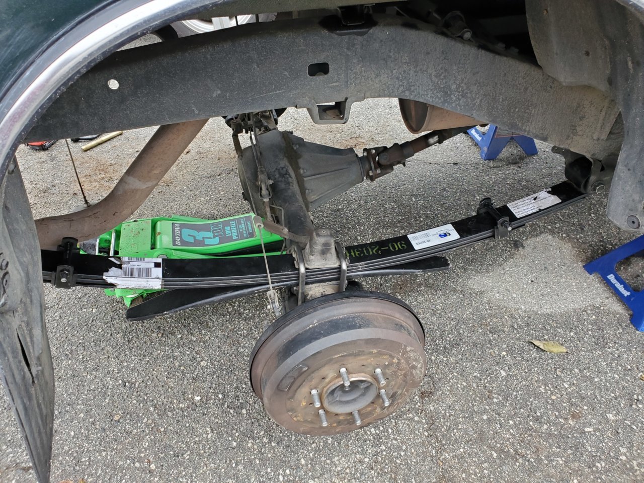

    Current State: I need to talk to the shop that they installed the helper springs upside down.

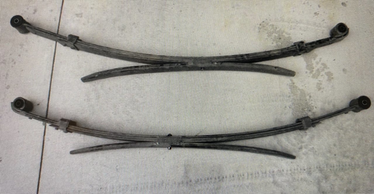

    HAHA! It took some explaining that the 1st Gen Overload (Helper) spring + Leafs aren't the same as other generations, other brand trucks, etc. i.e., 1st gen tacoma Overloads are on the bottom, on some those are installed on the top of the leafs, that some overloads are integrated into the shackles of the Leaf pack, etc.

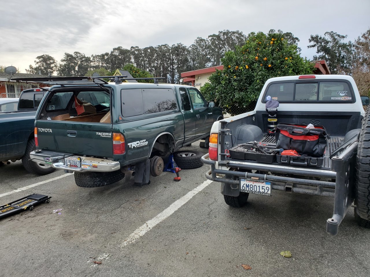

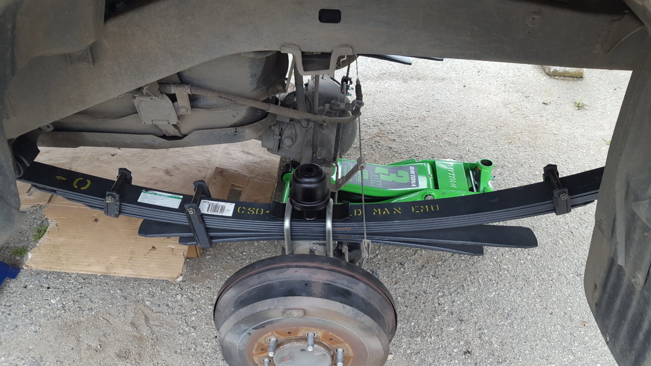

    First 2 pics are of another member at my house, 3rd pic is of my truck.
    I've done 3 so far last year and willing to help do more :rofl:
