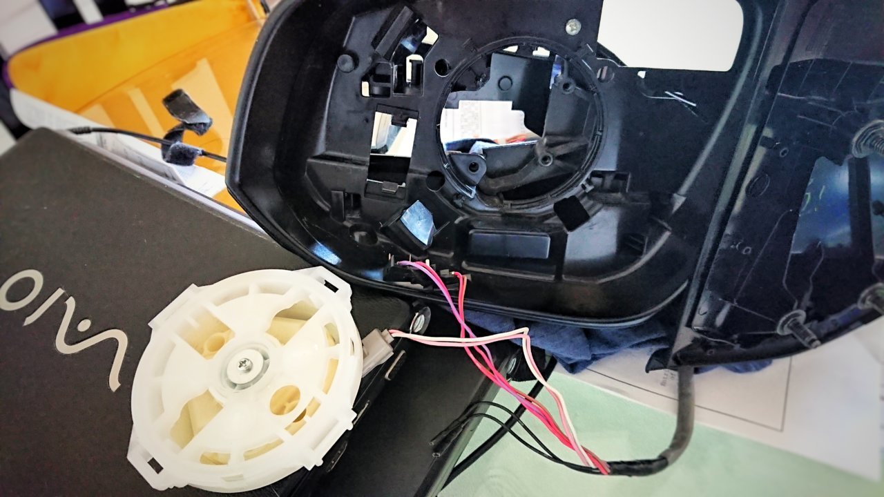

    Rainoffire
    Rainoffire Well-Known Member
    May 31, 2018
    #255034
    3,120
    2017 QS DCLB TRD Sport
    These are actually my power folding mirrors.
    But my original mirrors had the same mirror backing and same motor, so I never thought too much of it.
    I believe when @KTJO 4x4 was initially making these power folding mirrors, I think she said that some come with these type of motors.
    And I think the limited? OEM mirrors she pulled apart had the same motor.
    Well, it is my fault for not paying attention.

  7. Oct 11, 2019 at 11:09 PM
    #87
    Rainoffire
    May 31, 2018
    #255034
    3,120
    Welp can't just switch out the motor.
    It won't sit flush with the rear mounts.
    Will need to switch out the mirror housing, mirror body to hinge connection and motor mounting bracket and the mirror motor actuator, but keep the hinge for the folding actuator, bottom cover, and turn signal.
    I think I may be able to still use my existing harness.
