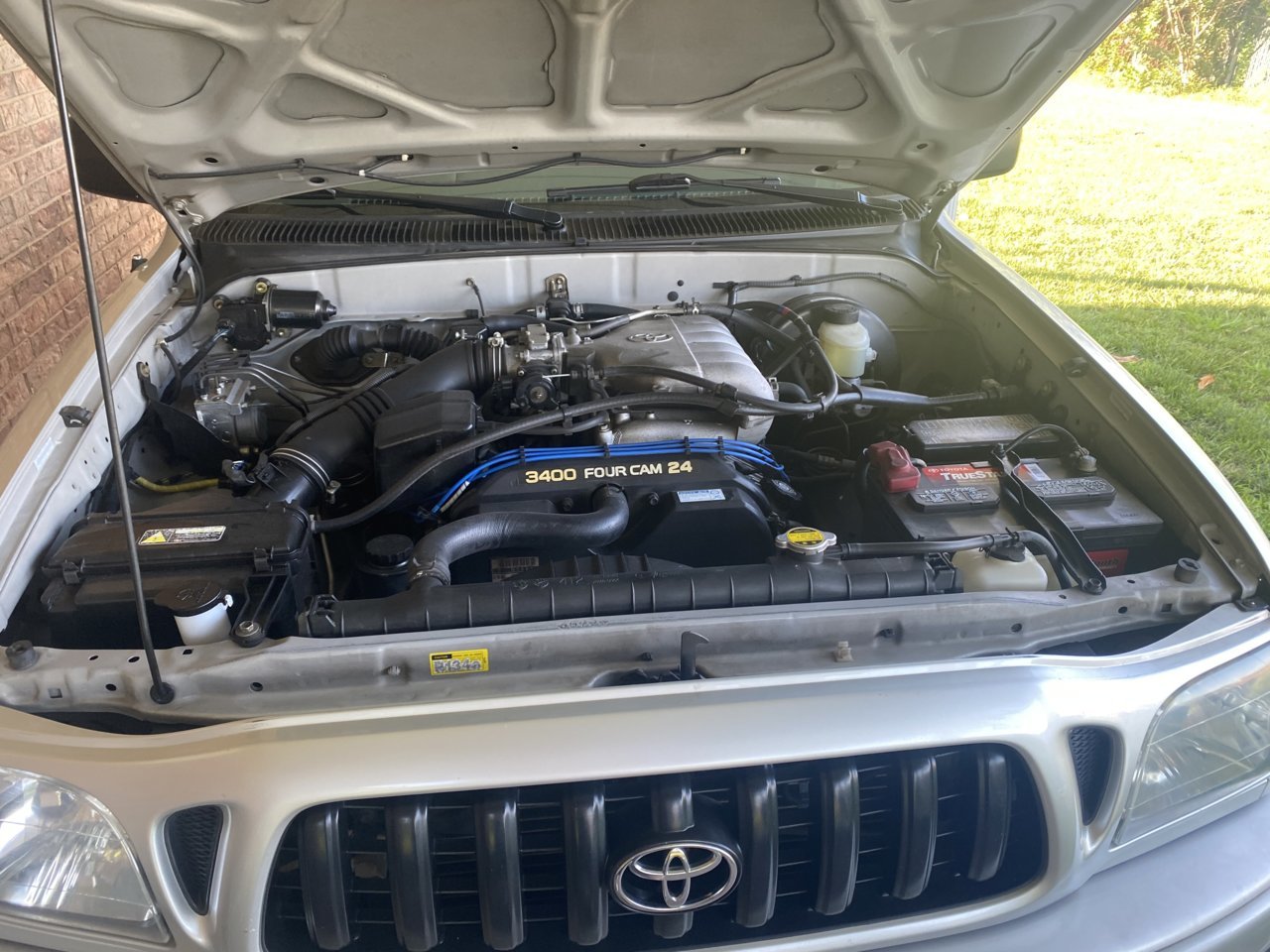

    I recently changed my plugs an wires on my 1999 Toyota Sr5 2.7L engine and had a set of Sumitomo wires on for the last 30k miles. I always use Denso K16R-U copper core plugs. I do not recall why I used sumitomo wires (I do believe they were OE) the past 30k miles but had gotten used to my engine idling rough (stable but rough) to where you could see the engine shaking on the mounts. I replaced this time with a set of NGK RC-TX67 wires an instantly on start up the sound, vibration, idling and smooth feeling I so recall from my Taco came right back. I have seen an improvement in power an mpg so wanted to post that my thoughts are that SUMITOMO wires are garbage and will never touch my truck again. Interested to see if any of you all have had the same experience? Hope you all are well and your Tacos even better! (If Sumitomo even still makes wires)

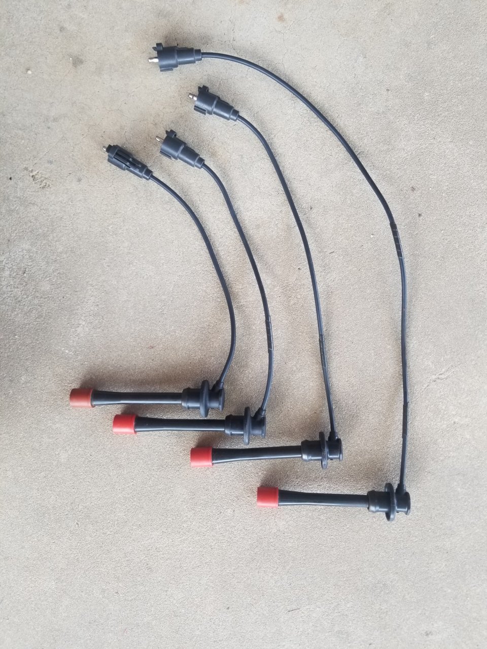

    Well these Sumitomo wires have 40k on them so I am not sure how long or how many miles you should have before you change them but they are Sumitomo 2015 wires so they also have 7 years on them but to their credit they still look really good. Maybe I should put them back on an see how they do with the new plugs. What do you guys think? For experiment sake or are they waaaay past their limit?
  11. Jul 12, 2022 at 12:49 PM
    Diablo169
    Diablo169 ROKRAPR
    Mar 12, 2016
    #181079
    2,908
    Max
    Santa Cruz, CA
    99’ Bro-Coma’s Revenge 3RZ 345k+
    Stock
    Those look brand new. You could check resistance if you are worried.
    New set from the dealer is about $86.
    I try not to over maintenance my trucks, even though it’s hard sometimes. :rofl:
    I changed the plugs on my Tundra with 170k on them, and they still looked new.
  12. Jul 12, 2022 at 12:55 PM
    Cland75
    Cland75 [OP] Well-Known Member
    May 12, 2022
    #397076
    384
    Kevin
    Piedmont NC
    99 Tacoma SR5 4x4
    Well only thing that happened with these is the mechanic that changed my plugs last left #1 to loose an gases built up an popped the plug wire off the plug. I tightened down properly an never had the issue again. It would be interesting to see if fresh plugs and those wires would run smooth. I did clean them good with electronic cleaner as there was some carbon on the #1 that popped off. I wouldnt know how to check the resistance.

  15. Jul 12, 2022 at 1:15 PM
    opteron
    opteron Well-Known Member
    May 27, 2014
    #130756
    1,345
    whittier, CA.
    2003 DB 4x4 SR5
    Leer camper, bug-rug, fox suspension 2.0 rear, fox 2.5 front, BAMF sliders and LCA, TRD fake 3 piece rims
    They look better, than the NGK. As someone mentioned they look new.
    Cland75[OP] likes this.
  16. Jul 12, 2022 at 1:22 PM
    #16
    Cland75
    May 12, 2022
    #397076
    384
    Kevin
    Piedmont NC
    99 Tacoma SR5 4x4
    Yeah the blue NGKs just stick out like a sore thumb
  17. Jul 12, 2022 at 2:01 PM
    #17
    Cland75
    May 12, 2022
    #397076
    384
    Kevin
    Piedmont NC
    99 Tacoma SR5 4x4
    They have been changed an short test run seemed good. Maaaaaybe a little longer crank time but if so verrrrry minimal. Idle smooth....ran smooth so MAAAAYBE ill be eating my own words we shall see
  18. Jul 12, 2022 at 9:34 PM
    #18
    Oldman808
    Oldman808 Well-Known Member
    Dec 8, 2016
    #204392
    790
    Planet Earth
    2023 Taco TRD Sport
    I’m happy with my blue NGKs :D
