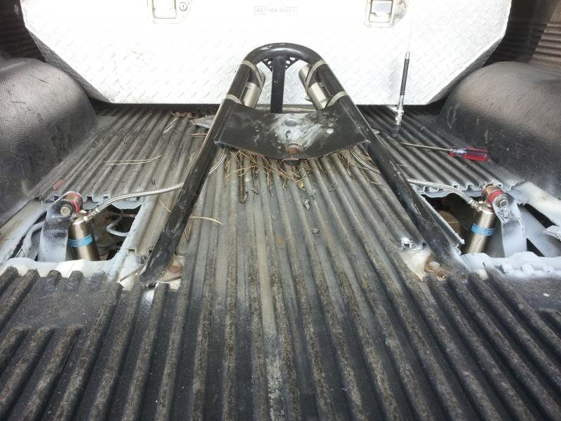

    Yea I wouldnt do it again through the bed. I would cut them shorter and have them almost up against the bed. Those mounts are almost a blank slate and you can slice and dice them anyway you need.
