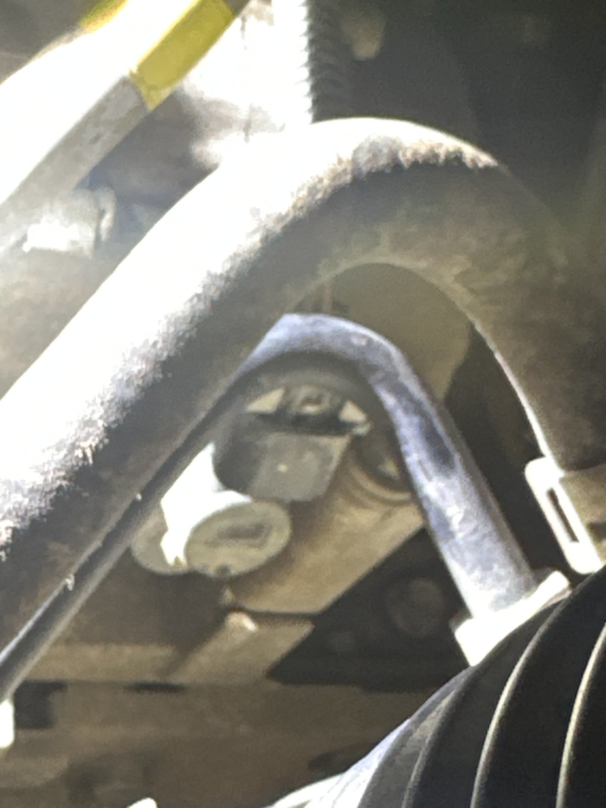

    What next boss? Would I be able to test with that connector at the bottom or does it have to be the grey connector in picture 1?

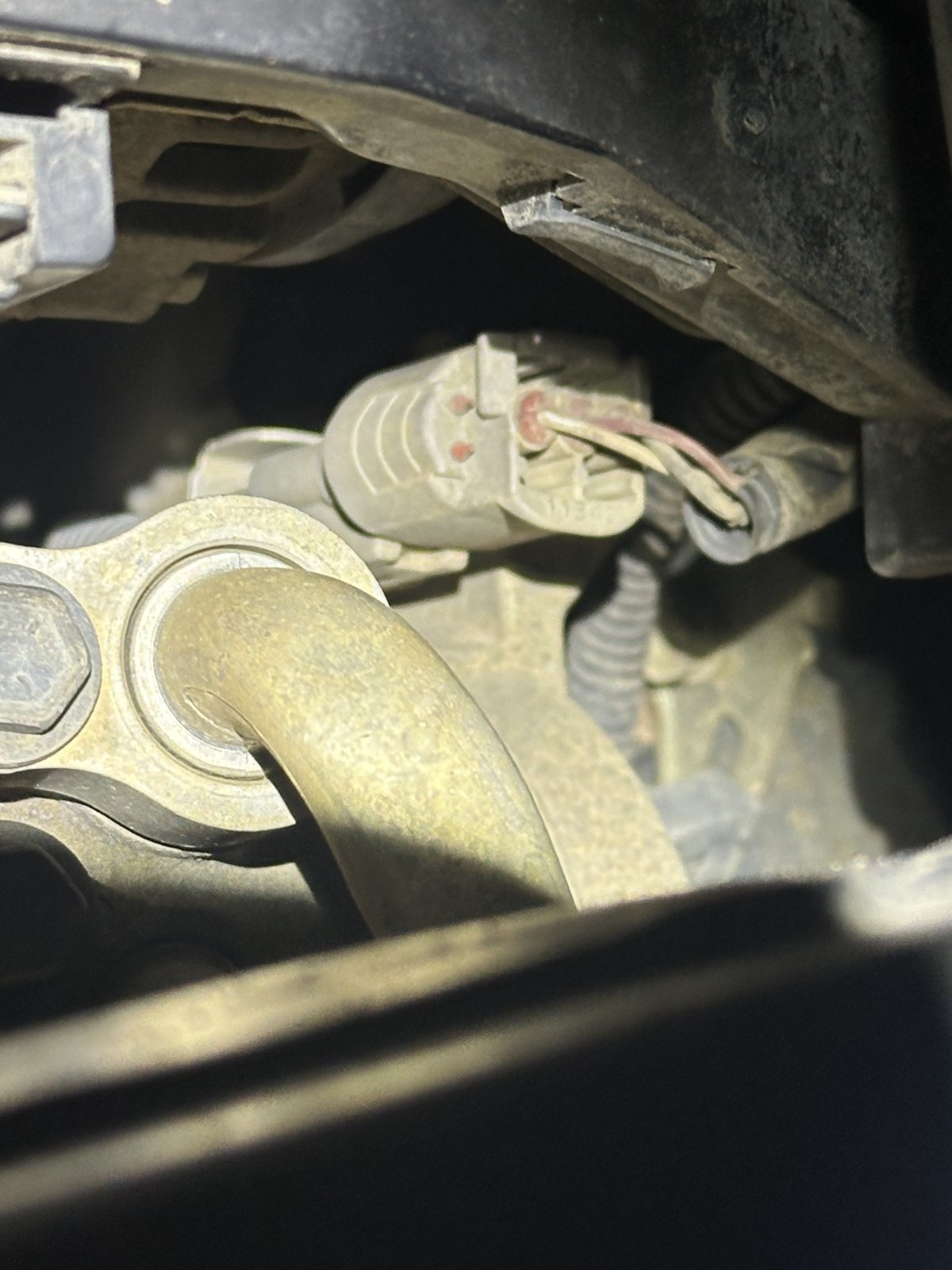

    Predator tube steps, Ranch Hand grill guard, Magnaflow CatBack exhaust, Toyota tool box & bed mat, 2LO Module by @Up2NoGood, Rearview Compass/Temp Mirror, Tune by @JustDSM.
    We need the top connector on the compressor, Pin 1 (Violet) is the wire we're after.

    Grey 2015 TRD Tacoma
    any tips on how one might remove that booger? tried with one hand and then two hands with no luck.
    I would have to look at mine to see how it would be best accessed but I can't do that till tomorrow.
    There's a button on the connector to release it but some Toyota connectors are a bear to get unlatched.
    We need to verify we are getting power to the compressor but without poking wires we gotta get that connector unplugged.
    Can you get to the single wire connector that goes to the clutch itself? It will be the wire coming from behind the compressor pulley.
    Fine with me, I mean we're basically down to a broken wire or bad clutch at this point. Just need to verify which one it is.
