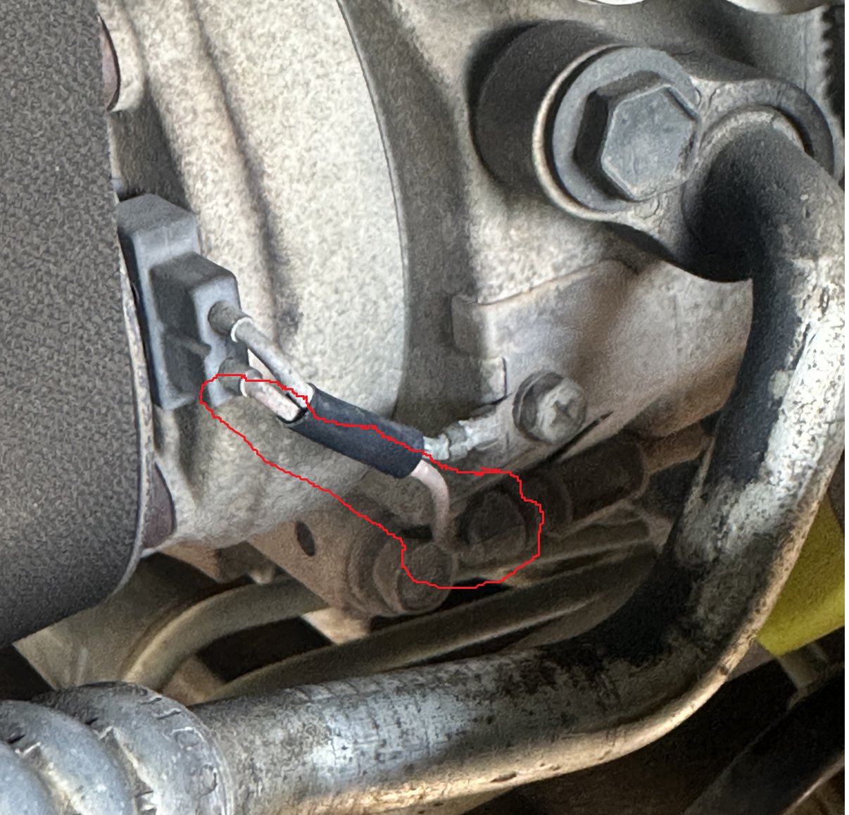

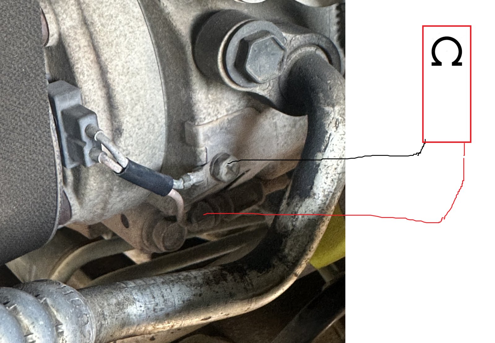

    If you can access it check resistance between the wire going to the clutch and ground.
    I would expect it to be around 4 ohms
    You can also take your test light from battery positive and touch it to that wire, it should light up.

    So i attached the test light to the positive terminal on the battery, and then unplugged that little bullet connector thing on the side of the compressor. I stuck the test light in there a few times but never got it to light up. To be clear i stuck it on both the actual male in of the connection and then inside the female end of the connection and neither lit up.
    It would however, light up when i put the test light on the compressor body.

    So it's a bad clutch coil then.
