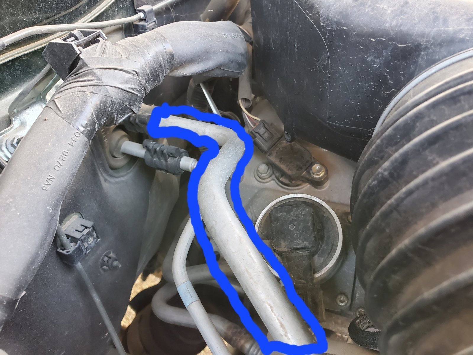

    Shouldn't need to do anything, never a bad idea to check all the fluids while your under the hood though.
    You can do a quick check on the A/C by checking the suction line with the A/C running and the blower on high, if it's ice cold your good. If it's barely cool or not cool at all it may be low on refrigerant.

    Did a checkup today and everything seems fine, the clutch engages and disengages correctly when cycling the AC button in the truck. Torqued it down and put some thread locker blue on the bolt that goes into the compressor stem. Let it run for a while and the line on the inside of the engine bay was pretty much ice cold, generating a lot of condensation lol. AC was blowing about as cold as I remember it being before it quit out on me, maybe like what 55-60 degrees while driving? No thermometer to back that up with, just a guess on my end. No abnormal noise coming from the compressor area, took it up to 3000 RPM for like ten seconds to see what was up and no problems. AC light no longer flashes.
