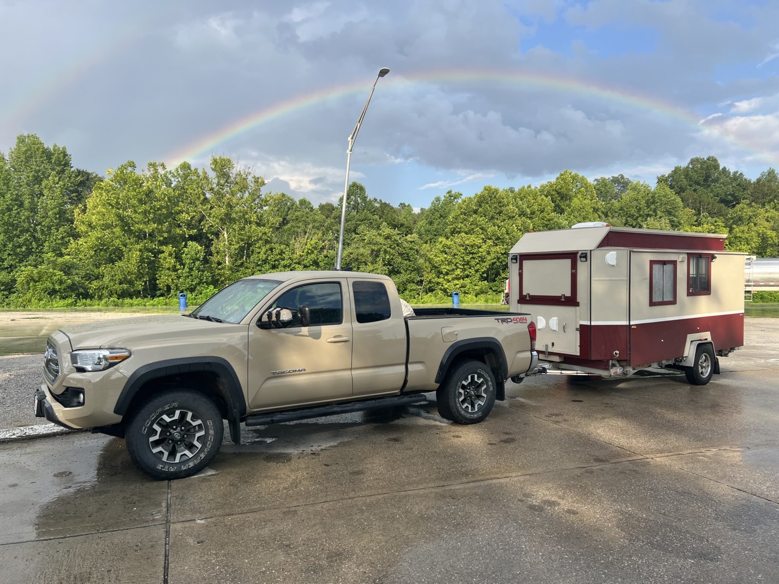

    upload_2023-11-5_13-26-32.jpg Hopefully this pict posts. This is my setup. It’s gone over 90,000 miles truck and camper. Truck had just about 180,000 when I turned it in. Read end sits just about perfect traveling. And never a mechanical failure. About 300 lbs of gear in the back when I travel mostly in the front of the axle. 300 lbs of trailer tongue load. Probably another 200 lbs of gear in the cab and of course 250lbs of me. At the scales I’m at the high end of the limits but never overloaded. That’s why I figured just replace with 2023 before they screw it up imo. I like that I’m 34 feet from front of truck to back of trailer as I fit in 2 lines up parking spaces. And never had a problem. I have really considered the Firestone airbags. But they seem like such a hassle. And I’ve read unloaded they kind of make the ride hard. Also much harder to install.

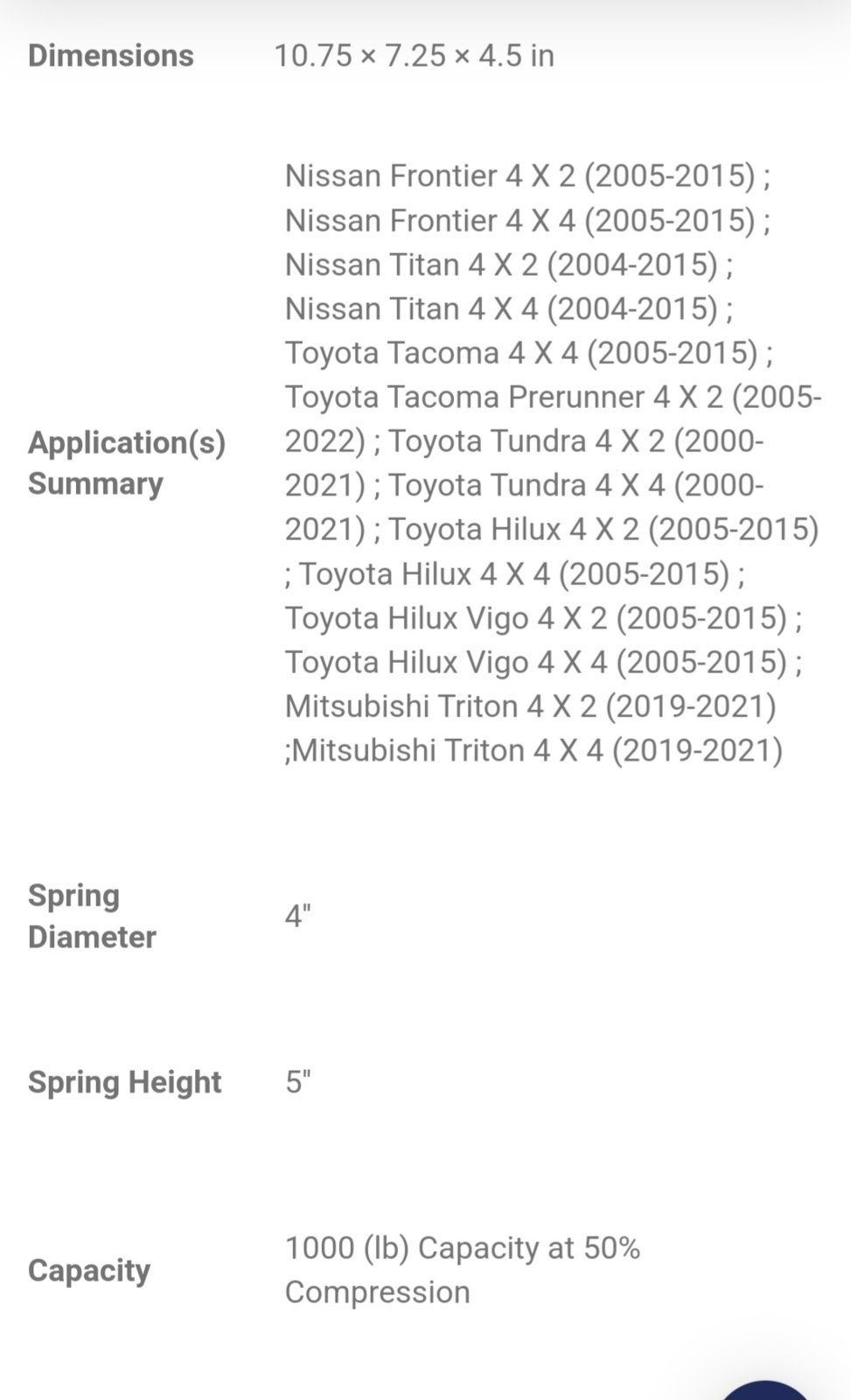

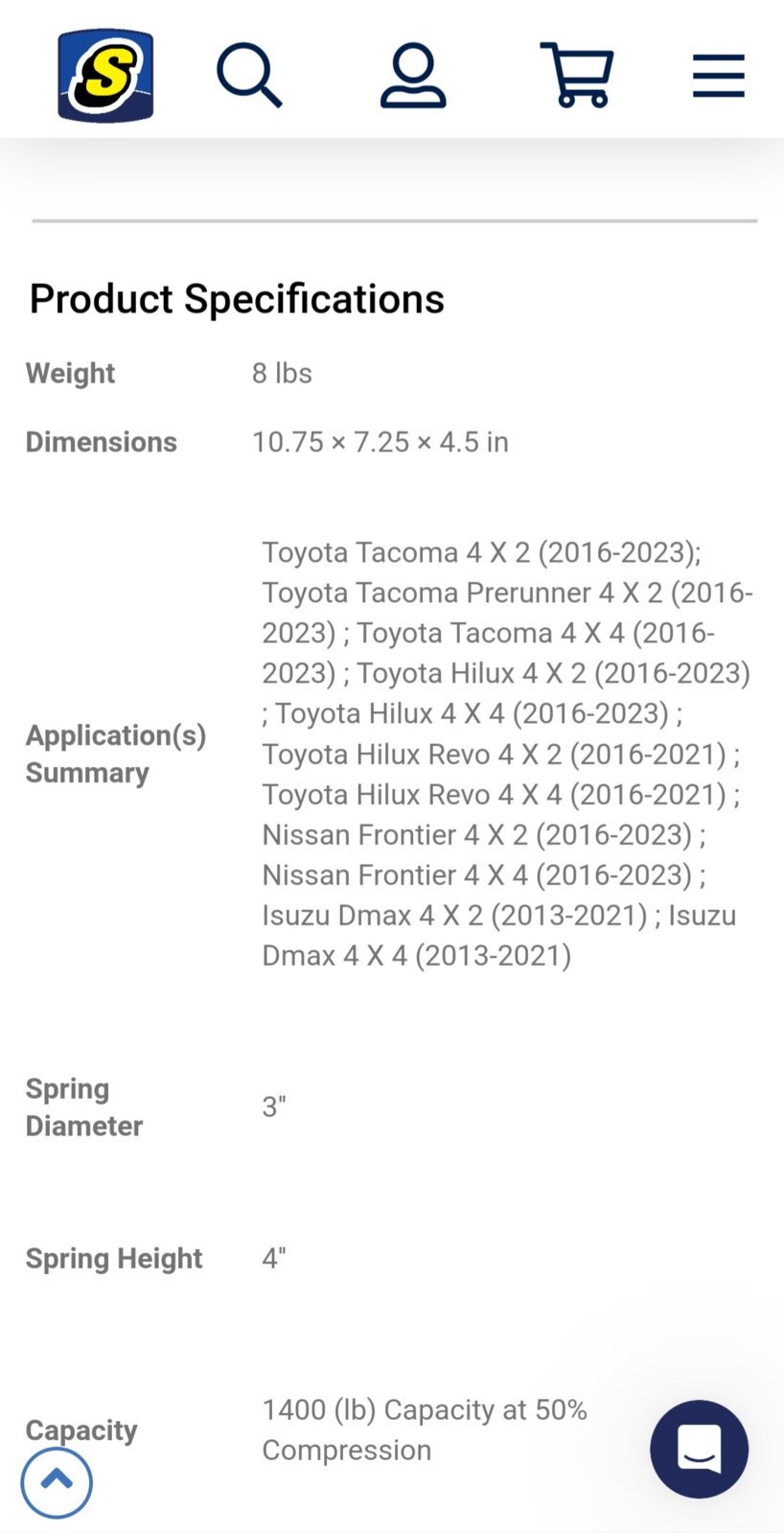

    The 610's, and 612 are the same diameter and density in the blue and black. The 612's is a lobe, shorter like you want. That's the only difference in the two models.
    Ok, I found info on the two models610 vs 612. I was wrong on diameter. But load capacityisgreat on 612 vs 610. Hereisfrom Sumo site on both.

    Having problems downloading Screenshot_20231105_200034_Chrome.jpginfo.

    Just to update the thread. I had not caught a critical difference in how they made the spring unit smaller but made the weight capacity higher. So I’m going to give the 612-40 a try. I got this response back from the sumo spring people. Figure go with what they designed for now just in case there was ever a warranty issue. It’s not that hard to install and if needed swap them out.
    “Hello,
    I definitely understand your concern, however, although our updated 612 kit is a bit smaller, it is actually rated at a higher capacity than the older 610 kit. The SSR-612-40 kit is rated at 1400 lbs, whereas the 610 kit is rated for 1000 lbs.
    In terms of a similar spring, we do offer builder kits which are 5 inches tall and 4 inches in diameter. Our builder kits do not come with any bolts or brackets and the customer is responsible for outsourcing any parts necessary to mount the kit to their vehicle.
