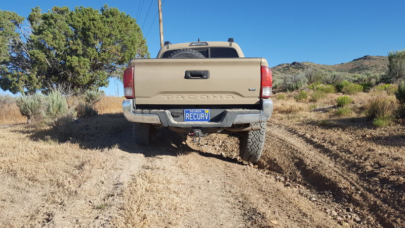

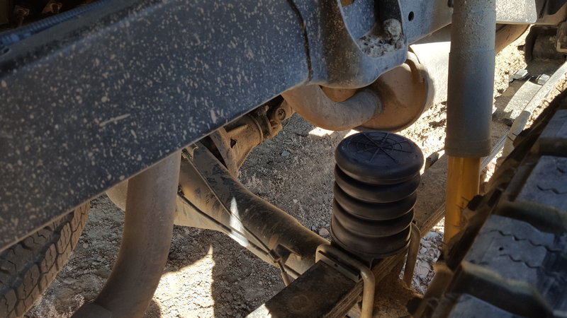

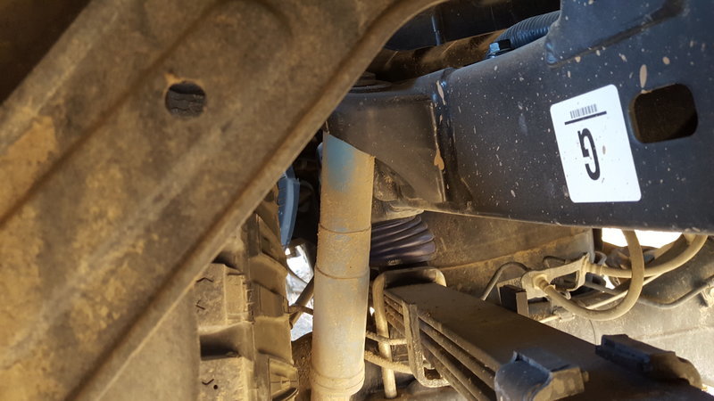

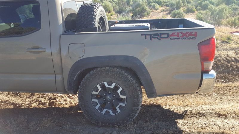

    Sumo Springs seem to be a popular Trend around here.. since after 10 years of week Springs on the second generation Tacomas it appears that the third generation Springs are just as weak. So to support my roof top tent and bedrack and all my camping gear I decided to install the Sumo Springs to stop the sag. I was skeptical that these would be able to flex at all. But here are a few pictures to show that they do compress under normal off road conditions. I may have lost a slight amount of articulation but not a lot. Like others I did gain exactly five eighths of an inch of lift with these. On-road ride while unloaded is greatly improved with no body roll in the rear.20160625_071355.jpg 20160625_071425.jpg 20160625_071410.jpg 20160625_071442.jpg

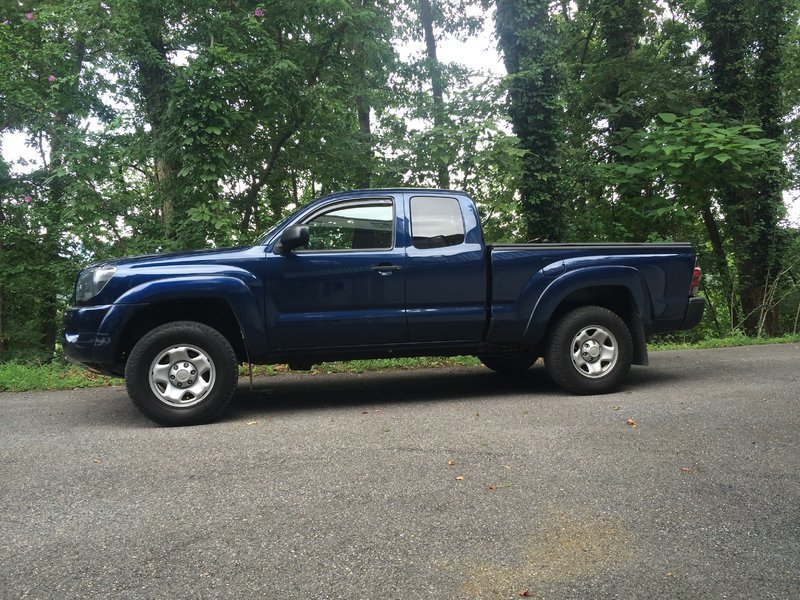

    I'm about to order a set to hopefully stop this sag before it gets any worse:

    I have no weight in the bed in that picture. I haul and tow several days a week...
