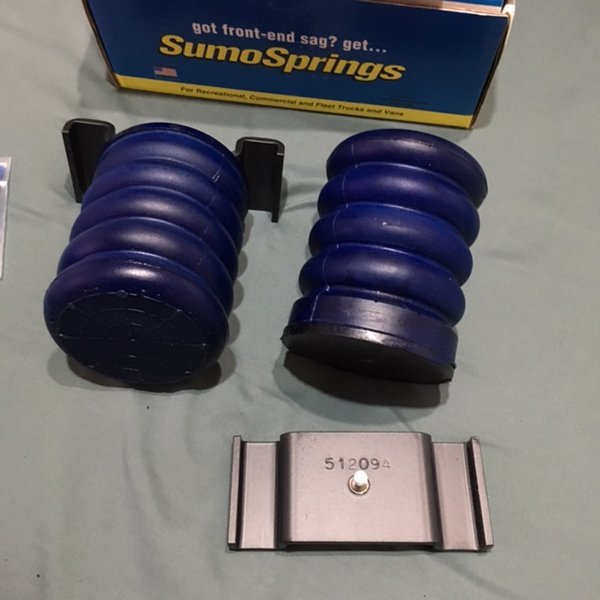

    So a little while ago I installed a multi-leaf add a leaf from Wheelers Off-Road that gave the rear the advertised 1.5" of lift. These were designed to replace the stock overload leaf from the pack. I wasn't really comfortable running without overloads as I do load my truck from time to time and didn't want to go for a full replacement leaf pack yet. After doing some research and seeing other members using the Sumo Springs, I've decided to give them a try and ordered a set. The Sumo Springs measures 6 inches in height and that's for a stock truck. I then contacted the good people from Sumo Springs and inquired about other options such as taller bump stops or taller brackets and they were nice enough to work with me and will be sending me custom brackets that will be higher to compensate for the lift. I should have the extra hardware soon and will take additional photos as well as a full review when installed and tested.

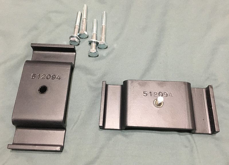

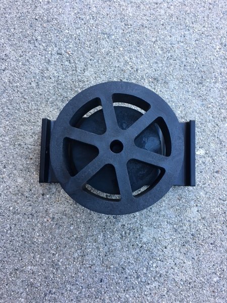

    Below photos are pictures of part #SSR-610-40 with the regular brackets. The bump stops easily screws on and off. A supplied blue loctite is included with the kit. For those interested, they will be manufacturing the taller brackets for lifted applications and will be available soon. Stay tuned for more info.

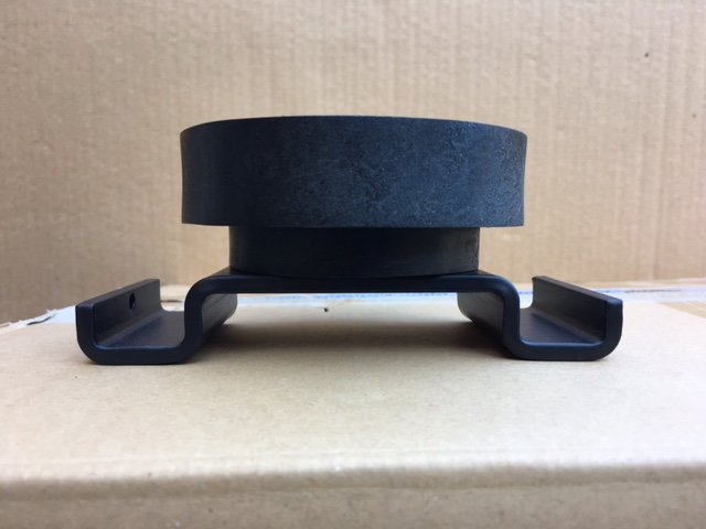

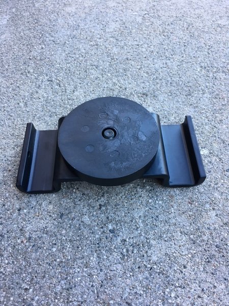

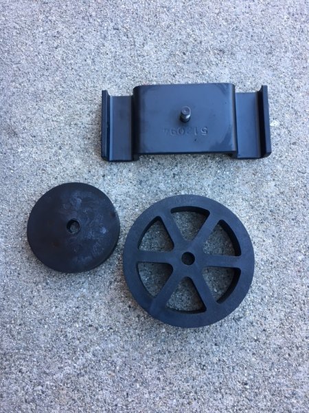

    So I received the spacers and even though the wrong brackets where sent, I can show that spacer will extend to a total height of 7 inches with the big wheel spacer and an additional 1/2 inch with the solid spacer added. Not sure about how I feel stacking spacers though.
    So I just received a package from UPS at 9:03PM! Thank you UPS, according to tracking, this was on their truck at 5:33AM this morning "out for delivery". Good thing these are made out of steel.

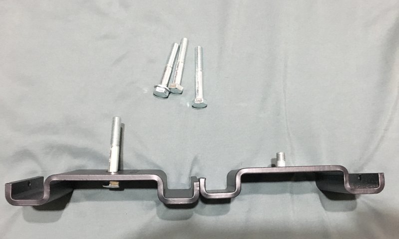

    Basically the new brackets did not have the pre-installed stud but a bolt hole. New brackets came with new grade 8 bolts. Not sure yet if I will install with both the 1" and 1/2" spacers stacked giving the additional 1.5" in extra height. I don't think I will have time to install this weekend as I would have to install my AP UCA's and OME coils along with the Sumosprings. Stay tuned....
    Update:
    So after reviewing this again, the spacer idea might not work as the brackets now uses a bolt that comes in from underneath and will most likely be a clearance issue with the leaf pack tie-bolt. I'll inform the engineer at Sumo Springs and see what they come up with.

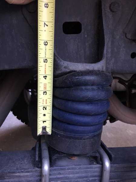

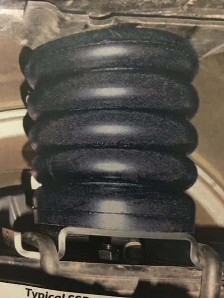

    So after some more time and mileage with the Sumo Springs set up with the 1.5" spacers, here's an updated review on them.

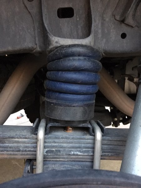

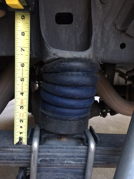

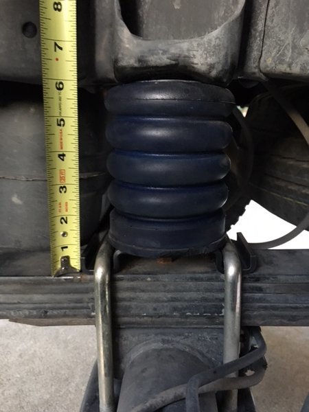

    Below is what the Sumo's look like with the truck's weight on it. The truck has a Wheeler's 1.5" progressive AAL. The sumo springs itself is about 5" tall and with the truck's weight on it, it is compressed to about 4". I believe with a stock truck, the compression is similar thus giving a slight lift of about 3/4". Since I have the spacers on, this also provided the same lift.

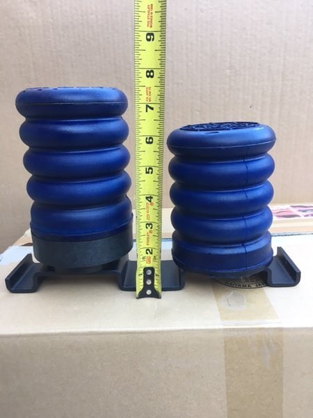

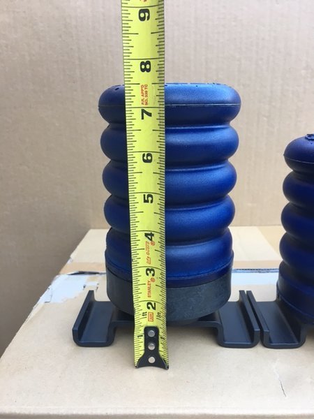

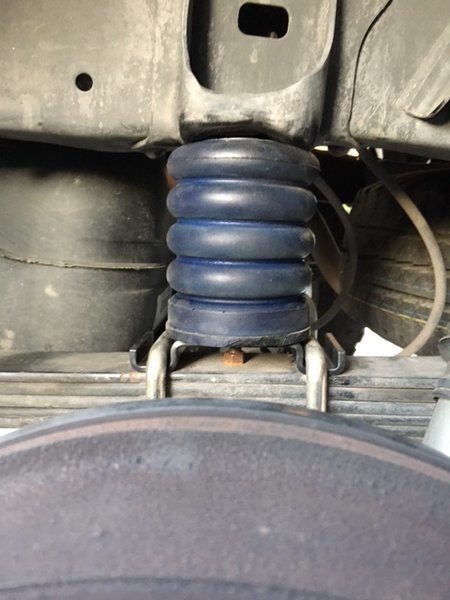

    With the Wheelers's progressive AAL, there's about a 6 inch space between the frame and the leaf pack under the truck's own weight. Sumo springs without the spacers measures about 6 inches including brackets. From my experience, I found that when the Sumo springs are compressed from their normal height of 5 inches to 4 inches, they tend to be on the stiffer side. It's like riding on a single AAL but less of a upward flex as the Sumo springs begin to act like bump stop (that compresses instead of a solid rubber one).
    With the Sumo springs at a constant compressed state, highway ride is stiff. You can feel the back end with every dip, rise, and pot holes on the road. Off-road is similar. You would not want to ride with the Sumo's on washboard like roads on or off.
    Below photos are with the Wheeler's 1.5 inch progressive AAL installed with Sumo springs without the spacers. As you can see, the Sumo springs are just barely fit between the leaf pack and the frame. I have not had this set up off-road or loaded yet but I can say that this provides a more compliant ride. The ride is smooth on the highway. I'll update this again once I had more time with this set up.
