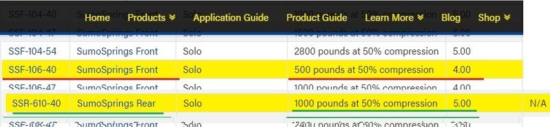

    My neighbor has a stock DC. I'm gonna measure the leaf to perch height but i think the correct application for the sumo springs is to contact the perch at all times unloaded. Also I think it's at 50% compression that the sumo springs are rated to provide the additional 1,000lbs capacity. Depending on the lift height and with overloads, might not get to compress them to that level.

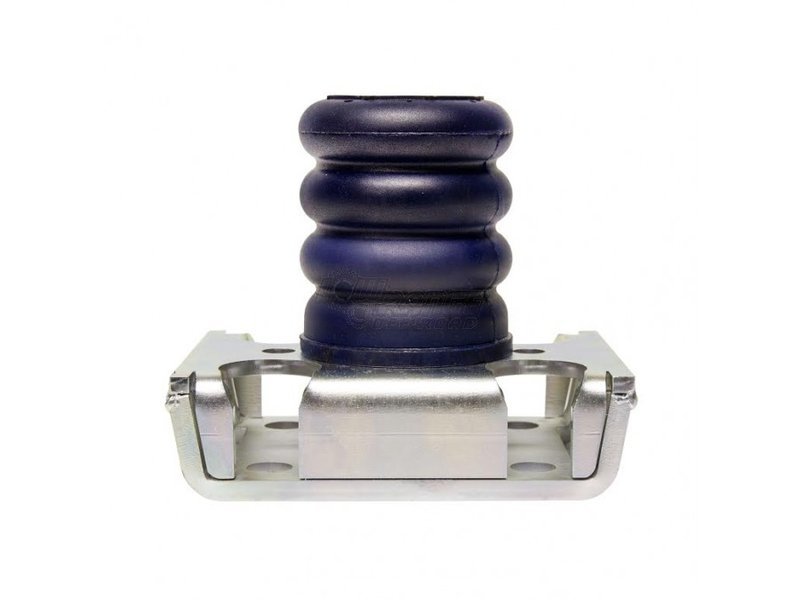

    Interesting. The Low Range kit is basically taller brackets that lifts the Sumo Springs up so it can allow for the flip. The sumo springs themselves are 5" in height. The bracket appears to be about 1.5" in height.

    That is a smaller/shorter sumo spring to make up for the flip plate.
