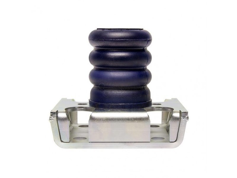

    They sure look like the ones that come with low ranges flip kit, that's what I was pointing out.

    You're right. Low Range's kit has a shorter sumo springs to compensate for the taller brackets.

    The Tacoma and the Tundra basically shares the same Sumo Spring kit though the 1000 lbs kit is already stiff enough as it is. Using something like the 2800 lbs kit would probably feel like riding on solid bump stops.
    Anyway, the sumo spring engineer said that they can't make the sumo springs taller as "they will end up folding over on themselves". While installing, I will have to find a happy medium with the spacers they provided.

    It might if the brackets will fit between the ubolts and welded onto the flip mount.

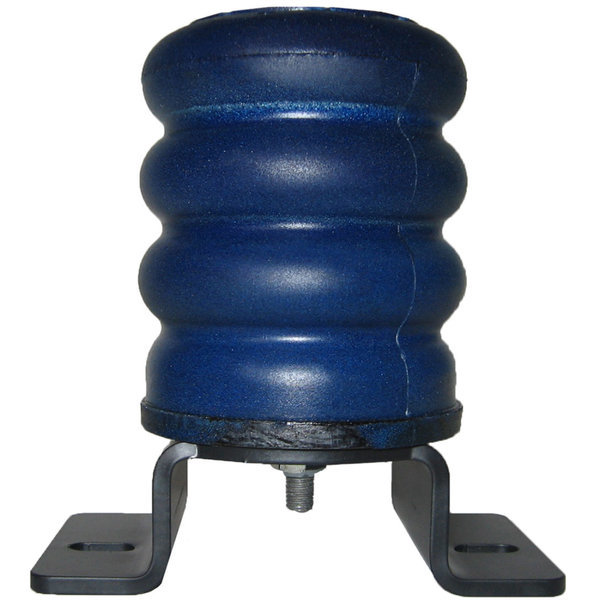

    This is the same configuration but with the softer durometer. Might be a cheaper solution than the low range kit, it certainly looks like the bracket would fit between the nuts on a flip kit, I wonder if the holes would line up to the pre drilled flip plates such as all pro offers.

    Quite a few people in here are happy with the sumosprings, in the stock configuration where they rest on the frame at all times. I think that they are maintenance free appeals to some. We are just trying g to figure out how to employ these in a lifted application.
