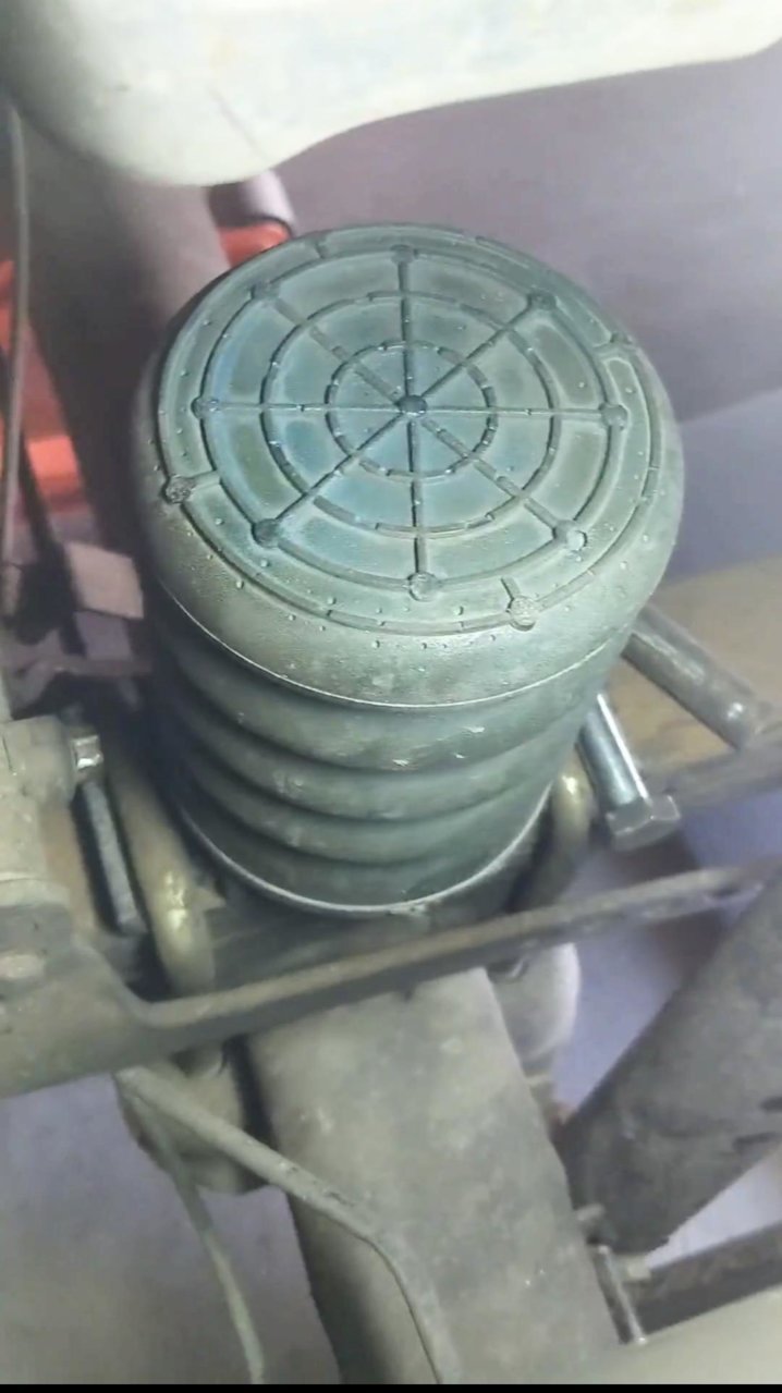

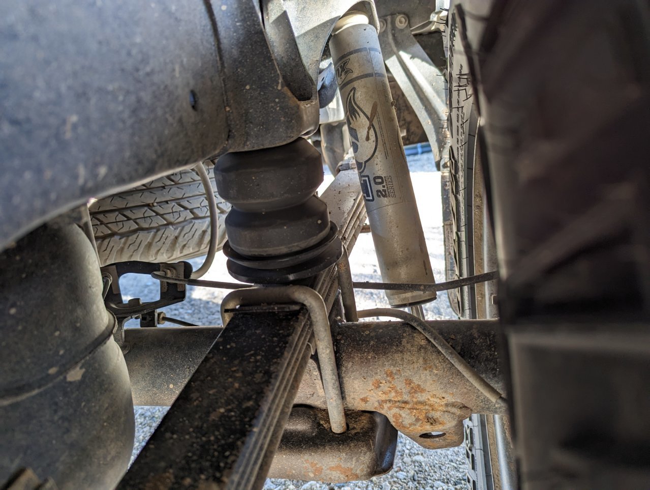

    I found a couple of pictures that might give you an idea of the difference between stock bump stop and a SS. They are both of my rig showing the stock bump stop, right after the recall leaf springs were put on my truck and one of the blue SS when I was installing them.
    Maticuno[OP] likes this.
