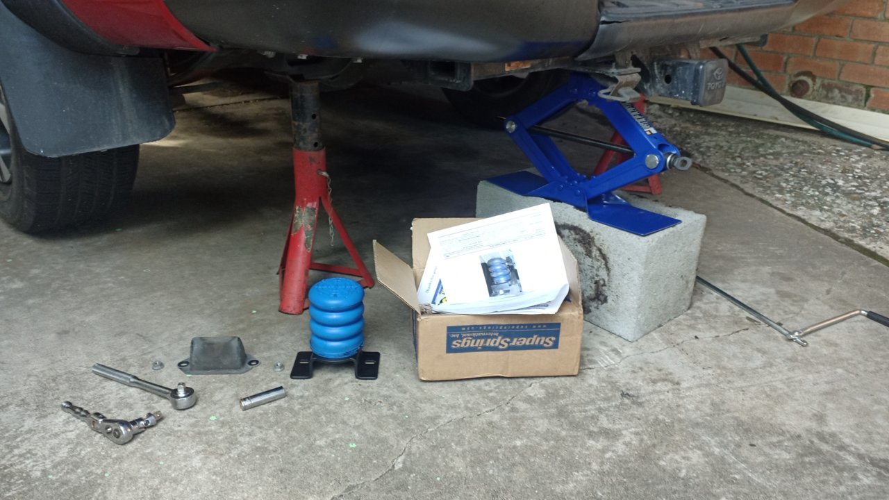

    Tools: jack, jack stands, 12mm deep socket (removal), 13mm deep socket (install), socket wrench.
    I put on the parking brake and blocked the front wheels, but I didn't put on safety goggles, as they advised.

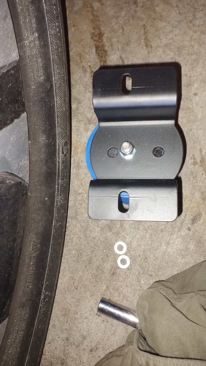

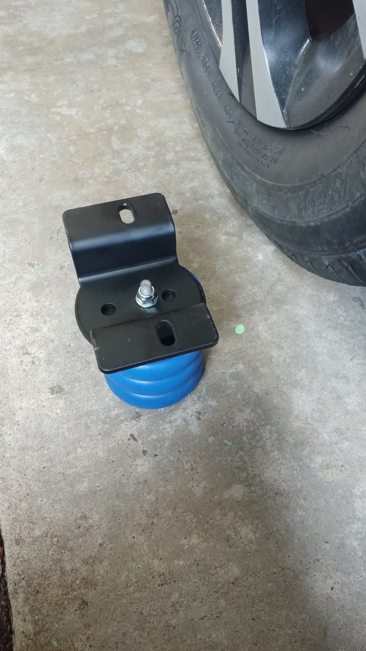

    Now please tell me if I am wrong, but I THINK the offset goes this way for the driver's side.

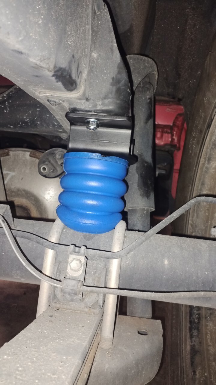

    And this way on the passenger side, yes? I also slid the Sumo Springs forward within that slot before tightening the nuts.
    Set 'er down and the Sumo Springs are lightly touching. I can still slip a piece of stiff paper like card stock into the gap.
    So? Am I doing it right? Expect a performance report in little while. Ride height unloaded was altered less than 1/4".

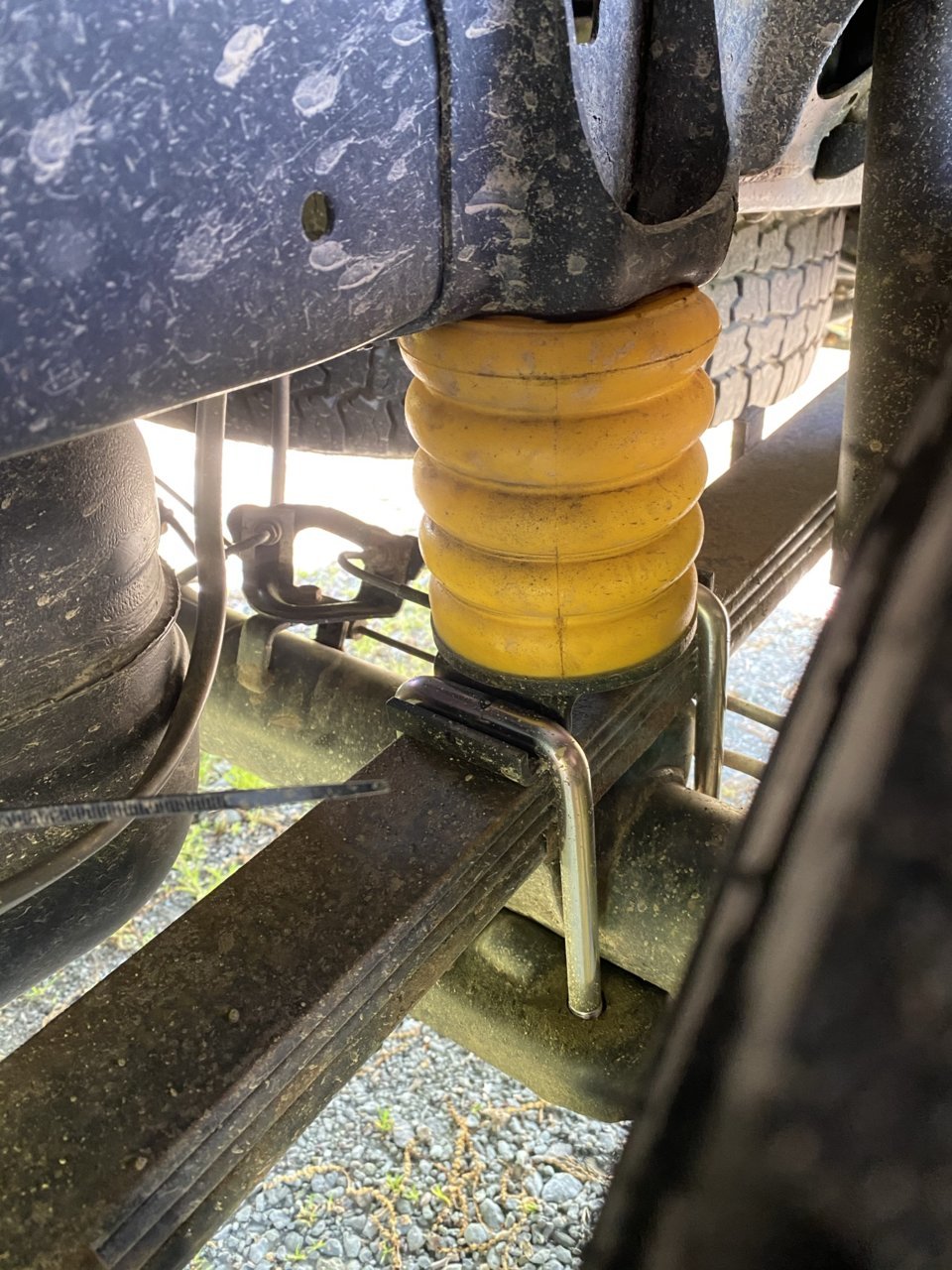

    I installed Sumosprings because I haul a trailer frequently. Sorry I can’t help (mines 4WD), but that looks odd the way they are pushed out of shape by the shackles. Here is the 4WD configuration for comparison. I would ask Sumosprings if they are supposed to be like that.

    For your application (axle on top of leaf packs instead of axle under leaf packs) the slightly touching is correct. As @Nessmuk noted how the sumospring is being pushed out of shape IMO could lead to premature wear and tear on them. They're pretty durable so any wear would be a long time away.

    I think he installed the flat washers in the wrong place.
    Clearwater Bill and Varak[OP] like this.

    I went back to watch the video again and I had stopped watching it right before he put those flat washers between the frame and the mounting plate for the sumospring. Which makes no sense. Always good to take (watch) those videos with a grain of salt and use your own garage knowledge when in doubt.
    Good catch @Jimmyh

    On that youtube video, he definitely installed the flat washers in the wrong place. The guy who made the video acknowledges this in the youtube video comments. The Sumo Springs instructions have a clear exploded parts diagram and also written step-by-step directions that made installation very simple to understand.
    The only thing that was mentioned in that video and not in the written instructions was the offset of the springs on the mount, and how to determine placement on the driver or passenger side. Consult the photos in my original post if you want to see what I am looking at. Please, forgive my ascii diagram, if you will.
    I put the springs like this:
    (_o) [TRUCK] (o_)
    With the bolt and the spring on the inside, away from the road. I did this the same way the guy on youtube did it. I think if I flipped it, the spring would not be centered between the two shackles. Instead it would be hitting on one of the shackles and not touching the other. So I think I did it the right way.

    OME 881 coils with OME nitrochargers shocks up front. TC UCA's OME Dakars with extra leaf in the rear. Warn 8000 winch with 80ft custom braided synth line. Custom 60ft synth extension. All pro tube bumper, Hi-lift jack, Safari Snorkel, Wilco tiregate. 2019 Jeep JLUR.
    Is there no bucket or bottom plate that the bag rests on like the 6 lugs have or is it resting right on the axle?

    Right on the axle.
