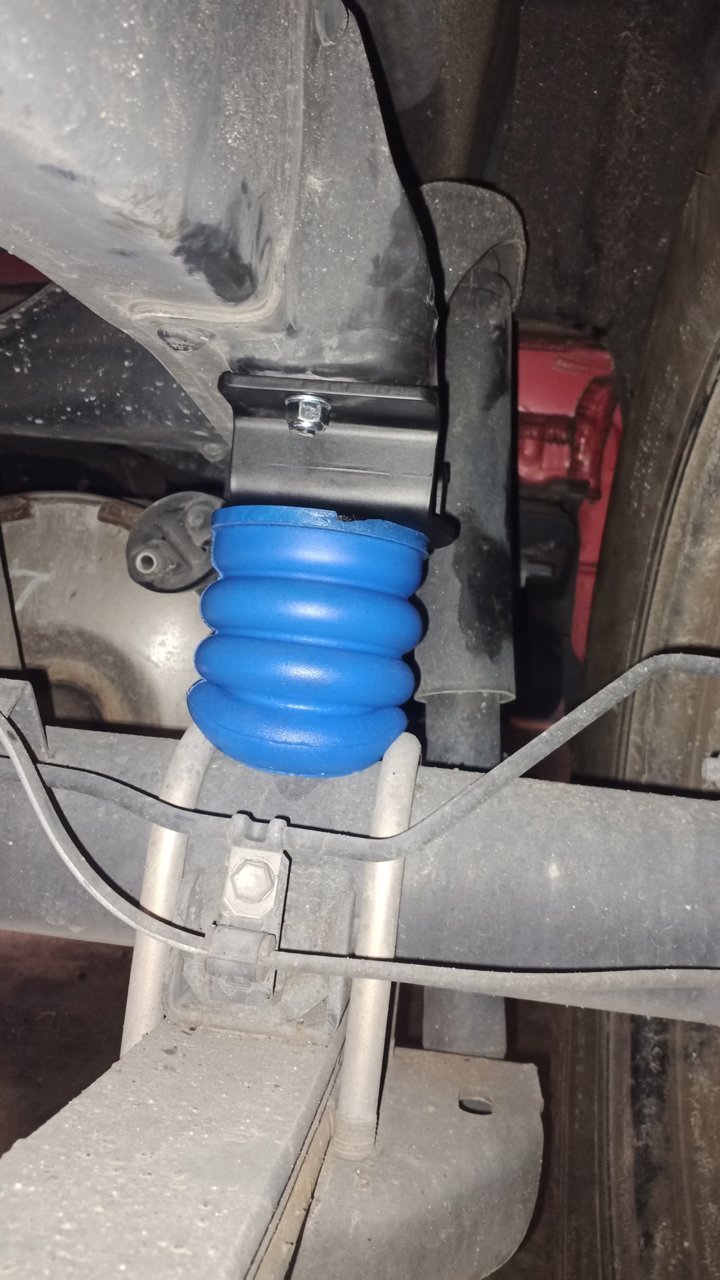

    I have the blue Sumo Springs on my truck. I installed them to help out when I'm loaded up with riding/camping gear and hauling a 5x8' utility trailer with two dual sport or two dirt bikes, or when I'm hauling just one bike on a hitch carrier. They work great in either of these two scenarios. When I'm not heading out somewhere, my truck is still sporting a Leer Cap (180-200lbs) and about 75 to 100 lbs of miscellaneous gear in storage totes. So technically the truck isn't empty. In this scenario, the ride (to me) does not feel comprimised.
    Installing Sumo's with a ubolt/leaf flip has been done, or as illustrated in this thread it was done on a 5 lug base Tacoma.
    https://www.tacomaworld.com/threads/sumo-springs-on-5-lug-base-model-taco.723031/#post-25922862
