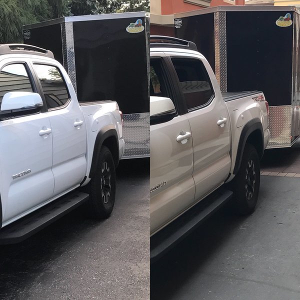

    I got sumo springs also. I am pretty happy with them as the taco sits nice and level. I agree with the harsher ride, and speed bumps are a little wild these days, but it gave me a good 1.5-2 in raise in the rear while towing. And I dont mind the bumps. (Right: before, Left: After)
