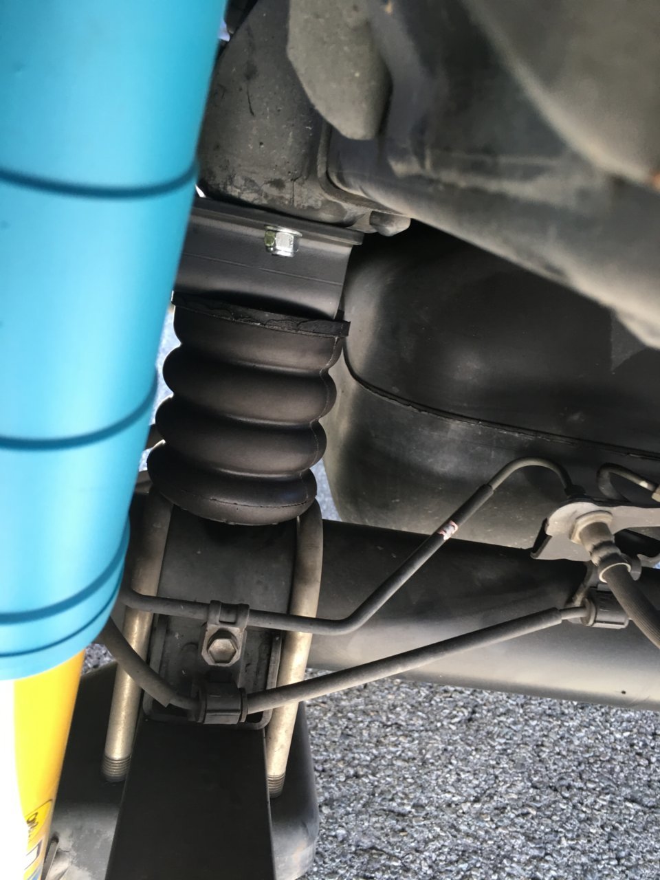

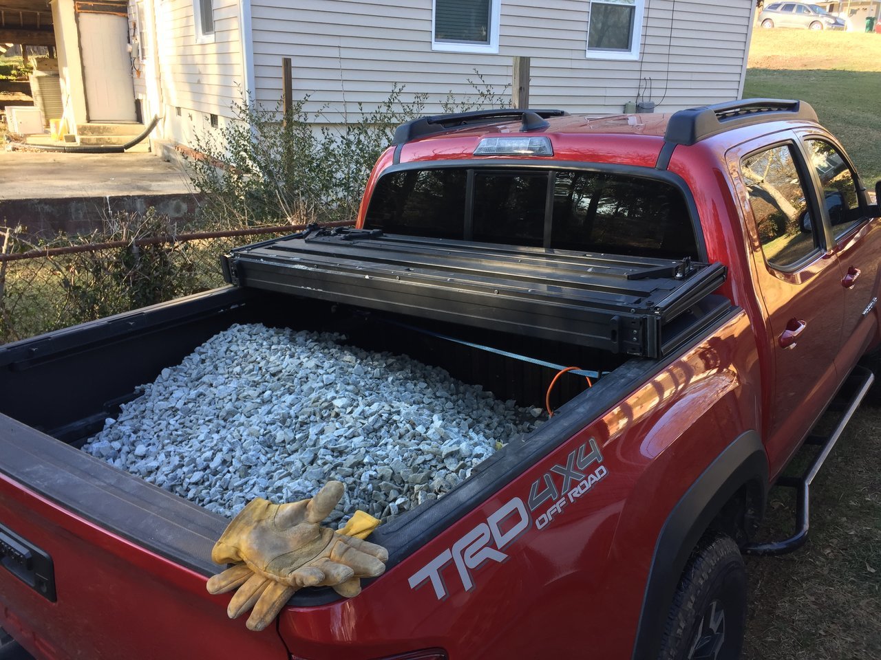

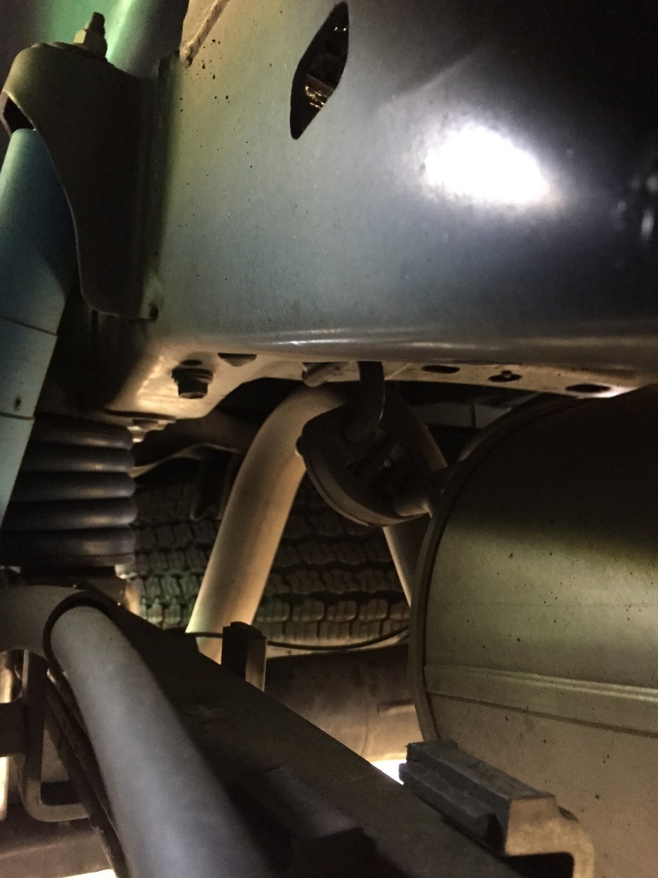

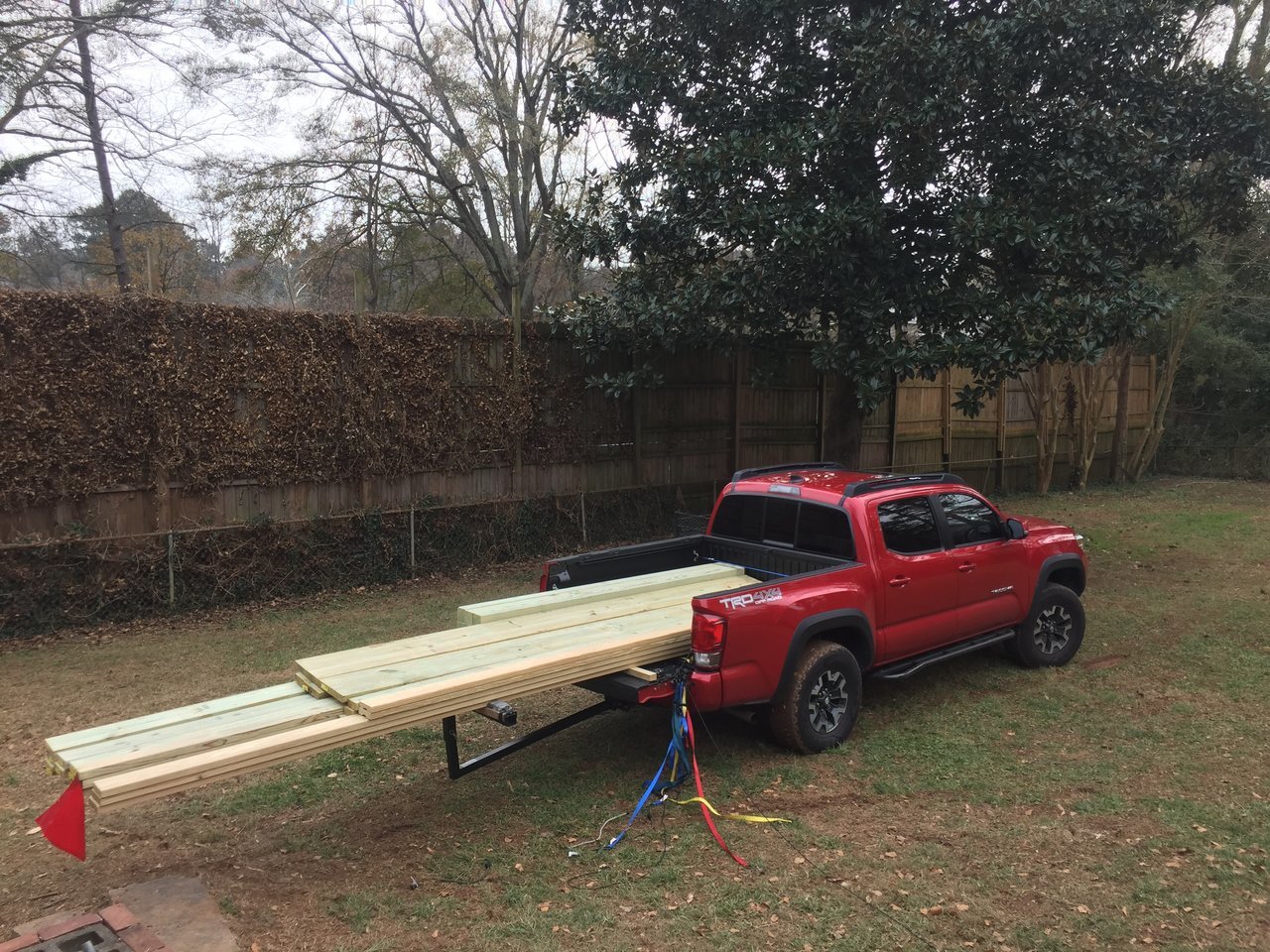

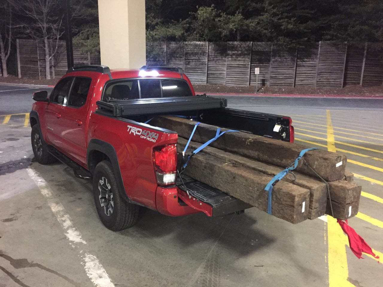

    The 610-40’s are stiff with no lift or additional weight, using the stock shocks. Having said that, I’ve had 1000+ in the bed (for short trips) and they’ve been great. The atv was in the back for 7 hours and it felt better than the stock empty setup. Below shows treated lumber using my hitch extender, 1/2 yard of gravel, 5 rail ties (200-300 lbs each), 4x4 atv (with compression pic)
    C412AA8D-8A96-4FB9-821B-FF6589877618.jpgA7C413F3-9378-442D-B3A9-5BD47F24D533.jpgA3BF996E-34FA-4794-84EC-1B76F741A7C9.jpg

    Is that 20’ lumber? I need some 20 footers and wondered if if was possible to haul.

    It’s 16’. Not sure I’d put the 20’ back there though. You’d need a good amount of ballast to keep them from tipping out of the back.

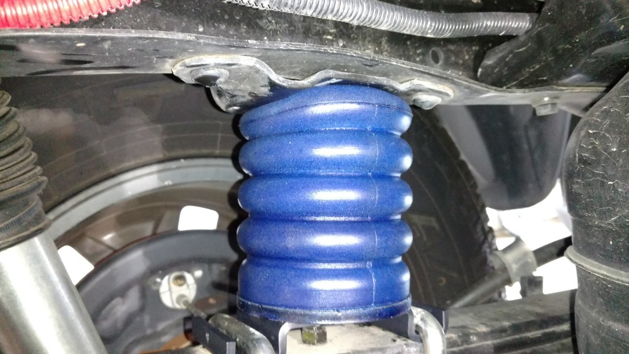

    Hello, I installed SSR-611–47 on my 2010 Tacoma 5 Lug to avoid the squatting. I have been experiencing some bucking after some speed bumps or other Los Angeles potholes and after reading this post, I’ll probably end up cutting the donut so the shocks can do their job FFC25F18-272E-42B8-BBC4-6D43DA8F35C2.jpg
