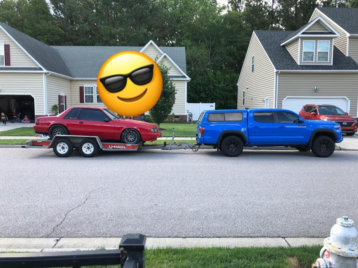

    How do you like them? I think I’ll kill the trigger after getting 2” of squat towing my car

    Perhaps it's just me, but your trailer looks to be a bit front loaded.

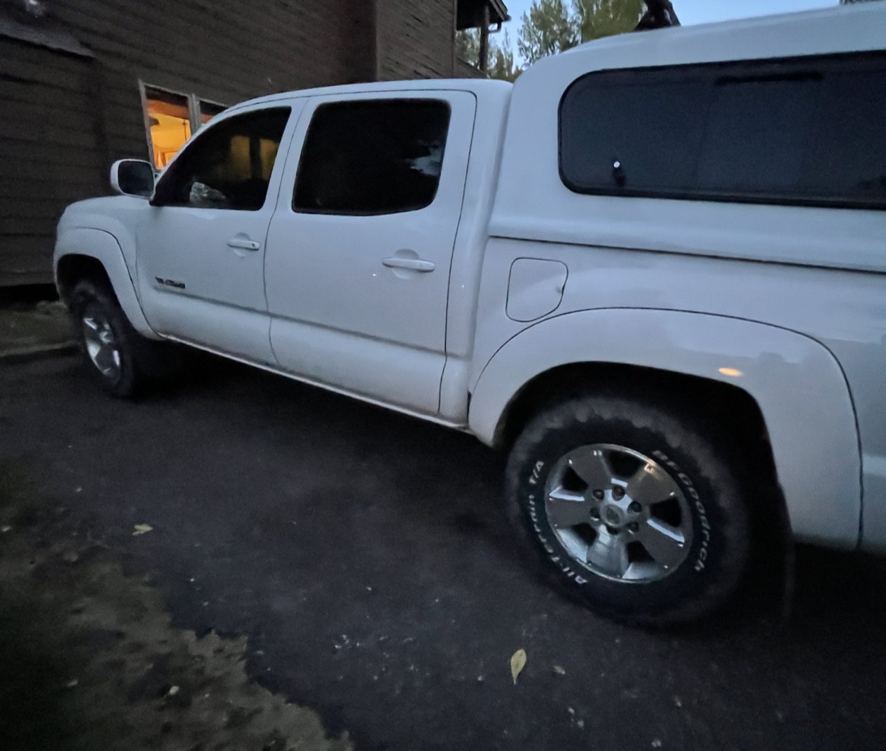

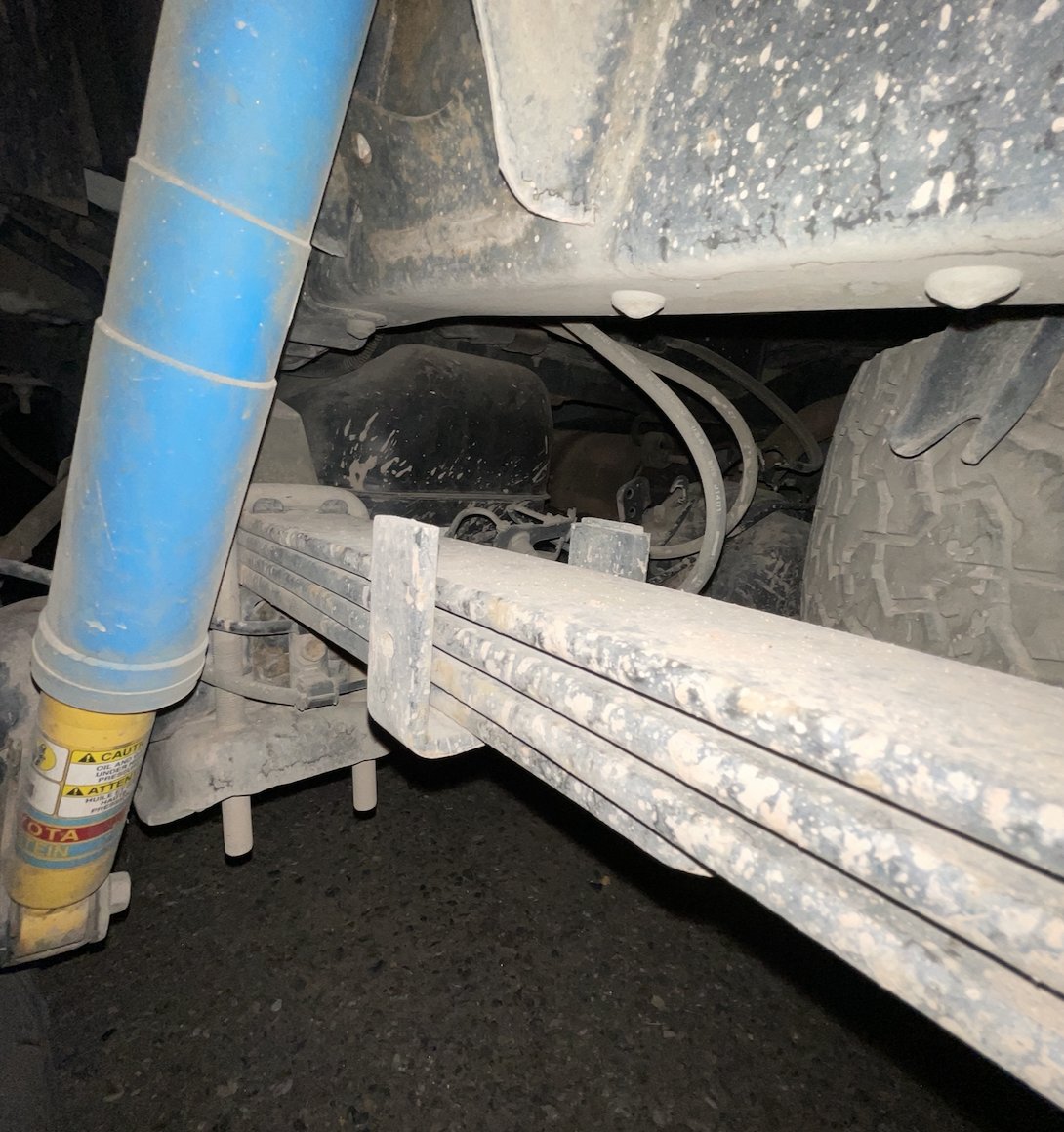

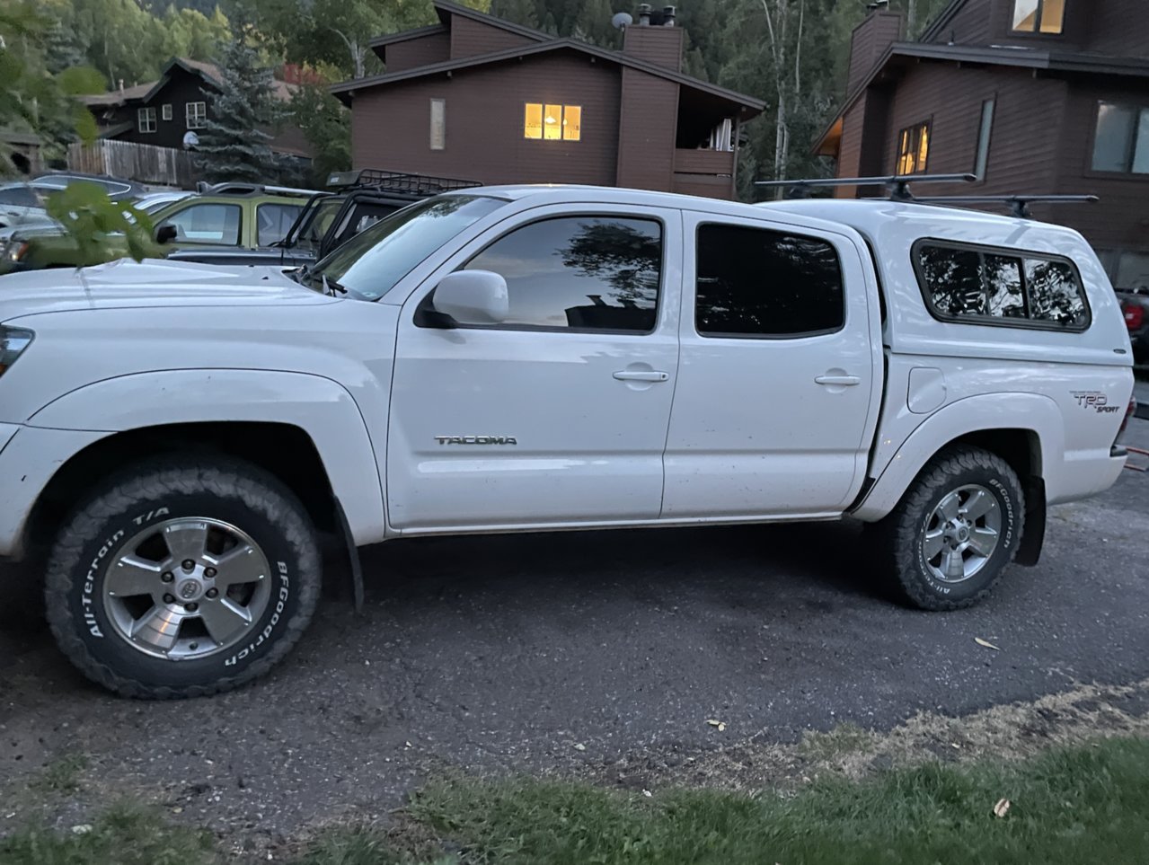

    I am trying to make these decisions as well and I'm having a tough time! Hoping someone with some Sumosprings experience can offer some guidance. I have a 2011 DCSB/TRDSport, I did upgrade and put on a Take-off leaf pack from a 2018 OR ( 3-leaf pack) but with my Snugtop topper and camping gear in the rear I get serious sag, and there is nothing worse the the feeling of slamming that bumpstop when I am off-road or getting to a campsite on a FSR. So - I would like to fix the sag and have a good riding truck, but I don't want to put on a big lift or invest a lot of money... The SSR-610-40 seems like a good option, but with the weight I have back there already it seems like the frame will be sitting on the Sumospring. On one hand I will get some small lift and fix my sag, but on the other I will get a "thud" and render my rear suspension/shocks kind of useless since there won't be that 1" gap between frame and Sumospring.... But I really don't want to deal with air bags and hoses/valves... And I don't want to spend 500$+ on new Dakar leaf pack etc...And Toytec told me an AAL would not be a good fit for fixing this sag and they might break... So should I just keep it stock and deal with slamming my bumpstops with full load or should I get the SSR-610-40???

    Riding with sumo’s hitting the frame constantly is nowhere near as bad as the factory bump stops, but it is still very uncomfortable. You will absolutely be sitting on them and maybe even lifted a bit by them. Your best bet it to pony up the money for airbags or aftermarket springs like the Dakar’s you mentioned or Icon RXTs. I recommend the icons. If you run setup 1 with the shell it shouldn’t lift you much and it’ll ride nice. I ran setup 2 in that config with 1.5 front lift and it kept factory rake and I liked the ride a LOT better than when I was sumos only.
    You can’t cheap out on the Tacoma’s rear suspension and still get a nice ride out of it in my experience
