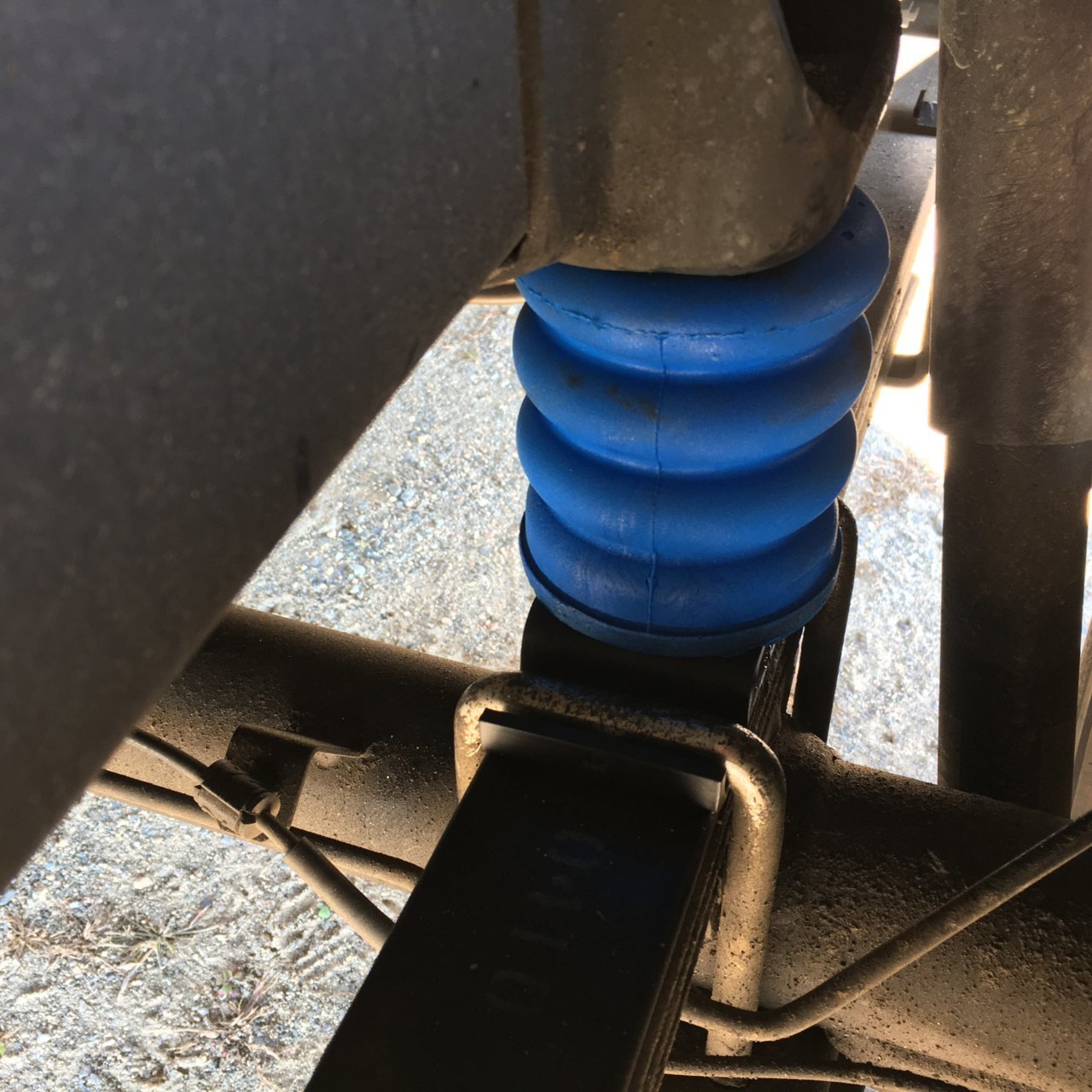

    Installed SSR-612-40 on 2020 SR 4WD V6. After 500+ miles found that suspension stiffness was only slightly noticeable. If I didn’t know Sumos where there I probably wouldn’t have noticed additional stiffness. More noticeable is less roll on turning at road speed. Will be testing with load and towing soon.

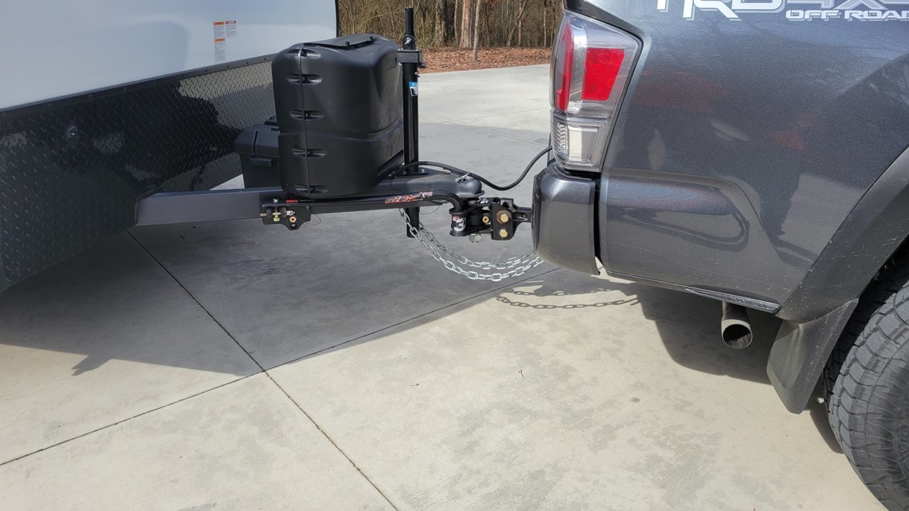

    I have a very similar camper and a weight distribution hitch is the way to go. Get one with built in away control like the Anderson or the Camco ReCurve R3(what I have and love it). I bought my R3 off FB marketplace for $250 and have the 1000lb arms(most common). I highly recommend a hitch that allows you to back up without unhooking and has built in sway control. The R3 and some others allow you to be able to back up without unhooking anything. I have passed oncoming 18 wheelers at 60mph with zero sway.

    Not sure which WD hitches with chains you mean. But, I have an Andersen hitch that uses chains instead of bars and they can be backed up without unhooking anything.

    Thanks for correcting me. Apparently some of the WDH's use chains and still allow backing up without unhooking. I'll clarify my post.
