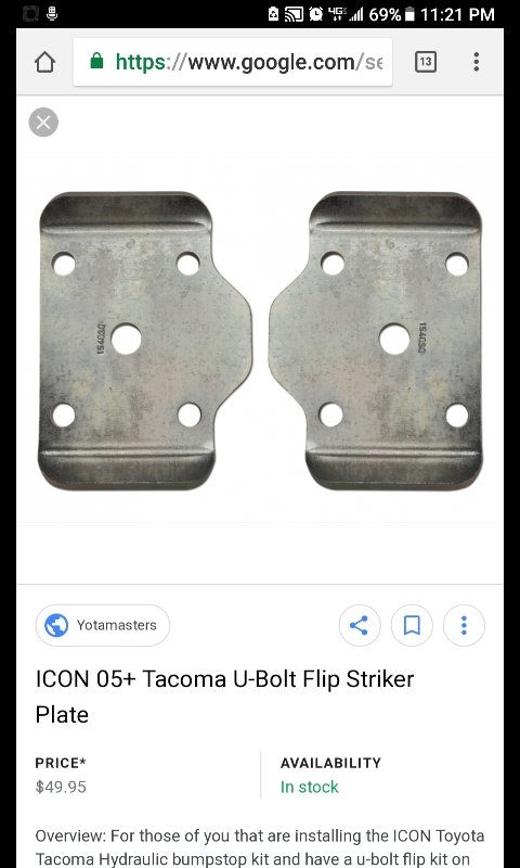

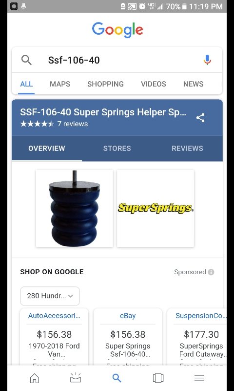

    I have these,
    going to mount inverted to the frame bump strike area, and either replace the factory bump with icon strike plates,
    or I might cut the factory bump down to a square top to adjust for height needed. Also have poly spacers that i ordered with my front wheelers superbumps that I didn't use, may insert between the sumos and frame to space the bump lower.

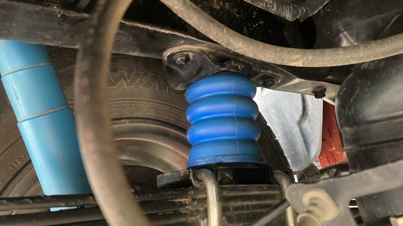

    I just installed the 612-40 sumo springs a few weeks ago. I have an ARE CX cap and noticed some sagging when I would load up for camping. With just the weight of the shell, these just start making contact with the frame. I haven’t had a chance to check sag with a lot of weight in the bed, but they do help a lot with body roll on the road. Overall ride is no different than stock so far on pavement.

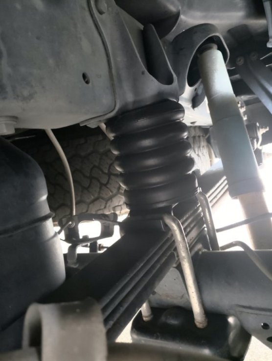

    Initially I had the 47's and they didnt stop sag when I hooked up my trailer. There was a gap between the 47 and the rail. The 750lb rating is at 50% compression, which is about 1 1/2" sag min.
    I had a 5th spring added and all leafs were dearched to maintain a 36" rear wheel opening height Kept Sumo spring in with no gap. Great setup, I tow a 20 travel trailer with an 600lb tongue weight, canopy and 500 lbs in the bed. Truck drops no more than 1" before adjusting with equalizer bars.
    Ride is slightly rougher, doesn't feel like a car now.
