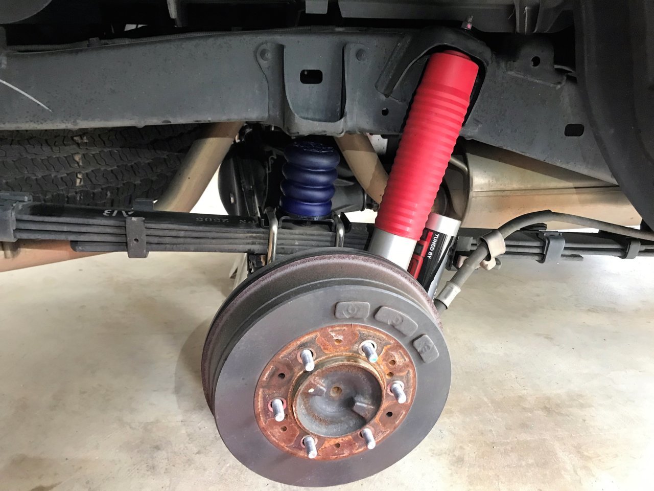

    I installed them on my 16 TRD OR with PRO shocks. The ride quality is really quite good, even hitting bumps and RR tracks. Have yet to tow my boat with the Sumo's but will find out soon. I did hook the boat trailer up, and while hooked the Sumo's are in contact with the frame. While not hooked to boat trailer there's a good 1/2 inch gap between the Sumo and frame. Will update after towing on the road.
    This photo shows much more gap due to the truck being on jack stands.

    I went with the ones specific to my year model, 2016 3rd Gen. Part # SSR-612-40. These have 4 rolls, where the SSR-610-40 has 5 rolls. The 40 is the load capacity or density rating. With 40 BLUE being the softest, then 47 BLACK being more firm, then 54 YELLOW being the most firm. I didn't want my truck to feel harsh when the frame makes contact with them, so I went with the 40's. Very pleased with them so far, can't say anything bad about them. Honestly I don't even know they are there until I hook up the boat, then they go to work holding the rear end from sagging so much. Hit this link and read up on them. https://www.supersprings.com/products/sumosprings/

    Either ones will work on your truck. It's just depends on what you want them to do for you. The 612-40's I went with have about a 1/2 inch gap between the Sumo and the frame without any load. The 610's would more than likely be in contact with the frame all the time. Can't imagine your 2013 frame being much different from my 2016. Maybe they changed the frames from 2nd Gen to 3rd Gen, I have no idea about that.
