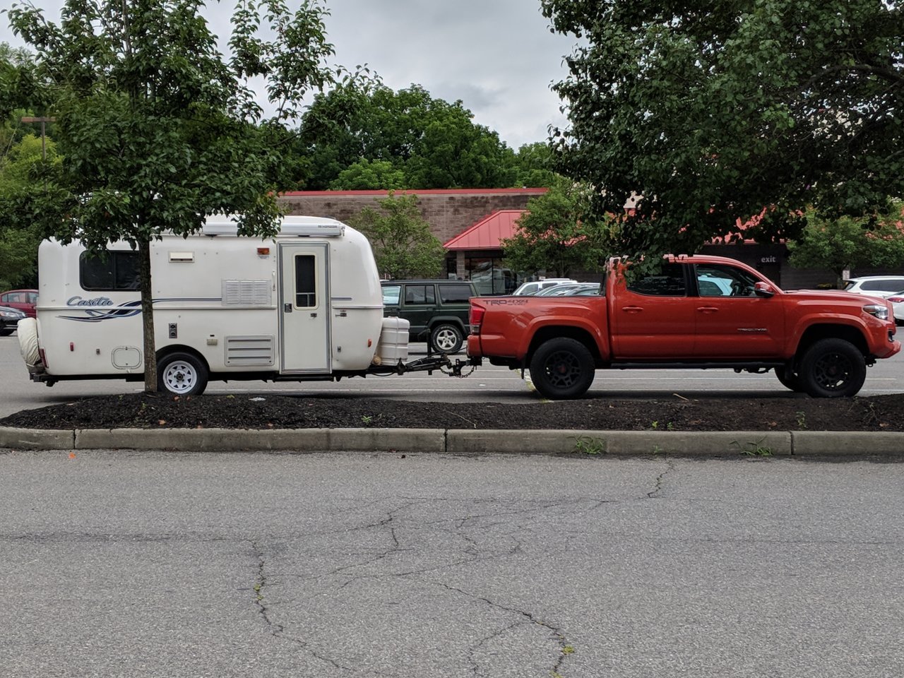

    In this pic it looks like you have a weight distribution hitch? It looks pretty level.

    I don't use a WDH. I am already at Max payload and the Lance dealer said to try it out with out it because it adds 90lbs. I have been on 2 6000+ trips and have almost 20,000 miles of towing this trailer and it works great. My trailer is pretty small. 7' wide and about 3700lbs loaded.
    The rear sags about 1.75 inches when I hook up with the Sumos. I did however buy firestone air springs but have not installed them yet. I intend on getting the sag down to 1" with them. Also I have a 2" lift with AAL in rear and still have some rake when empty.
