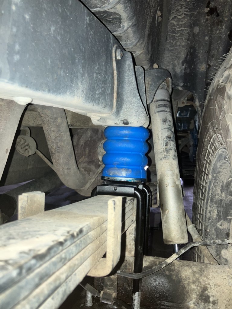

    This is how the blue SS look like on my truck.
    I used several "C" clamps on the leaf pack and then loosened the U bolts enough to remove the old bump stops and then install the SS.

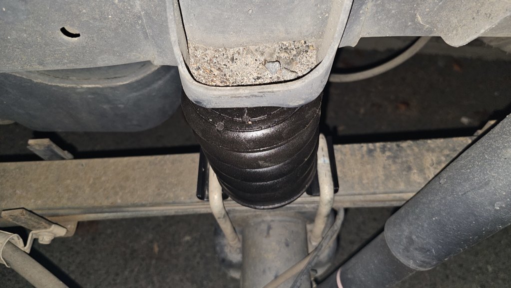

    I removed it when I installed my Sumos.

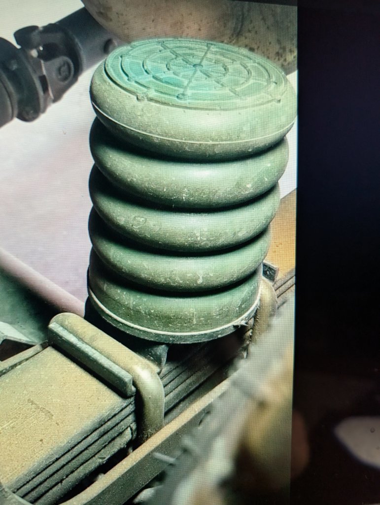

    If you're talking about this bracket, I left them on.

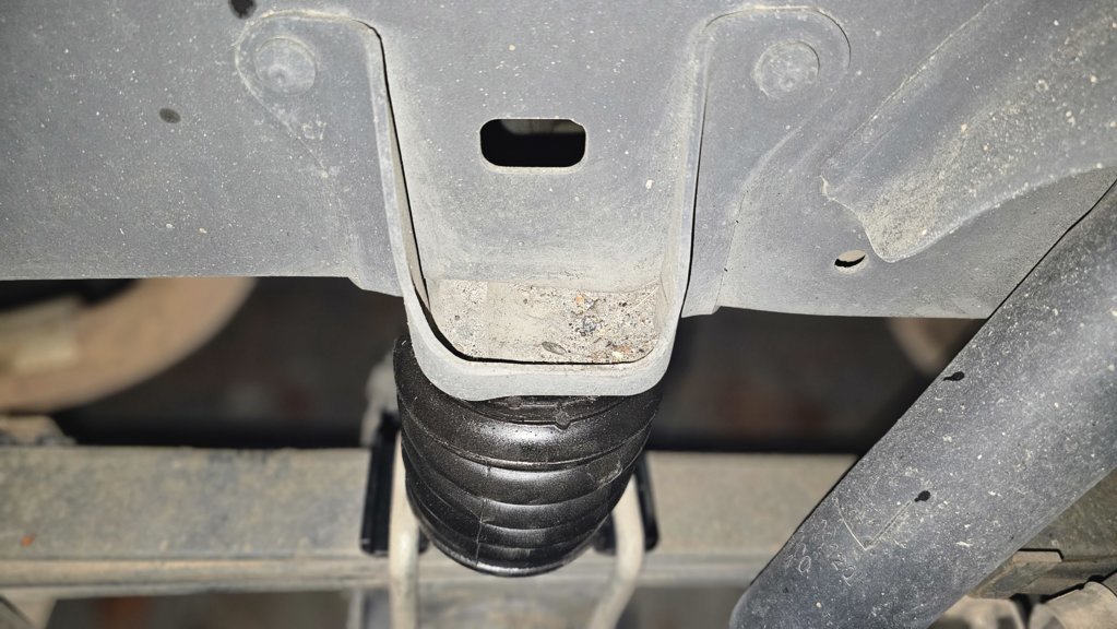

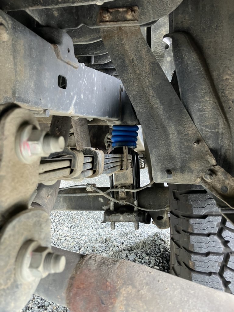

    Here is a photo of mine with new-ish recall leafs.
    I believe that stock bracket on the frame rail is supposed to mate together at compression.
    Photo with slight compression and another on level surface.

    The springs in the second pic are the General Spring HDs. I am very happy with that choice.

    Mine did the same thing with recall leafs, it rested on the frame all the time. It took replacing the springs to get what I wanted. The sumos only come into play now when I have a load in the bed.

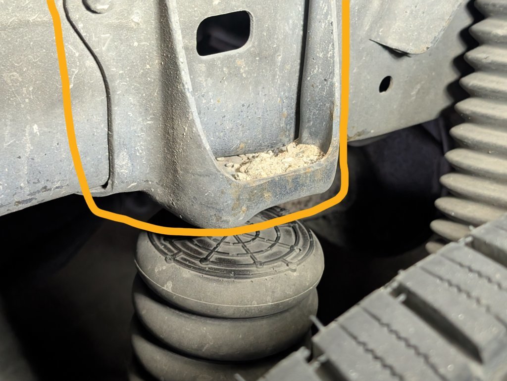

    Awesome! So I got mine on today. The passenger side fit nice, but the driver side hung over a little. Think it's ok? Hopefully it's at least ok for driving tomorrow. I can mess with it more after work tomorrow night.

    Think I'm ok with mine not lin20241003_204255.jpg ing up completely?

    Do not pull anything off the frame.
    The stock U bolts can be reused. Yes ideally you bevel the inner edge of the sumo spring bracket so the ubolt pulls tight across the top.
