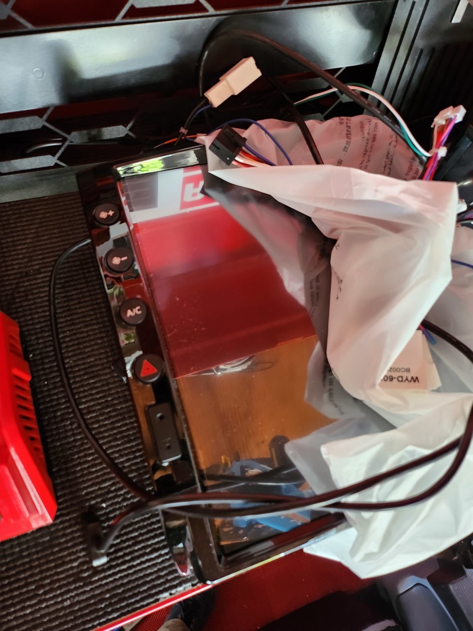

    I did! It's sitting on my bench right now!

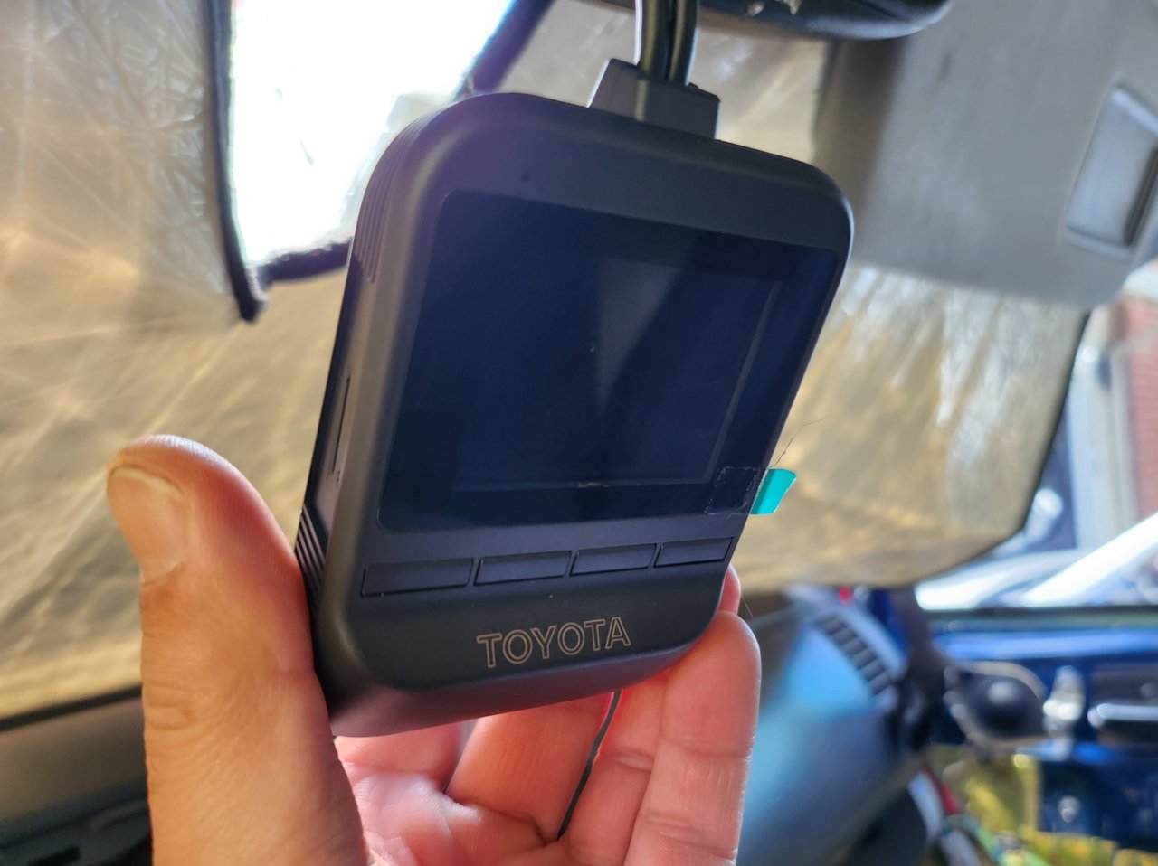

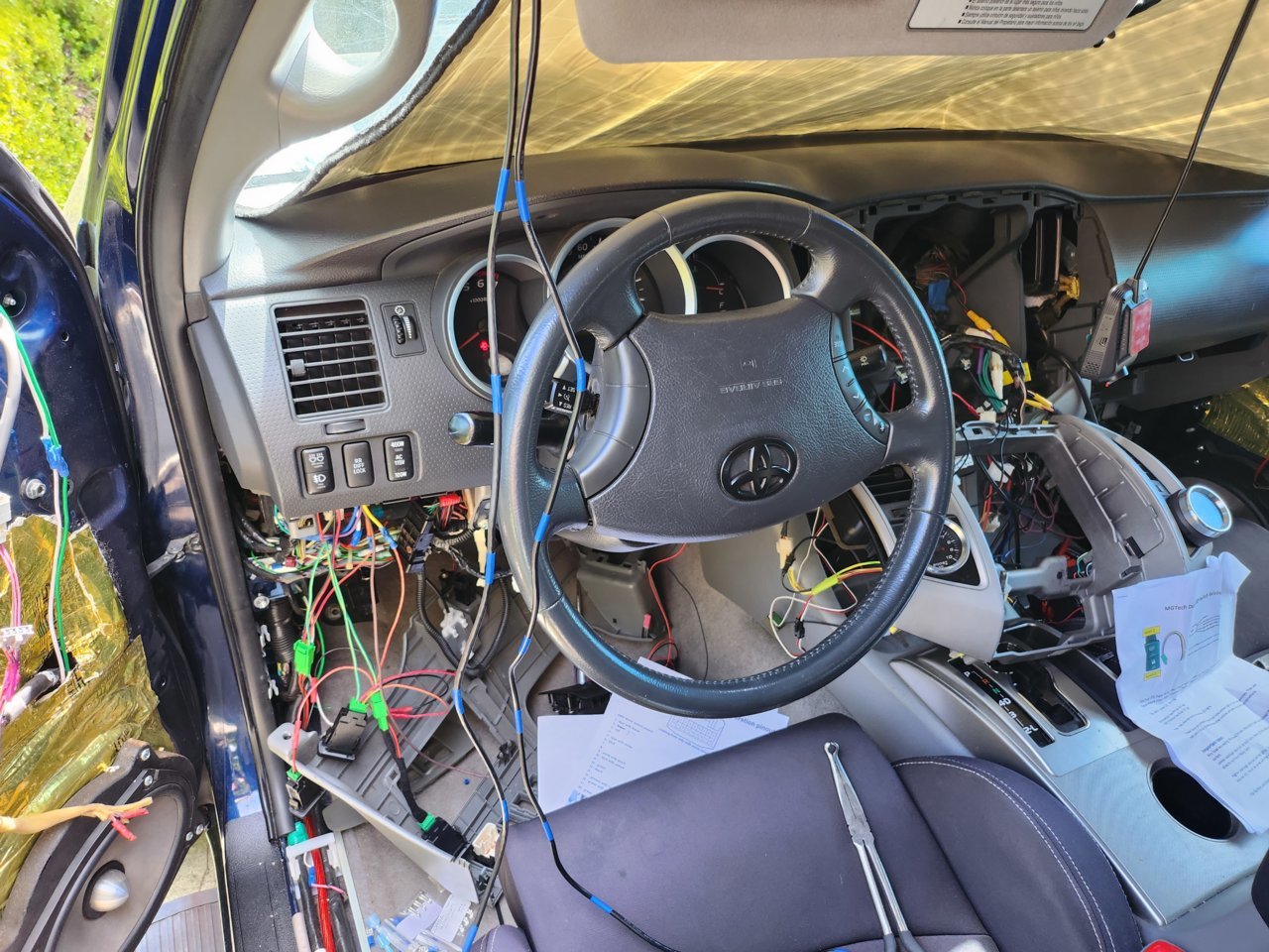

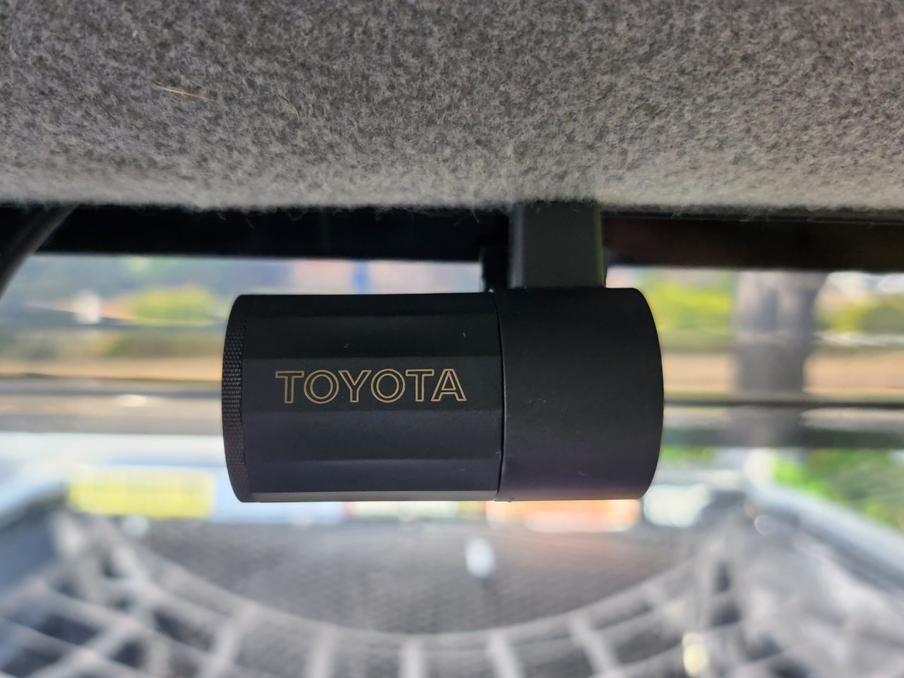

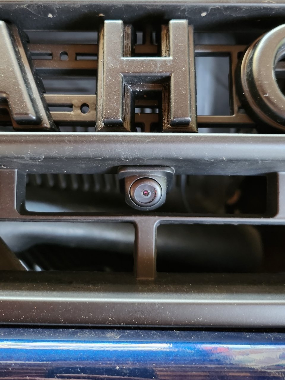

    But I am putting in work! Along with the planned install of that head unit, I'm rewiring a bunch of crap again, but also installing a front grille cam, and some cool genuine Toyota front/rear dash cams that came from Toyota Thailand.

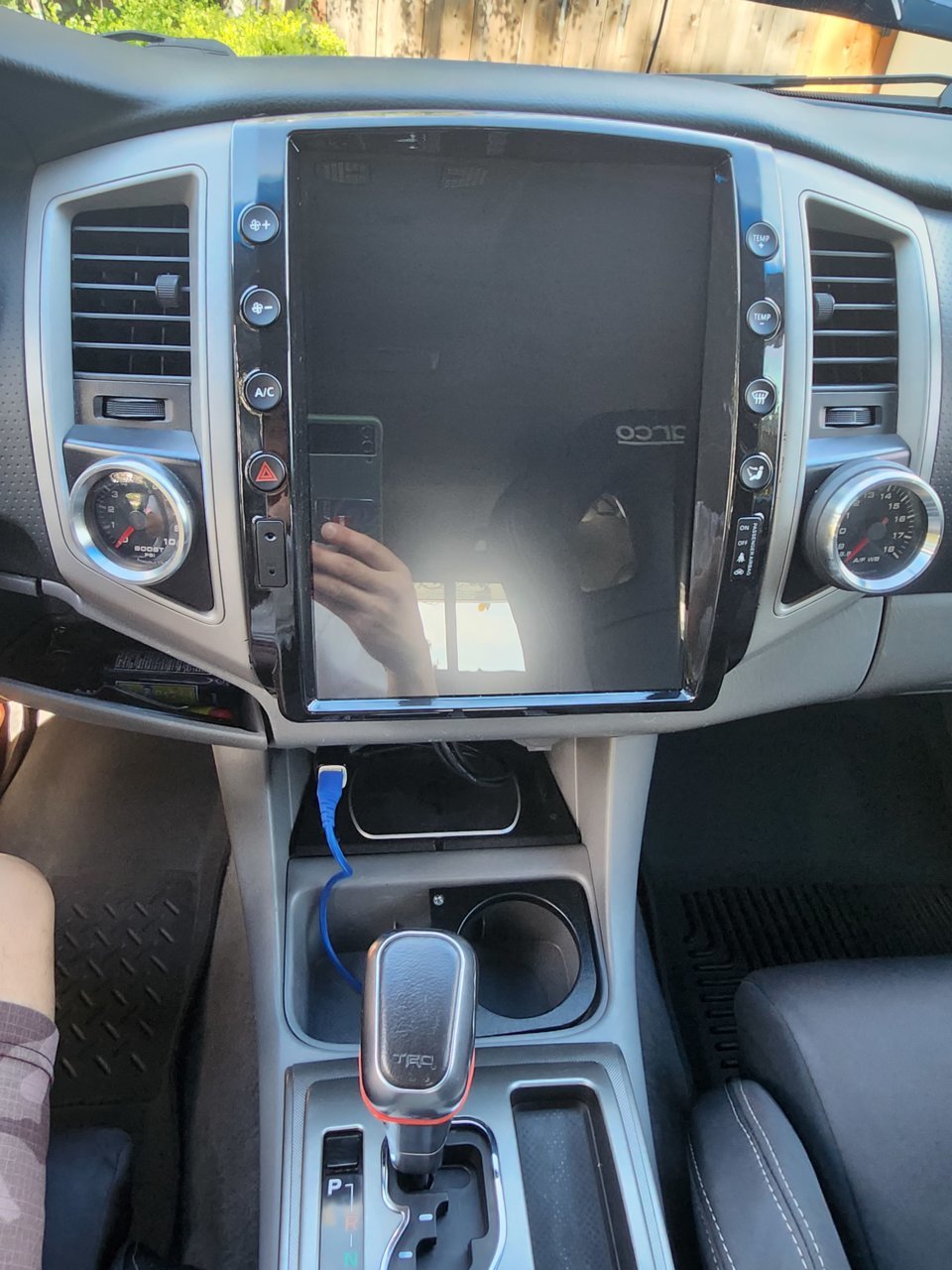

    The monstrosity is installed. I haven't gotten some functions working and still learning the interface but so far so good.

    The AuCar unit has digital hvac touchscreen controls plus those push buttons on the bezel surround. I'm still learning all the do-hickies but I appreciate the redundancy of the two hvac controls methods. Out of all the different tesla-style head units, the difference is mainly the buttons/functions on the bezel.....and I preferred the AuCar one.
    I still need to figure out why my front and rear cameras are not working. And also figure out how to tie in the OBDii.

    AUcar Tesla Style Headunit has been installed. I'm still working through some functionality but I like it so far. I'll love it when I get all the functions I want working like they should (SWC, cams, etc).
    But apps, music quality, digital hvac.. all working quite nice!
    Also got the front and rear Toyota dash cameras up and running. This device is sold in the Toyota Thailand/Vietnam Southeast Asia market.

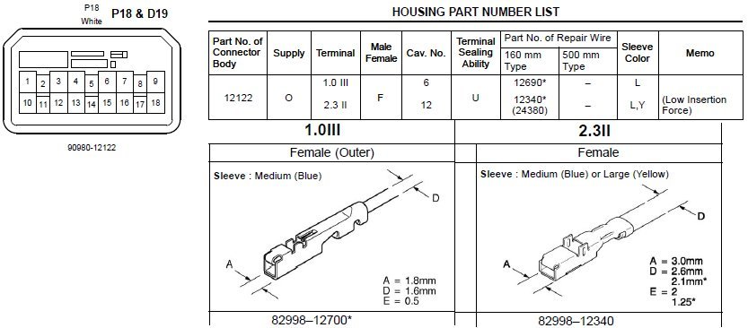

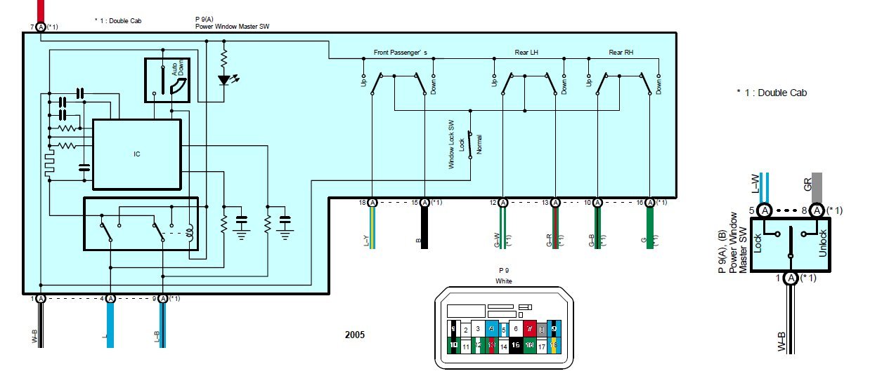

    I feel the same way. My wife's Highlander has it which made me want to upgrade my truck. I bought the kit and started having buyers remorse because I roll my windows up/down frequently and didn't know if I would be fumbling with the switch more than I liked.
    But after installation (de-pinning was the hardest part), the one touch window switch is growing on me.

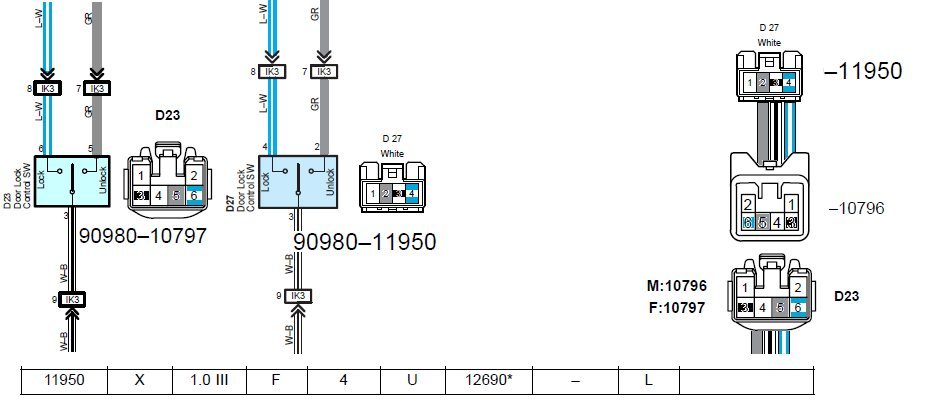

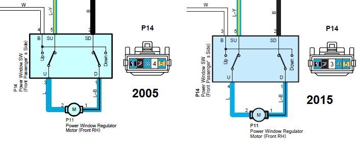

    There were a lot of hokey how-to threads on the window switch conversion. But @caribe makaira came through with the master window switch wiring diagrams of Gen2 and Gen2.5 and with that, the retrofit was a cinch.
    If I have time, I'll do a write up, etc
    Driver side
    P/N for pins and harness connectors
    Passenger side
