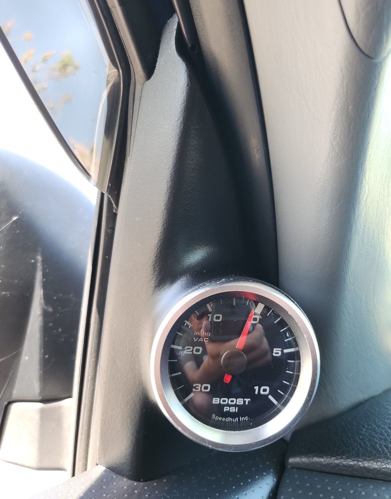

    Although I would like the tweeter up higher, my door pillar wing has my boost gauge so I can't mount tweeters there. I thought about doing a custom mount behind the A-pillar cover but that would probably need a custom grill cover. I also thought about mounting them inside the A/C vent but naw....

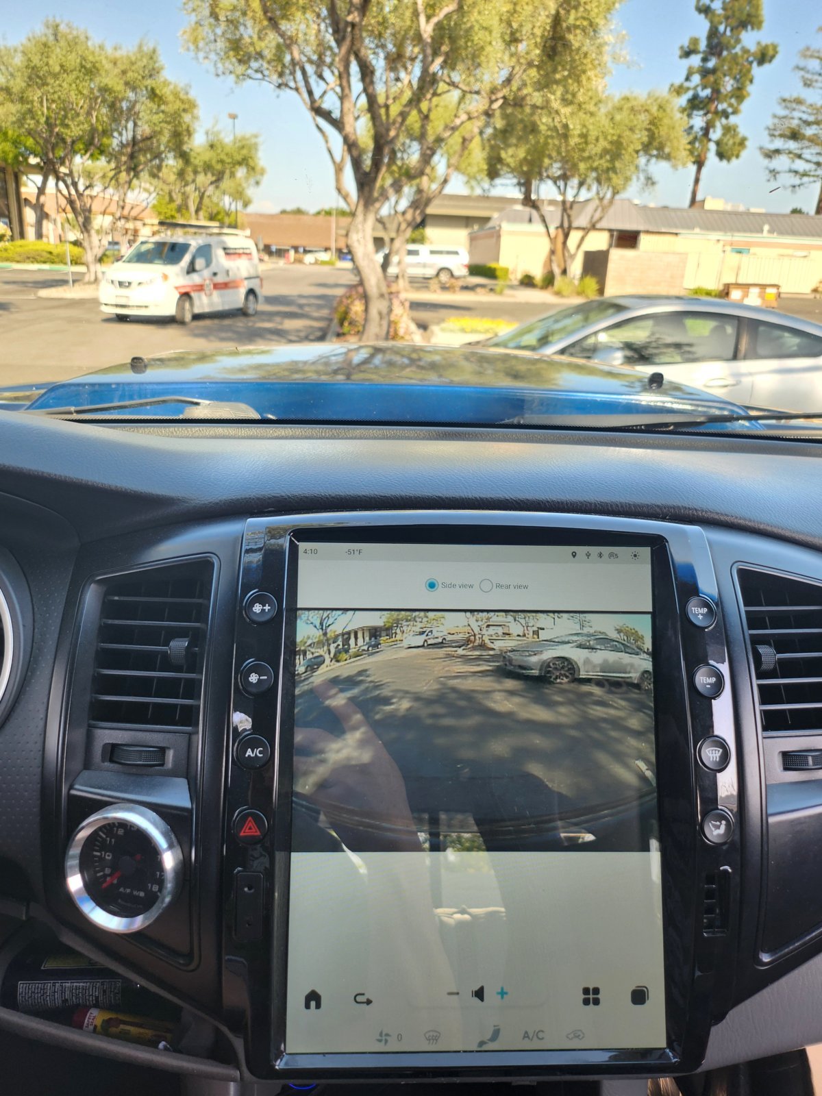

    Besides the sheer novelty of having one, the front camera view is growing on me and I can spot things in front of my truck that I can't completely see from my stationary sitting position.

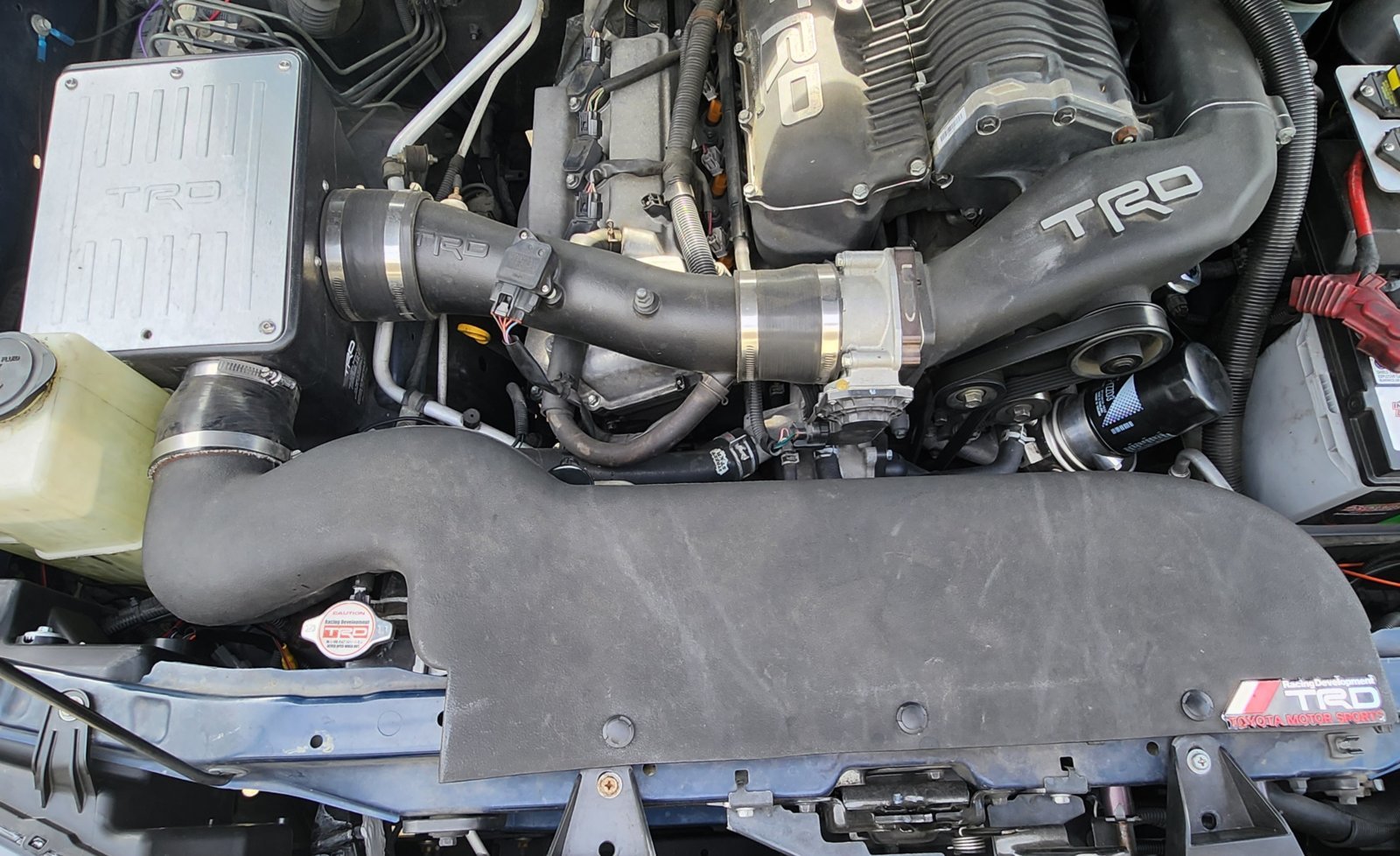

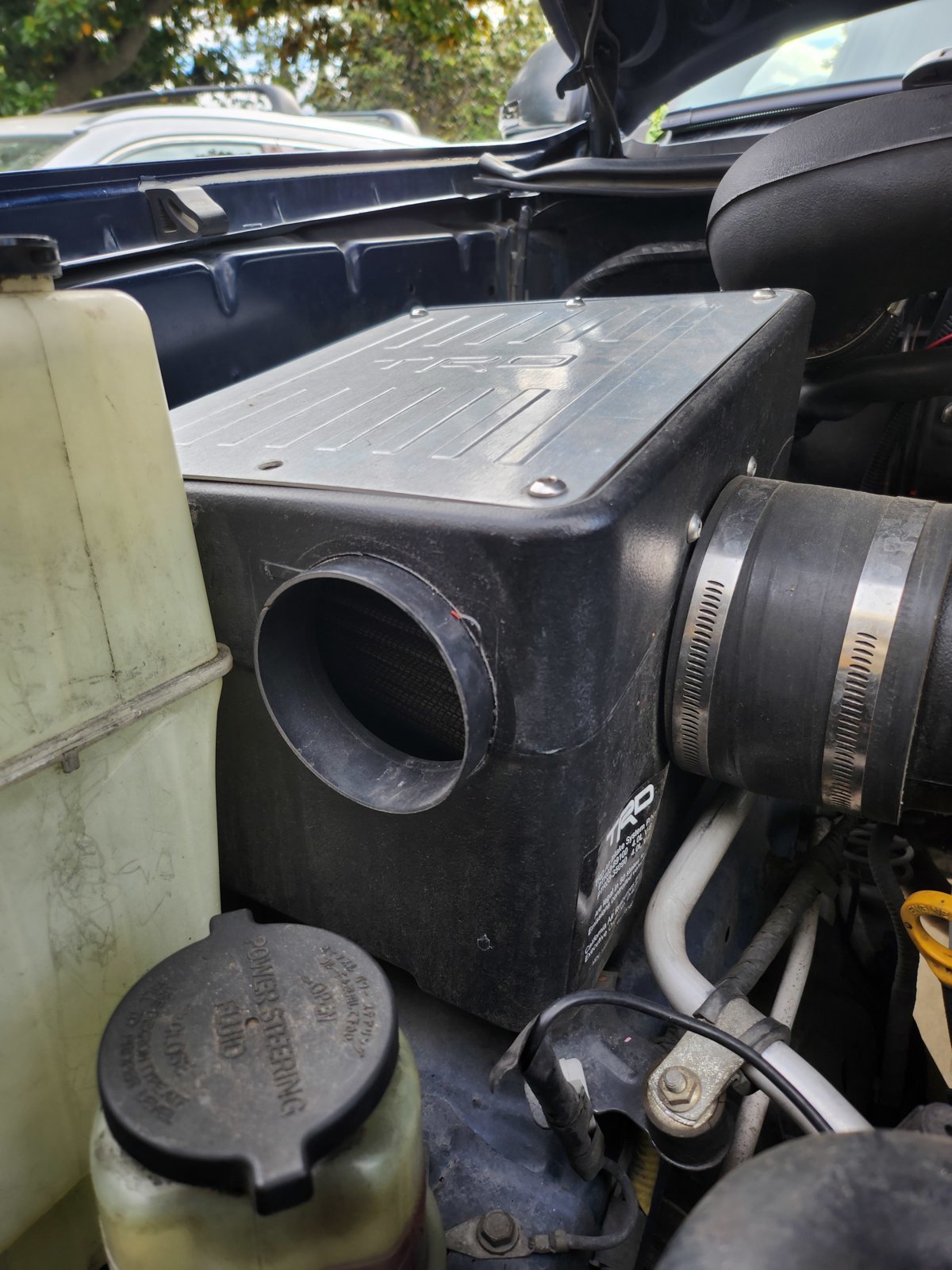

    I've cleaned up Page 1 of this build page for better navigation, etc. And I've wanted to be better at documenting with photos.
    So here's the 1st item for photo journaling. My modified TRD Gen1 Cold Air Intake system. I hole-sawed an opening in the TRD airbox and attached (inside airbox) a Nissan MAF adapter which is essentially a 2.5-2.75" diameter of piping with a 4-bolt square flange. A Volant Air Intake Scoop is joined to the TRD airbox with an angled silicon step hose.

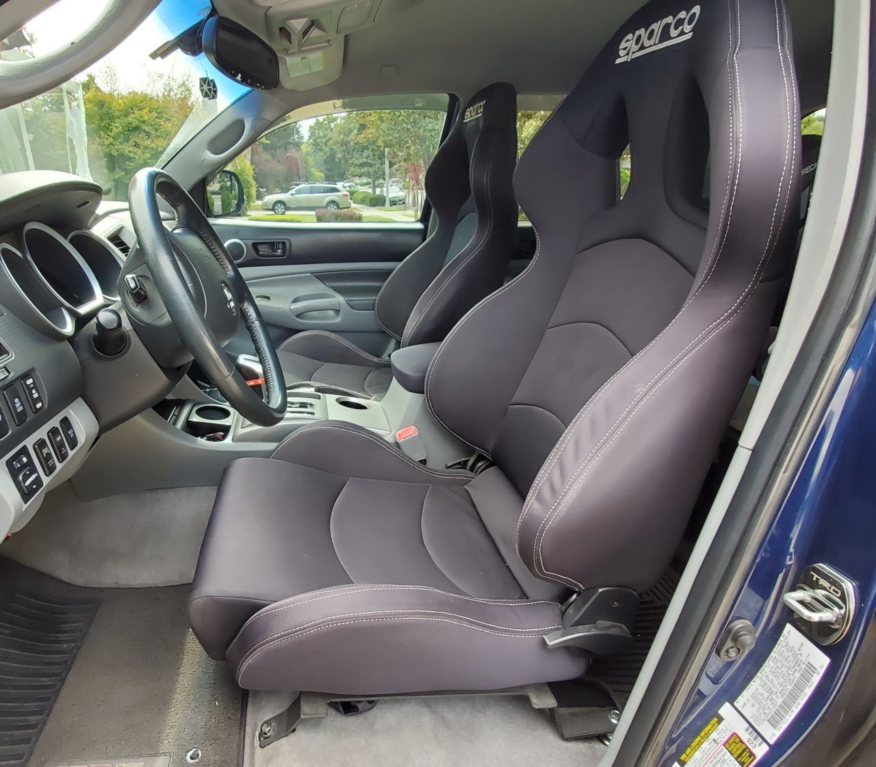

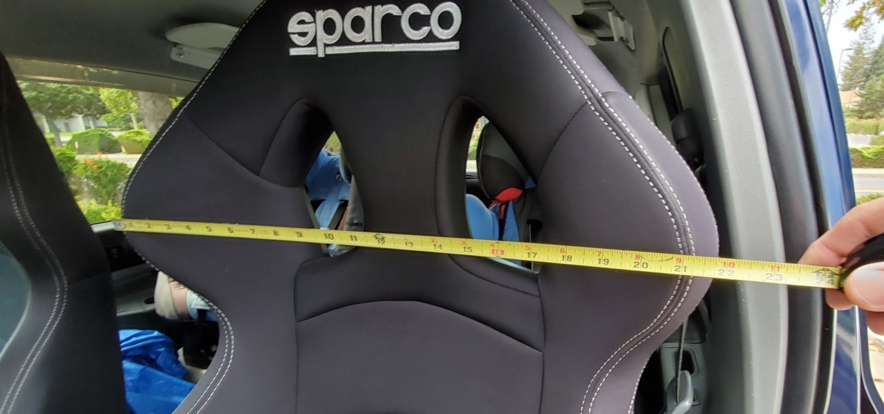

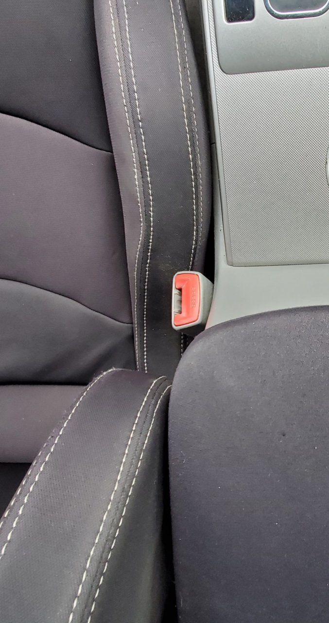

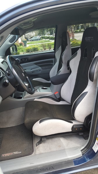

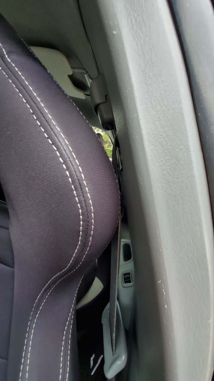

    Back when my truck had the Corbeau Torino/R600 seats.
    Currently, it has Sparco Chrono Road seats. The Sparcos are much wider and larger compared to the Corbeaus.
    20201006_130735.jpg 20201006_130603.jpg 20201006_130823.jpg 20201006_130858.jpg
    If I recall correctly, I'm using Corbeau bottom seat brackets redrilled for the Sparco sliders and seat bolt pattern. I'm not satisfied with the seat bracket as it sits too low in the back and I'm having to stack fender washers to raise it. Oh well.....

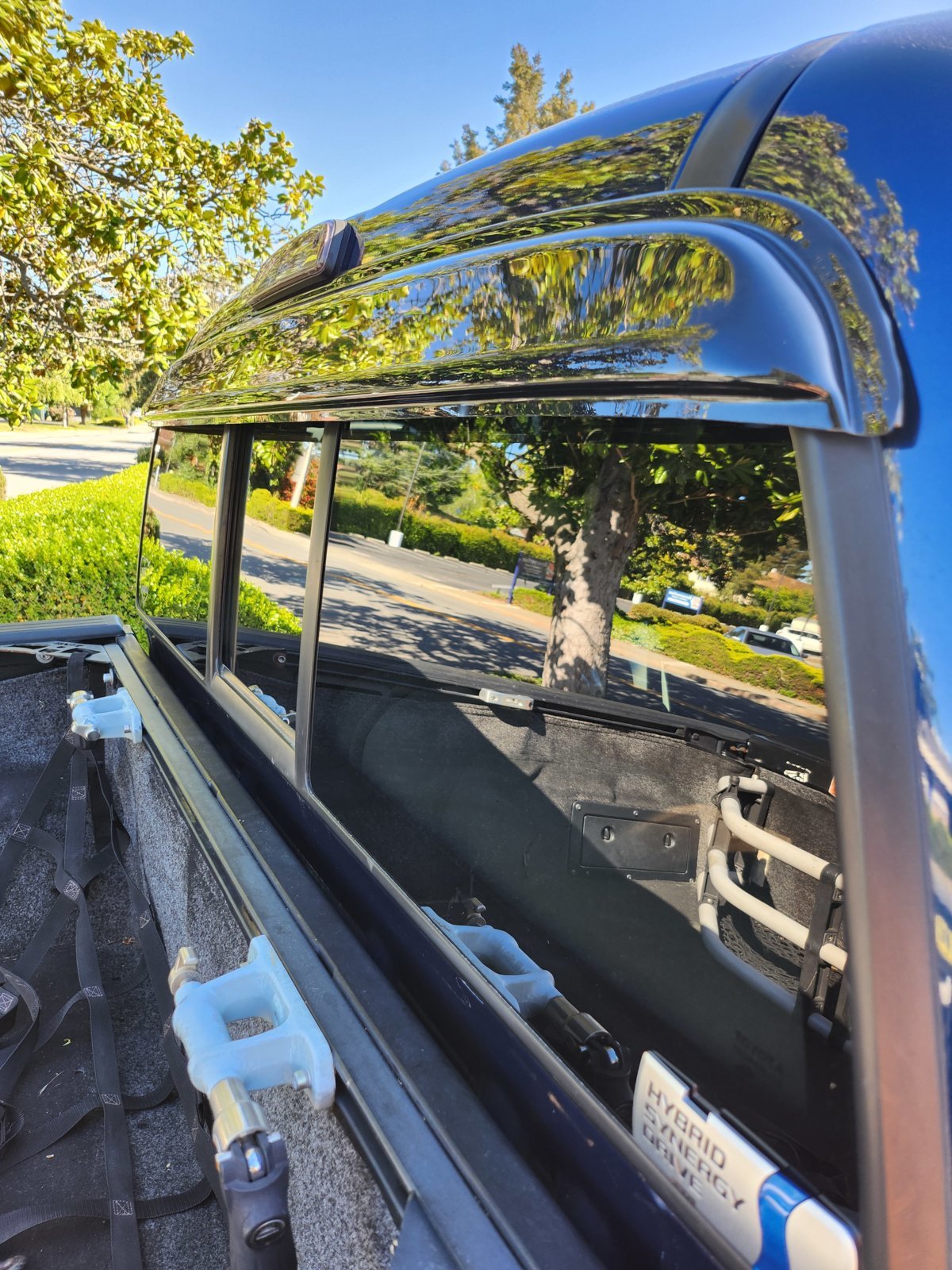

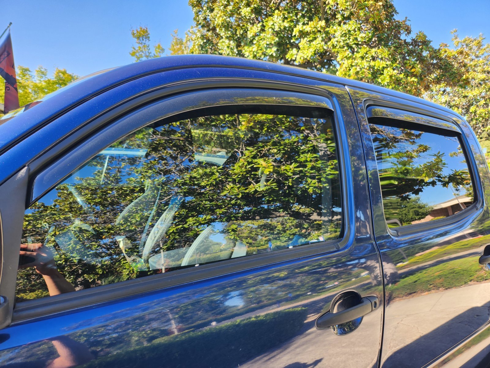

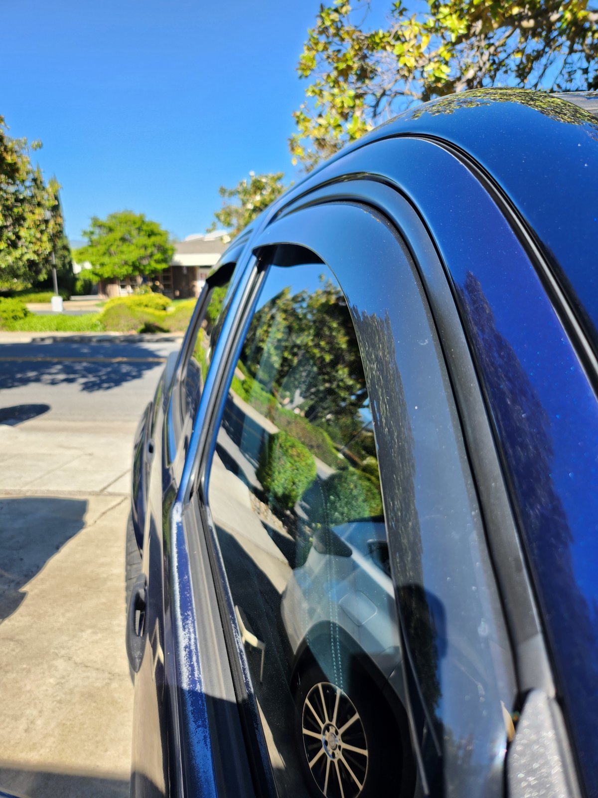

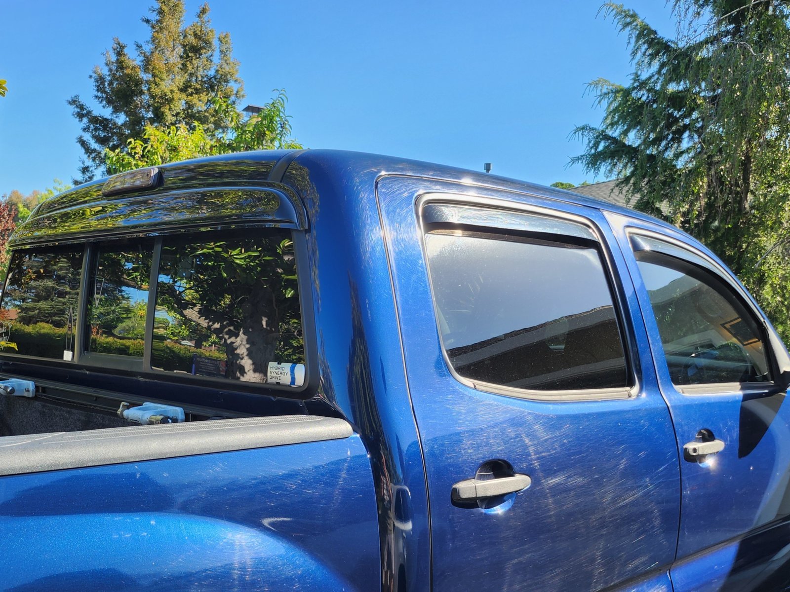

    AVS In-Channel Window Visor and Rear Window Sun Deflector.
    20240510_091107.jpg 20240510_091007.jpg 20240510_090950.jpg 20240510_091219.jpg
    The rear window deflector isn't everyones cup of tea but I was looking for continuity along the upper window glass to flow with the in-channel visors of the doors. Also, I believe the rear window sun deflector is now NLA from AVS so I'm glad I was able to get one. Now I just need to make sure I don't crack it.

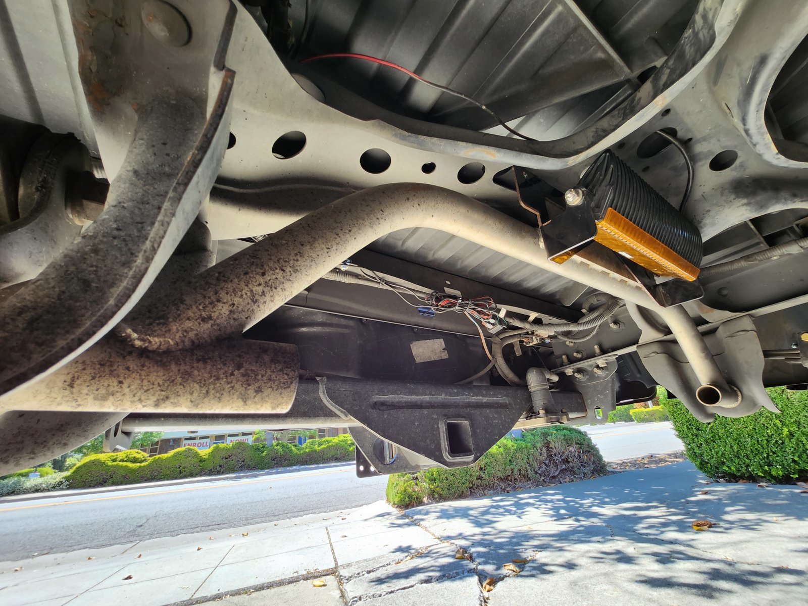

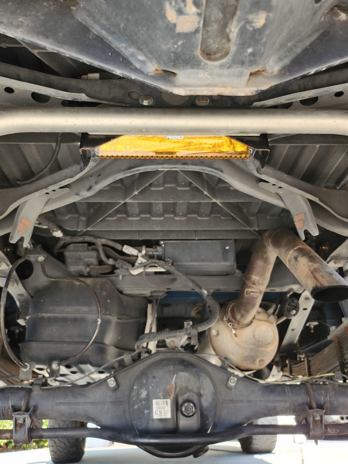

    A non-transferable item from my Gen2 to Gen2.5 facelift project was the hood scoop LED bar bracket from C4 Fabrication. It's a bracket to stuff a 10" single row LED bar into the hood scoop on the Sport models. It is also NLA from C4Fab and because of that, I didn't want to part with it especially since it was paired with a Rigid SR LED bar that had minimal usage.
    ....so I bought a Rigid amber lens cover and repurposed it as a rear fog light.
    The @sshole in me wants to mount it lower, without the lens cover and clock it straight at any potential tailgaters and rumpriders.

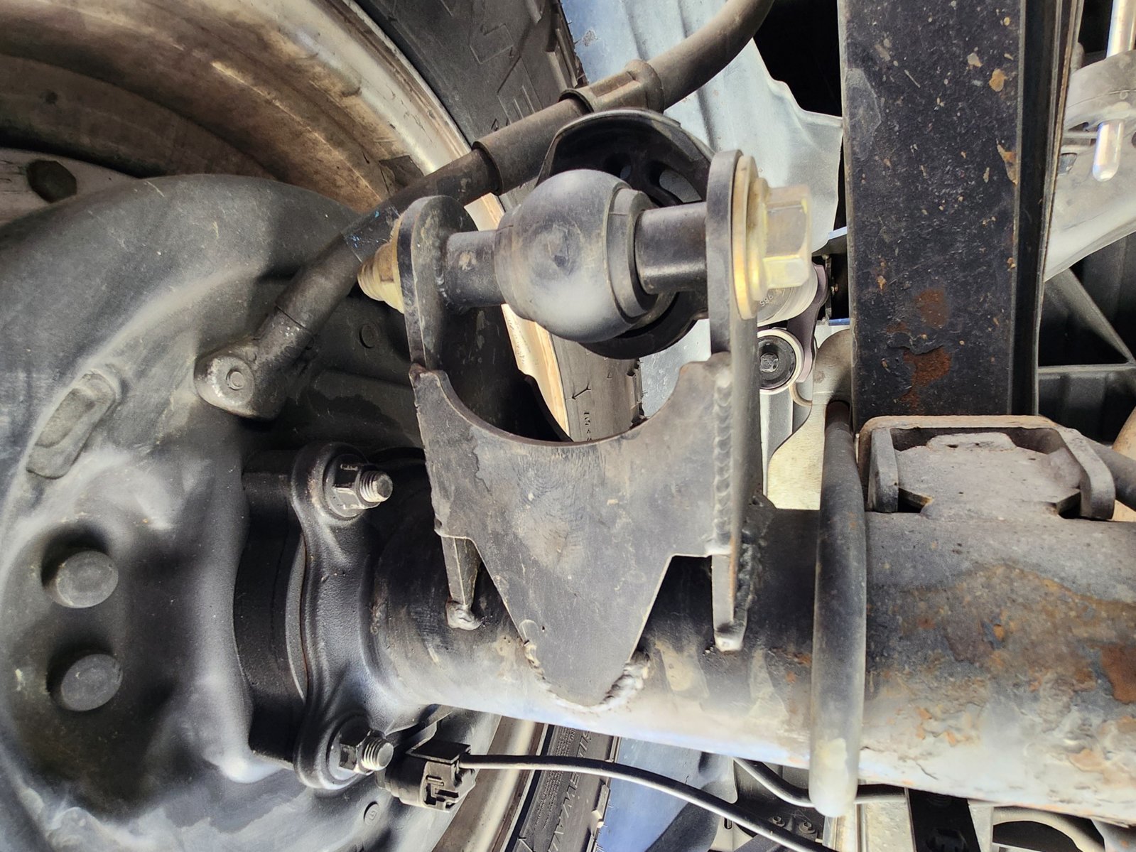

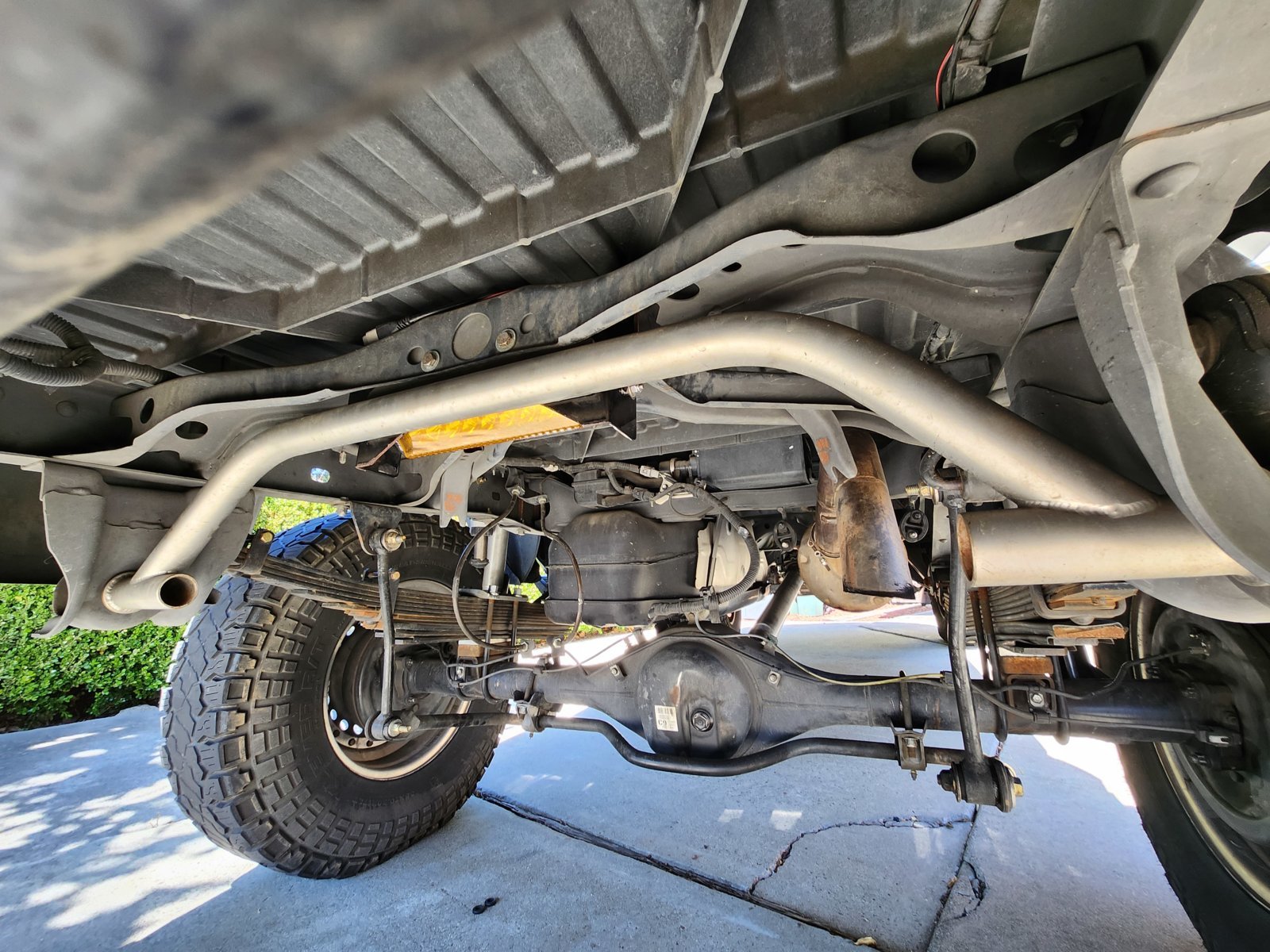

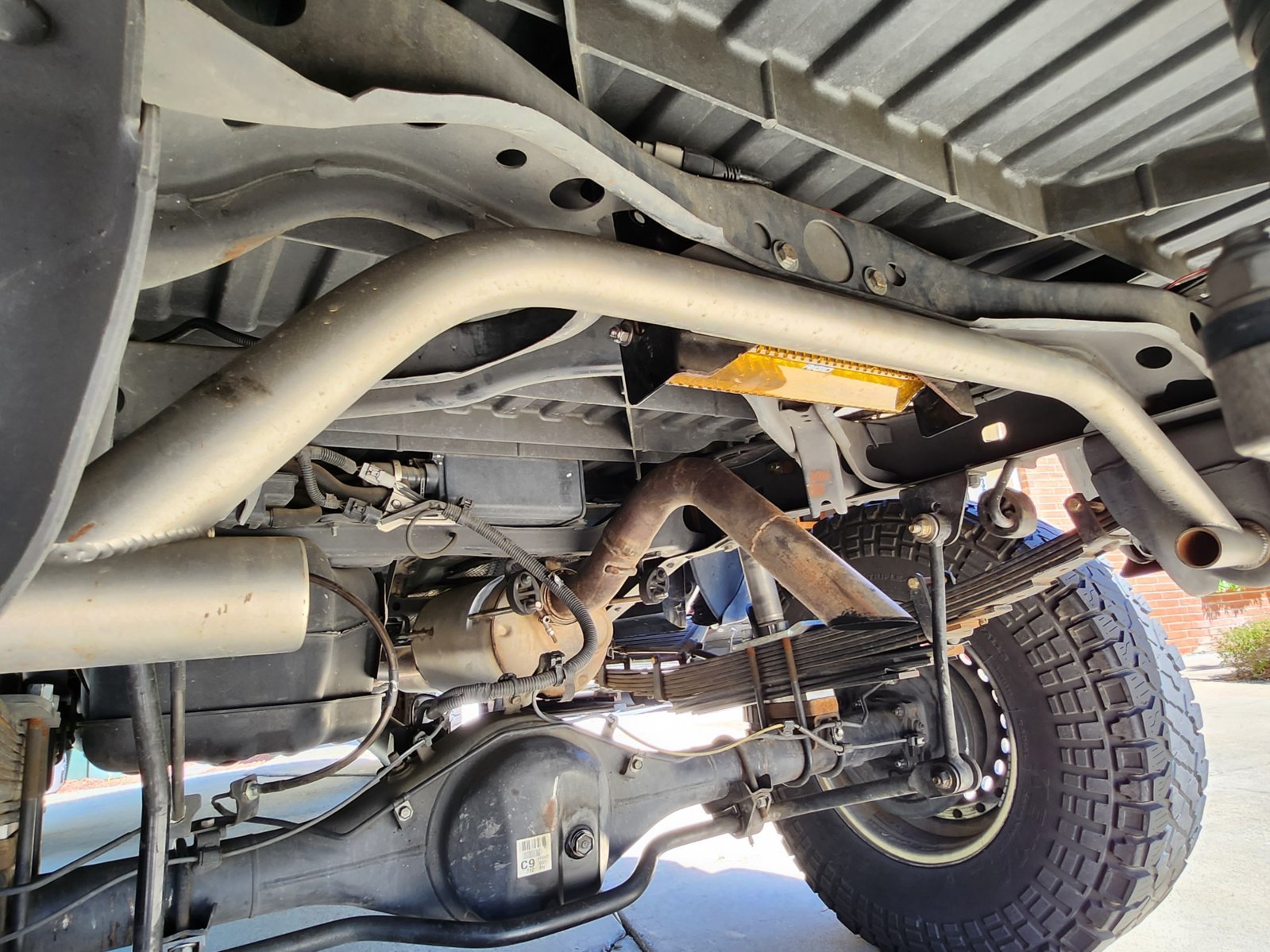

    There was an early player in the small biz custom Tacoma suspension game that isn't around anymore. I bought a couple of their items when he was liquidating because they looked extremely well made, etc. Here's the rear lower shock mount and the shackle hanger cross-brace from Defined Engineering.
    Most of the aftermarket crossbraces are paired with the beefier shackle hangers from the same manufacturer. (Eg. BAMF, Archive, TacomaPro, DRT, etc) Since I don't think I'll ever be joining the aftermarket shackle hanger club, the Defined Engineering brace was the perfect choice since it was designed to be used with the stock shackle hangers. Currently, I don't think anybody sells a bolt on X-brace that joins the factory hangers.

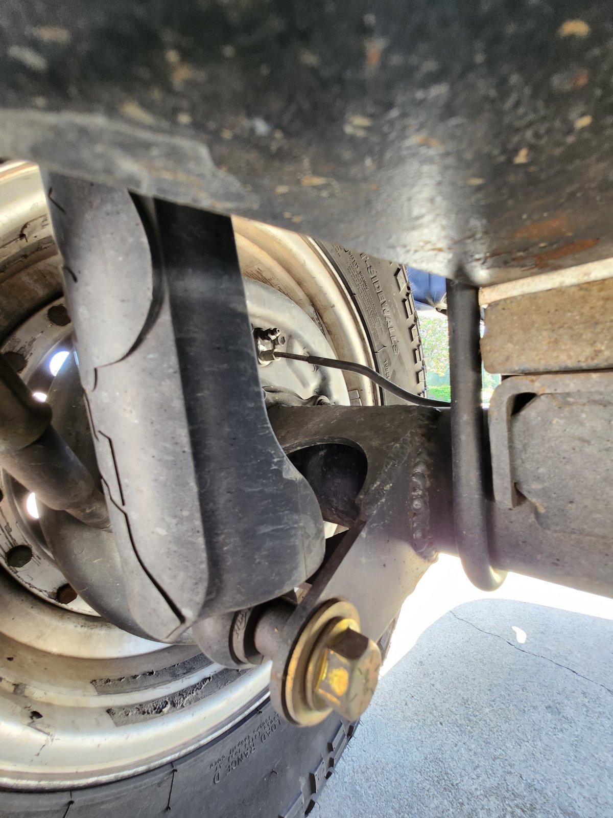

    Mileage: #120829

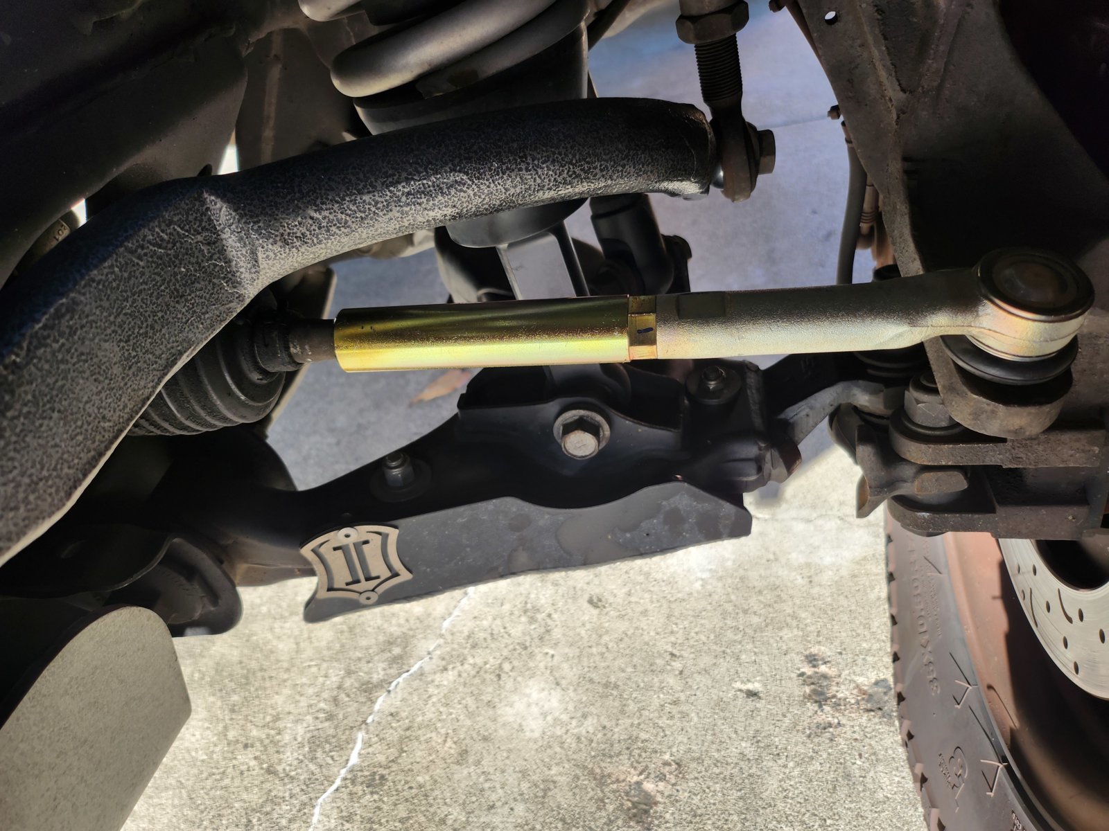

    Installed my Dialed Designs Toyota Tie Rod sleeves along with new genuine Toyota tie rod ends. Hardest part of the install is remembering that the driver-side jam nut spins to the rear of the truck to loosen. And the passenger-side jam nut spins to the front of the truck to loosen. Even though I tried to be very precise, I need to get it realigned now.

    Ah the ol' lefty tightey. Always catches a guy when he's trying to loosen stuff.
    All that suspension hardware looks top notch :thumbsup:

    Thanks Russ! Yeah, the good ol lefty tightey, righty good god almighty was very demasculinating as I couldn't get it loosen in either direction. A couple youtube videos confirmed the direction I should be cranking and it finally broke loose.
